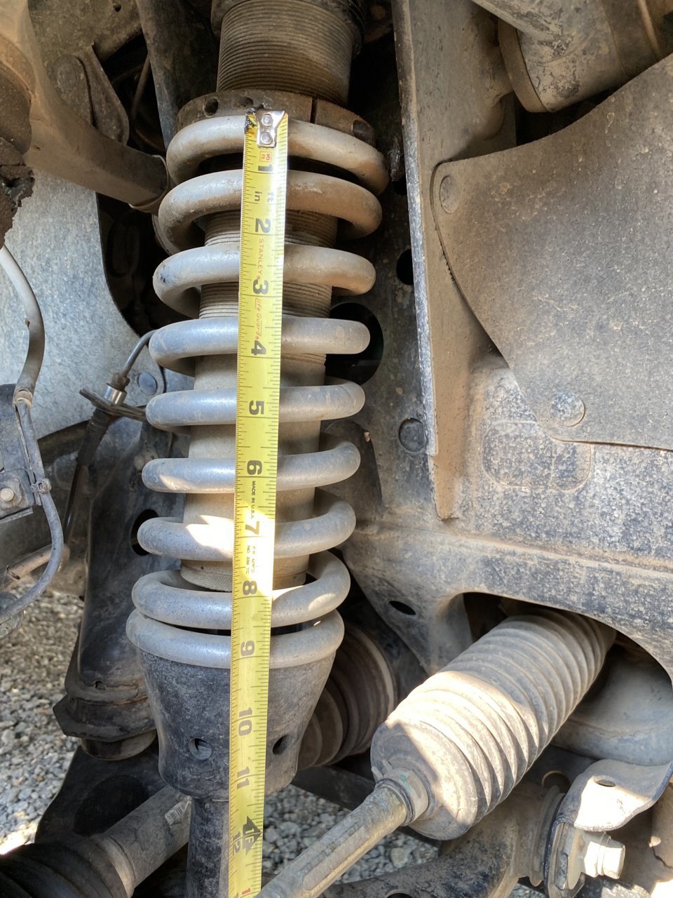

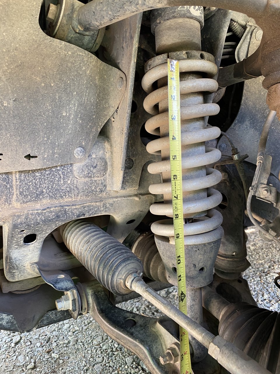

    2.5 ext travel coilover (883-02-025) is measuring a bit less than 20.5" from tophat to center of eyelet with the factory spring. Currently running the OE FOX coil and haven't adjusted the preload. The spring collar is threaded down about 2" from the top of the coilover.
    I'm running full skids, bolt on sliders with fill plates, a light (70ish lb) front bumper, a winch, a rear HC bumper with a swingout, and 2 spares. 2nd battery is located in the bed and I have the stock size 27f up front.
    Should I go with a taller spring and/or stiffer spring or just crank the preload until I get to 21" shock length?

    Whats the length of the spring at ride height?
    https://accutuneoffroad.com/preload-adjustments-on-oem-fit-coilovers/

  6. Aug 13, 2021 at 9:49 AM

    Drivers side
    Passenger side

    Ok, I screwed up my math/info a bit, sorry about that. I also deleted the post above so there is no wrong info is not on this thread.
    I'll need to know spring length at FULL DROOP (not ride height). That number subtracted from 13" will give you your preload amount. If its around 2" you should be ok, if its a little more you may want to consider a 14" x 600lb

    I'm at 11.25" on the drivers side coil at full droop. Sounds like I'm in the ballpark for where it should be, even with the extra weight.

    Awesome, that was quick. Yes you should be good on spring rate and can adjust the preload nut to get you to that 21" mark.
