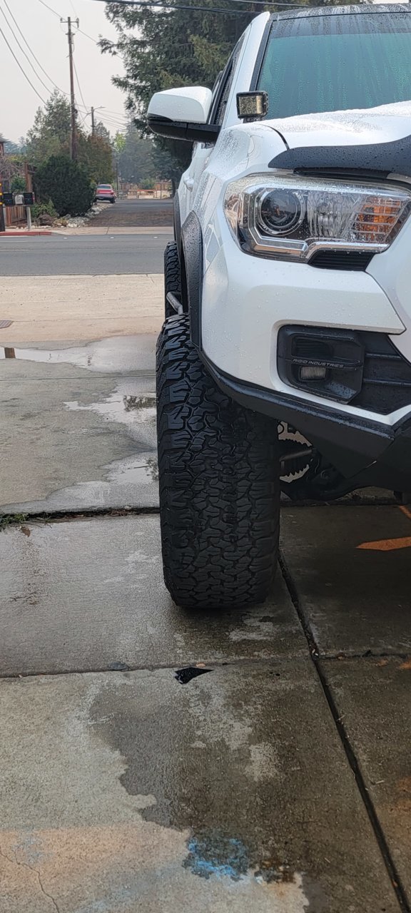

    Is there anyway to relocate the front shock reservoir? Without spacers my tires rub them hard. Trying to fix this so I can ditch the spacers 20210804_132653.jpg

    I mean there is always a way, just a matter of money and patients to figure out the best option. Any reason in particular you are wanting to ditch the spacers so badly? For what you have, I think the spacers are the cheapest and easiest option.

    Just to get rid of some on my scrub radius and tire poke. Currently the tire sticks out around 2 inches outside the fender. 20210806_172234.jpg

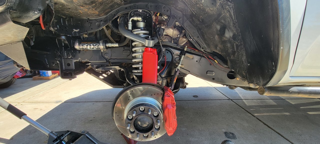

    Fox 2.5” Extended Travel Coilovers w/RR Eibach 14” 600lb Coils Spc UCAs Fox 2.0 Performance Series 12.1” Smooth Body Shocks w/RR Tuned By Accutune Archive Garage 2.0 Trail Series Shock Relocation Towers Archive Garage U-Bolt Flip Kit w/Superbumps Icon RXT set at stage 2 Headstrong Offroad Extended Brake lines Stoptec slotted rotors Spidertrax 1.25 spacers all around American Racing Baja AR172 17x8 zero offset 285/70/17 Ko2s Custom “swing gate” tire carrier DIY parts from RuffStuff Specialties Baja designs squadron Pros Roof and hood black matte wrap TRD pro grill
    Recently Installed with my buddy: Fox 2.5” Extended Travel Coilovers w/RR (880-02-418), Eibach 14” 600lb Coils, Fox 2.0 Performance Series 12.1” Smooth Body Shocks w/RR (985-24-054) Tuned By Accutune, Archive Garage 2.0 Trail Series Shock Relocation Towers, Archive Garage U-Bolt Flip Kit w/Superbumps, Icon RXT set at stage 2, and Headstrong Offroad Extended Brake lines. Was a 2-day project but we had fun. So far so good. It’s my daily and the ride is absolutely amazing (came from 5100s on Toytec 521600 2.5” coils and aal in the rear). Did some minor wheeling and the flex is amazing. Nothing wild but damn what an upgrade. 2E0F4897-4BE1-4A4E-8EC9-1970C127406F.jpg
