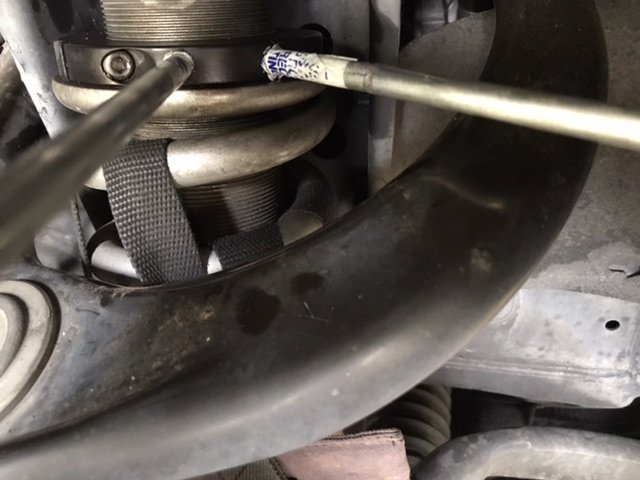

    @wi_taco one more question do I just loosen the lock screw on the collar one full turn before adjusting?

    Full disclosure: I don't have my Fox shocks yet so I can't tell you from real-world experience. Take that for what you will.
    See this article on AccuTune's site for a synopsis:
    https://accutuneoffroad.com/oem-front-coilover-shock-setup/

    I turned the lock screw to expose maybe 1/8" of threads. Don't need much. That article previously linked has a good breakdown of the steps.
    Those Harbor Frieght punches are the ones. I like them way more than the spanner, even if I could use it. Good arm workout.

    So I should just loosen it slightly?

    Yes. Only a few turns. If it is still difficult to rotate the collar (and you've already applied PB Blaster or equivalent) then loosen it another turn. The danger is if you loosen it too much then the collar can jump threads which can damage them, your truck, or you in extreme cases.

    As someone on here had suggested, I simply purchased a 5/16” steel rod from Home Depot (no Harbor Freight in HI) and cut it to size.
    Inexpensive and worked great.
    Edit for link: https://www.homedepot.com/p/Everbilt-5-16-in-x-12-in-Stainless-Steel-Threaded-Rod-800787/204604790
    IIRC I think it was like three turns for me.
    Jimmy92870[QUOTED] likes this.

    I ended up doing a full rotation and it was enough I kept applying PB blaster after every full turn of the collar worked great. Only gripe I have is that the 5/16 punch wouldn't fit on the passenger coilover so I ended up using the quarter inch one it was slightly lose but it turned so I guess it is what it is lol.

    Interesting that the 5/16 punch didn't fit on both sides. I don't have that issue.

    I tried it once I was done but I had to tap it in and then I couldn't remove it so i ended up spraying pb blaster on it and spinning it back and forth with a vise grip until I could pull it out lol.

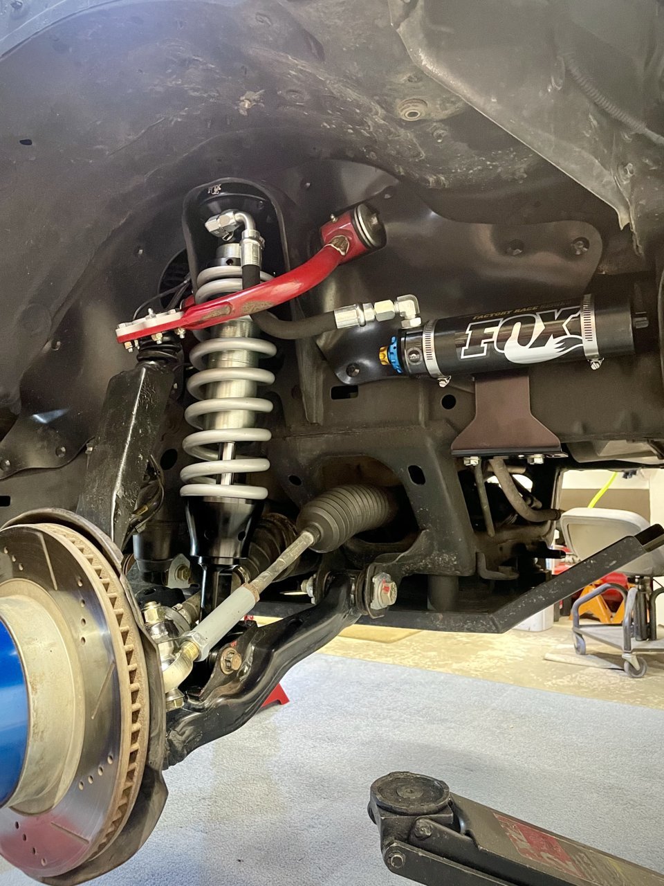

    Got my 2.5 extended coilovers on. The ride is absolutely amazing. Still playing with the high and low speed compression but it’s a fun process for sure.

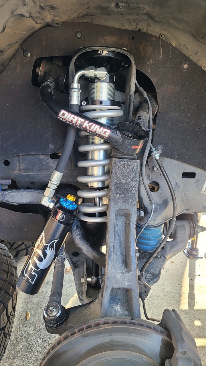

    Finally got mine installed and there's definitely a ride difference I'm comfort. I had a he'll of a time mounting the reservoirs though had to use zip ties to hold it close enough and some zip ties to maneuver the hose so I could tighten the hose clamps on.
    (Resis weren't mounted yet)
