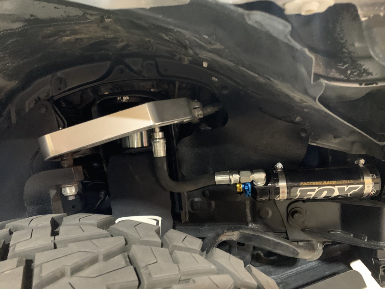

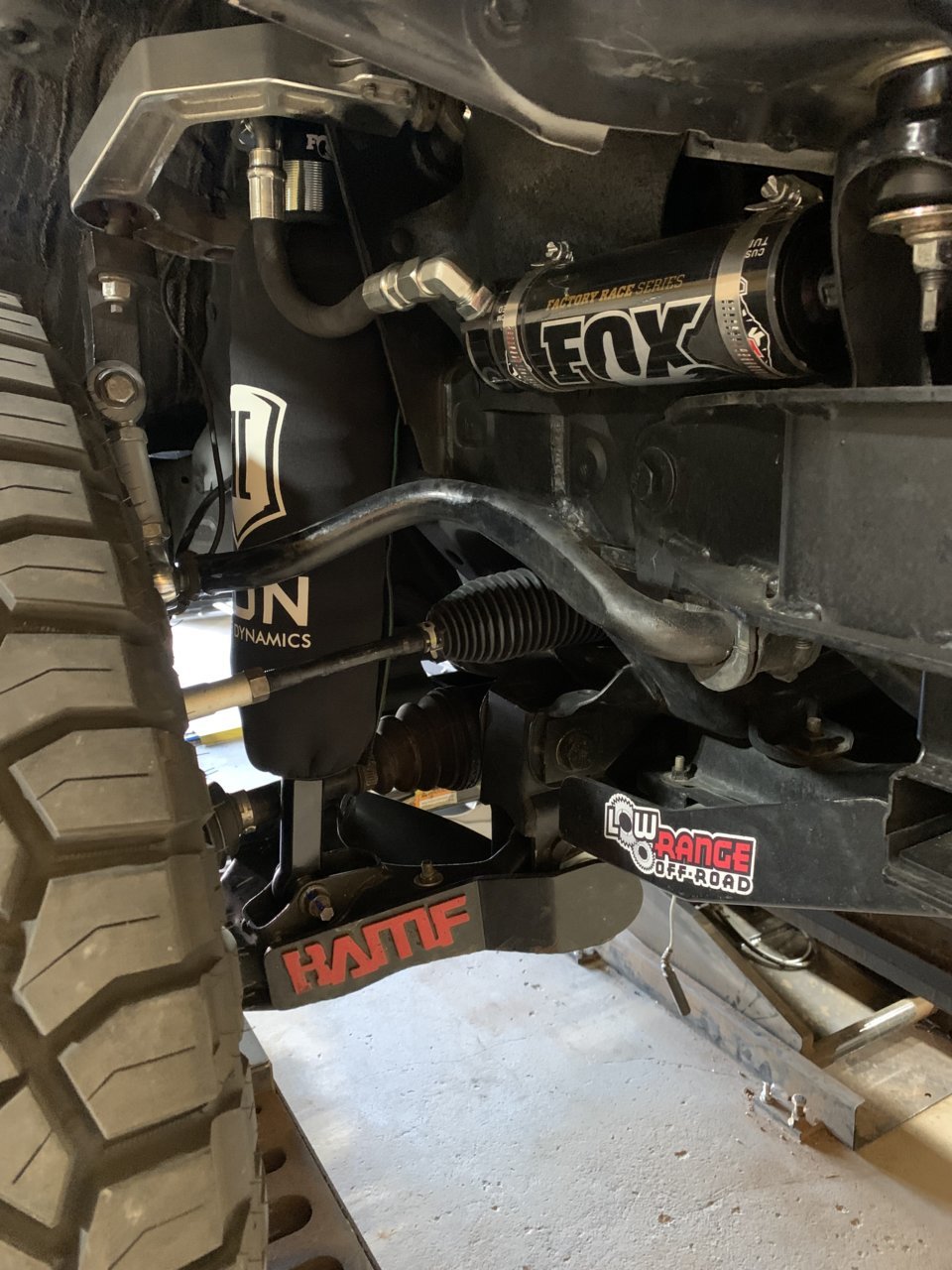

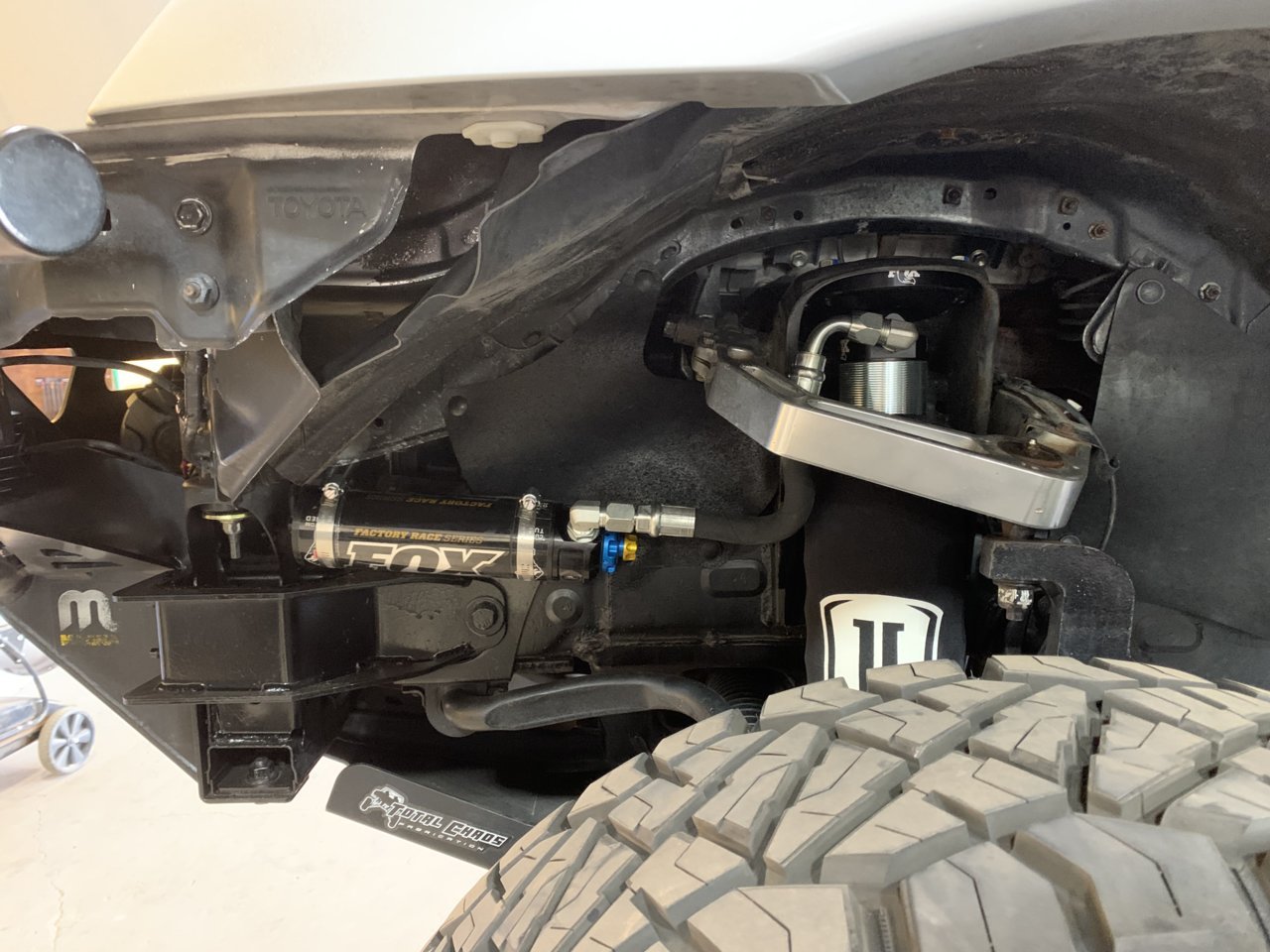

    Spent the day at 806 desert customs Off-road in Lubbock Texas. Outstanding team, installed and dialed in my Accutune built, valved, and custom tuned Fox 2.5 Coilovers w/DSC and eibach 700lb coils.
    this completes my suspension overhaul - the truck has never handled better.
    I cannot recommend enough Accutune, Alcan Springs, Archive Garage, ES suspension products to name a few.
    Thank you to all on here that provided guidance, moral and immoral support.
    6C0CD77F-E1A4-4ADA-8EBE-05DA2378007B.jpg F23B634C-C8DC-4470-AD01-8C7C9D345901.jpg 45375E68-5007-433E-A190-12BABE93DE80.jpg
