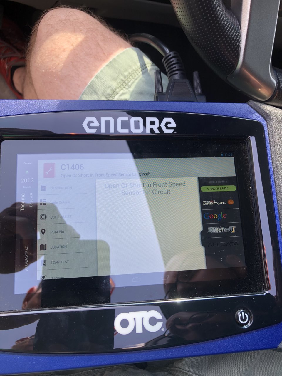

  4. May 12, 2018 at 9:26 AM
    #324
    cdex8357
    cdex8357 “Everybody gotta die sometime”
    Apr 7, 2018
    #249677
    1,004
    “Dex”
    H-Town
    2013 Taco OR
    Mid travel FOX 2.5 Coilovers FOX 2.5 secondary bypass FOX 12” Triple Bypass
    4wheelparts says sensor was on when I dropped it off, which is wrong, we all know out trucks. I’m not getting into a argument with them over it, just shows the integrity of the shop or the person doing the work.
    One of the guys up front hooked it up to a computer and I get the following code.
    C1406 open or short front driver side sensor.
    Anyone know if the recalibration will fix it?
    Clearing the code will not work, it’s comes one at start up. Disconnecting battery terminal did not work.
  5. May 12, 2018 at 10:51 AM
    #325
    cmbondo
    cmbondo Well-Known Member
    Feb 2, 2014
    #122060
    564
    San Diego CA
    2021 Cement DCSB TRD Offroad
    FOX 2.5 DSC and some other stuff too.
    Don't think recal will fix it. Sounds like the sensor is broke. Likely they put too much tension on the wire during install. Do a close inspection to see if you can find where.
  6. May 12, 2018 at 10:58 AM
    #326
    cdex8357
    Apr 7, 2018
    #249677
    1,004
    “Dex”
    H-Town
    2013 Taco OR
    @cmbondo im gonna disconnect it and hook it up to a volt meter to check the wire and inspect it..
    I’m sure this is what happened. They don’t want to take responsibility for the damages and make the repair.
    Recal did it twice nothing.
    And I have no ABS. Tested it in a parking lot and I’m sure Traction Control is not working. I have two little girls and I’m not putting them in this truck til it’s repaired.
  7. May 12, 2018 at 11:02 AM
    #327
    cmbondo
    Feb 2, 2014
    #122060
    564
    San Diego CA
    Sounds like you are all over it. At least you know which side you are dealing with.
