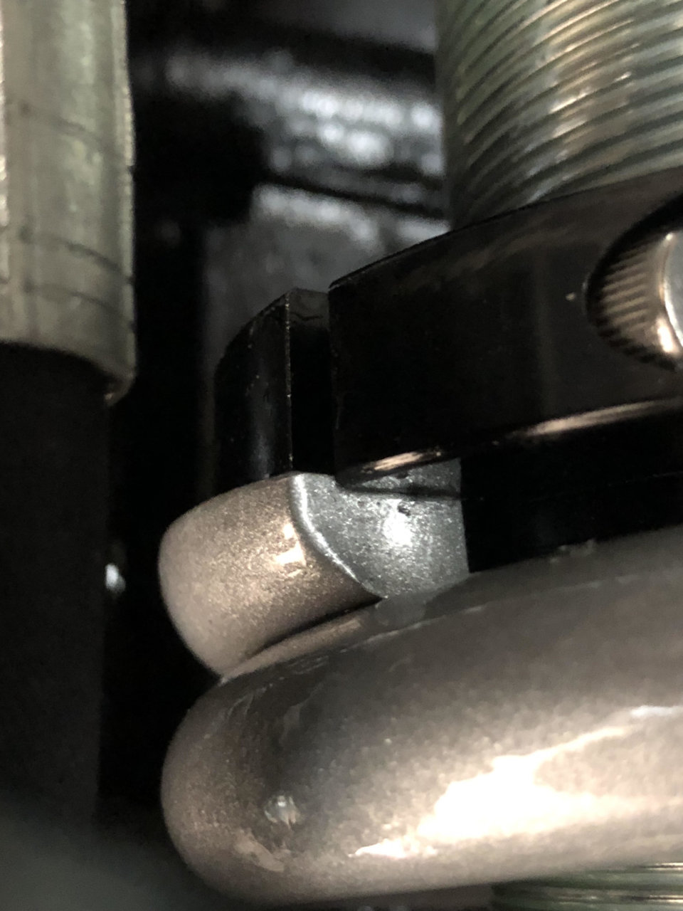

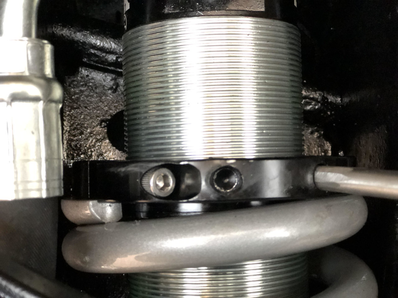

    Has anyone had this happen? The adjustment ring is caught on the spring and is making it extremely hard to turn (I stripped one hole with a 5/16 punch cranking so hard). The catch is causing the spring to completely spin with every turn.

    Yes, I have. I think what I ended up doing was turning the collar away while trying to hold the spring in place so it wouldn't rotate, that way I could build separation, if that makes sense. The safest way is to compress the spring and rotate the collar.

    Kind of makes sense. How were you holding it in place?

    My hand. I had to loosen the collar a bit to back that lip off enough. I think I gave the collar some firm tugs (so to speak) to help build distance.

    I'm kind of freaked out on how much I can loosen that collar before the spring shoots through the roof

    Sorry, I used the wrong term. I meant rotate the collar itself in the opposite direction. The collar just needs to be loose enough to spin, which it sounds like you've already done.

    Decided to just risk it for the biscuit and gave it a few more full turns to compensate for the lean. I should be happy with 2.5 inches of lift. Will have to compress them to go any further as you suggested (and Fox) to be on the safe side. Thanks, Gonzo.
