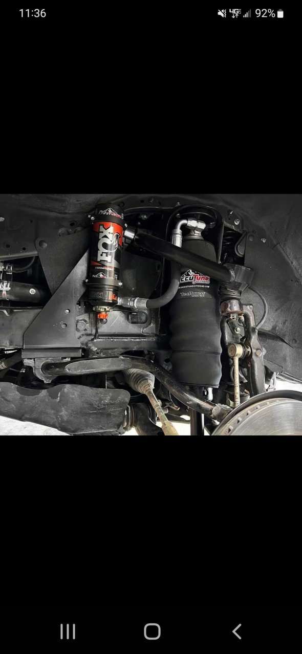

    Installed my FOX PES 2.5 front and rear yesterday. I compressed the coils just fine at home with the SPC kit and adjusted the collar by hand.
    I'm protecting all of the installed parts, so not the most glorious picture with the Fox decals. Thank you @AccuTune Offroad for all of your help!
