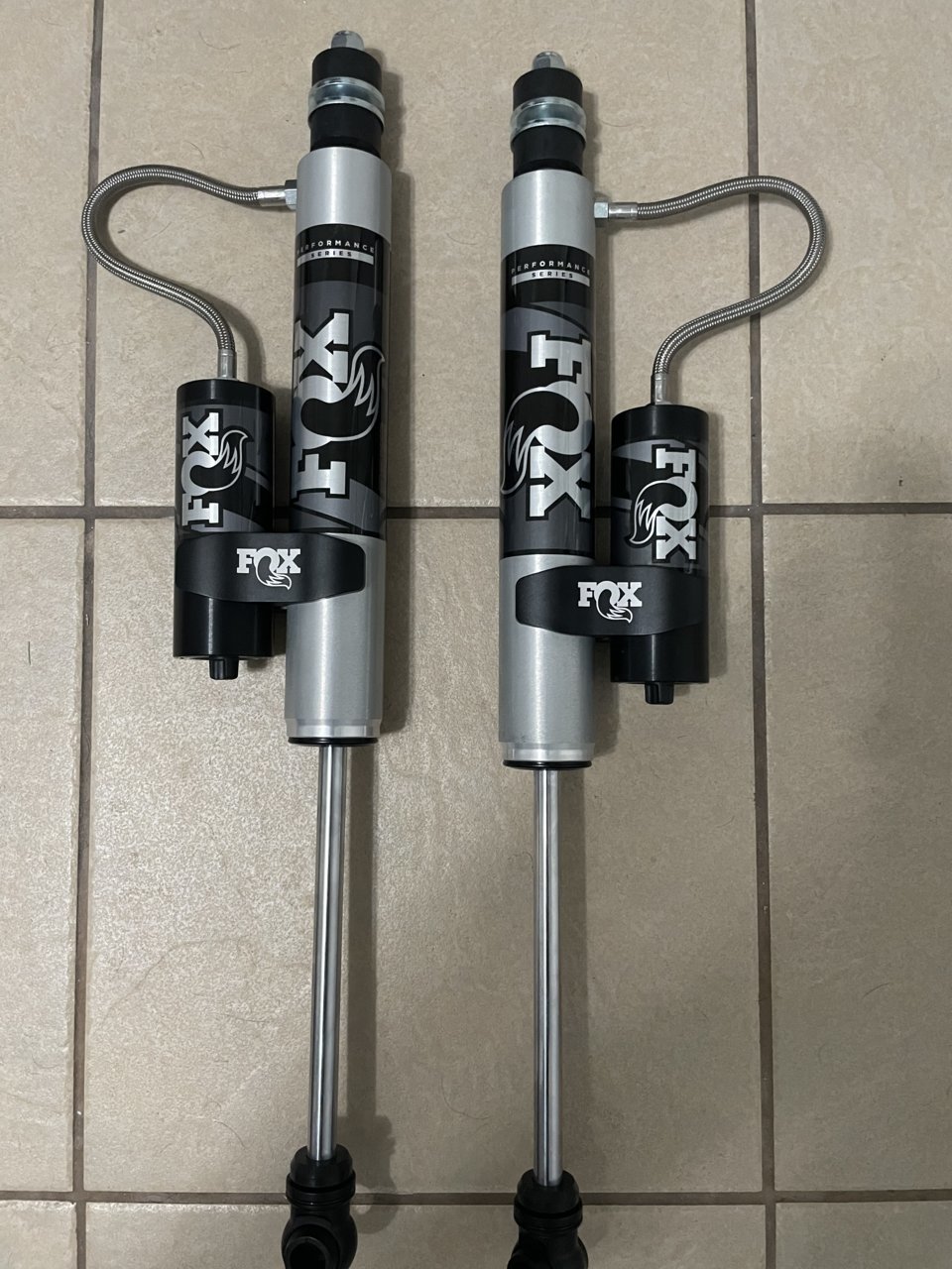

    Very exciting day today! Anybody know if I can mount the reservoir from the 2.0 shocks to the frame as opposed to me piggybacking it?

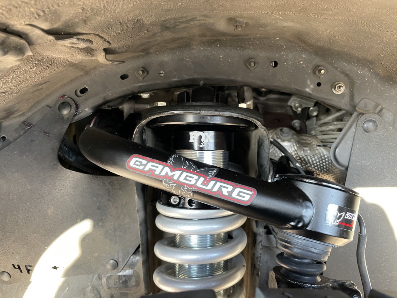

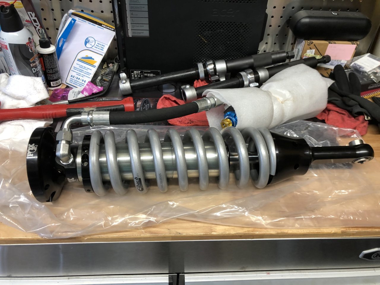

    Installed my front UCA’s and coilovers yesterday and got an alignment this morning!
    Planning to do the rears tomorrow and setting these up to pop in. Does the reservoir mounting look okay? FAD74EE7-7224-4D2D-955B-DA33F8BEEB56.jpg

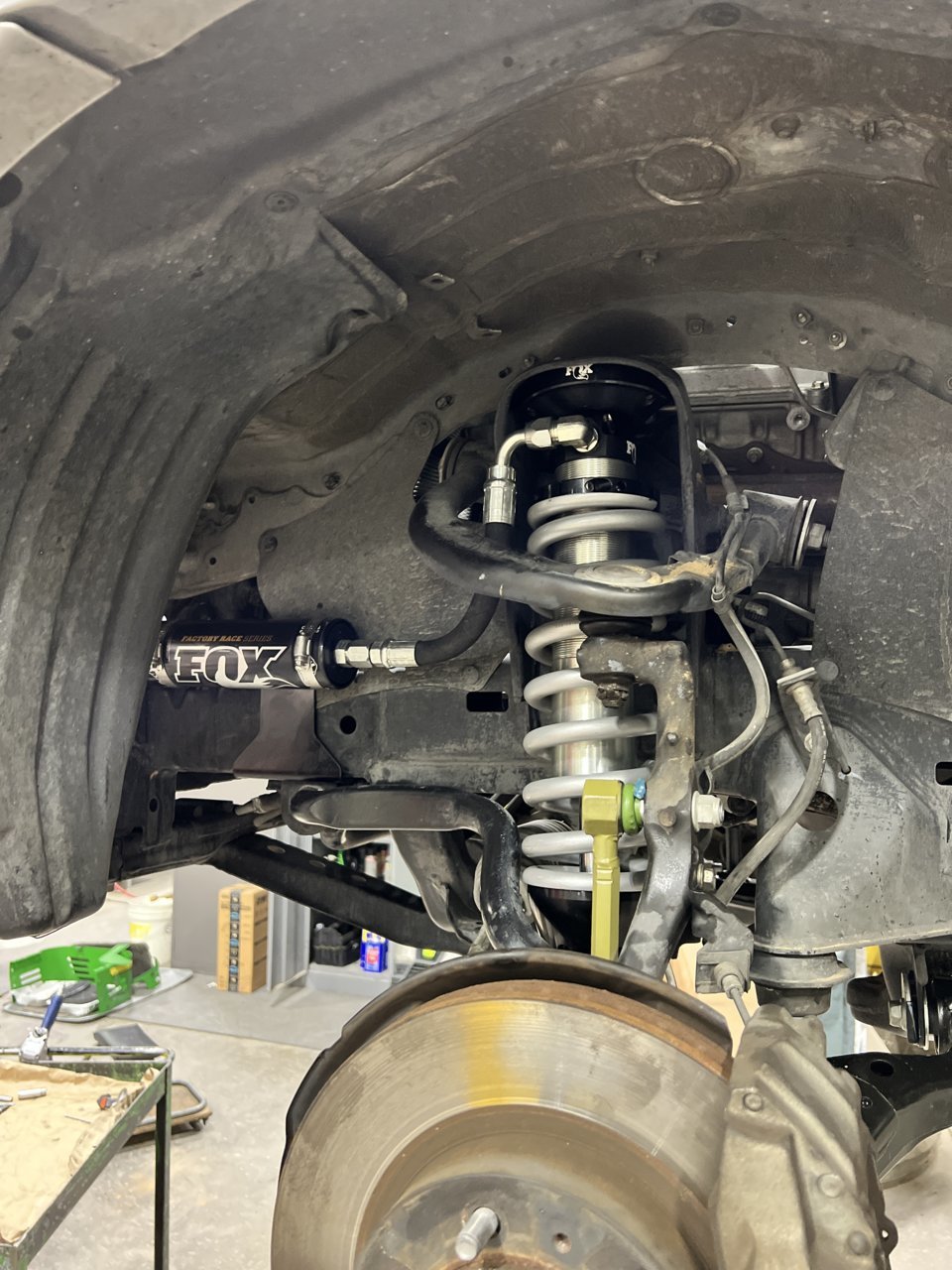

    Front is done!
