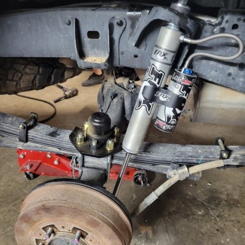

  9. May 25, 2022 at 5:55 PM
    #3489
    AugustaTaco
    AugustaTaco Well-Known Member
    May 22, 2015
    #155836
    3,941
    Josh
    Augusta, GA
    2015 DCSBXSPX4X4 2017 GX460
    "Getting out of hand" - Wife
    Thanks! I actually bought some fancy gold aluminum ones but they were too big. So these are the regular hose clamps with heat shrink tubing around the metal :thumbsup:
    Came from Camburg ball joint uca’s and the urethane bushings never stopped squeaking. Plus the ball joint design sucked and constantly leaked grease out of the boot (which they appear to have corrected). My deciding factor on the JD fab was the oem tundra bushings and sealed, greasable uniball (and being super beefy, they thicc). My front end is absolutely silent now! Granted I had creaks, squeaks and pops from other worn out stuff too lol

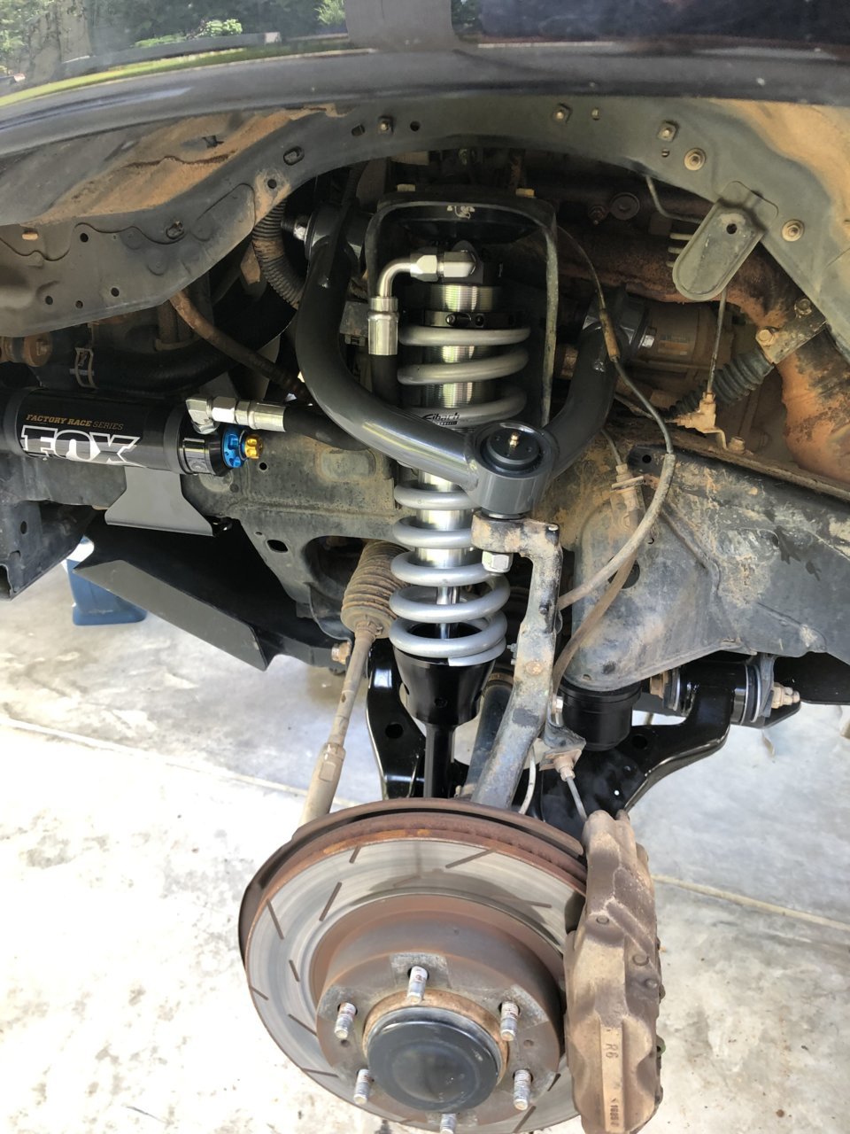

  15. May 26, 2022 at 9:54 PM
    #3495
    wi_taco
    wi_taco My skid plates give rocks taco flavored kisses
    Jul 20, 2020
    #335129
    4,117
    Adam
    SE Wisconsin
    2015 Toyota Sienna with rear locker
    Add me to the Fox Gang. Previously had Bilstein 6112/5160 and stock rear leafs. I ran into some issues that still need working out (like an unexpected frozen LCA bolt) so I can't give a full judgement yet. Also want it to "break in" for a bit and get the height settings right. Sorry I don't have a good photo from far away yet, partially intentional because my front coil heights are wonky (that's my fault though, math is hard). Shoutout to @AccuTune Offroad , @ARCHIVE , and @RockAuto where I sourced the parts.
    AccuTune - I'll be calling you next week to discuss a few things, nothing major just some feedback and minor questions about this new Performance Elite kit that might help future customers.
    Front
    FOX-883-06-178, Fox 2.5 Performance Elite Series Coilovers, 0-3″ Lift, DSC
    CMS861197, Mevotech (re-boxed SPC) Left upper control arm
    90105-A0095, Toyota Upper Control Arm Bolt (only needed because I'm cutting)
    CMS861196, Mevotech (re-boxed SPC) Right upper control arm
    Previously installed +1" extended brake lines not required but doesn't hurt
    Diablo 9 in. 8 TPI Steel Demon Carbide Reciprocating Saw Blade for Thick Metal Cutting ($15 at Home Depot)
    Rear
    FOX-883-26-113, Fox 2.5 Performance Elite Series, 2-3″ Lift, DSC
    DEV-U402-2, Deaver Expedition Series 2″ Lift Springs U402
    UBF-001, Archive Garage Stealth HD Toyota U-bolt flip kit with Option 3 bumps
    Previously installed 24" extended rear brake lines are needed

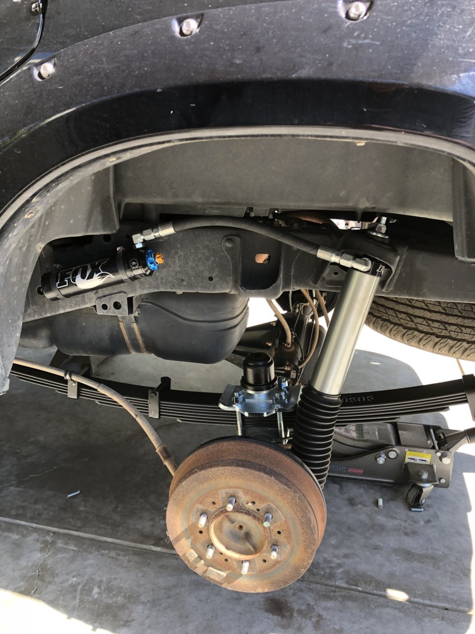

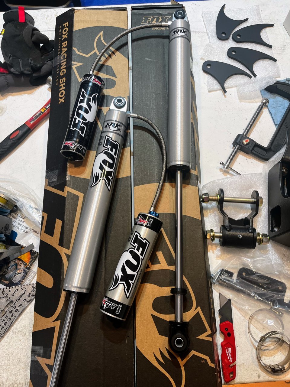

  17. May 28, 2022 at 1:41 PM
    #3497
    AugustaTaco
    May 22, 2015
    #155836
    3,941
    Josh
    Augusta, GA
    Rear done-ish (need to do the hammer hangers still)
    DE664BDE-CDA7-4A99-AF81-F5798AF47895.jpg A065E988-3DA0-46BA-A175-0CDF0852D76A.jpg

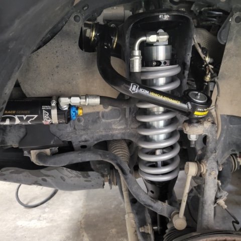

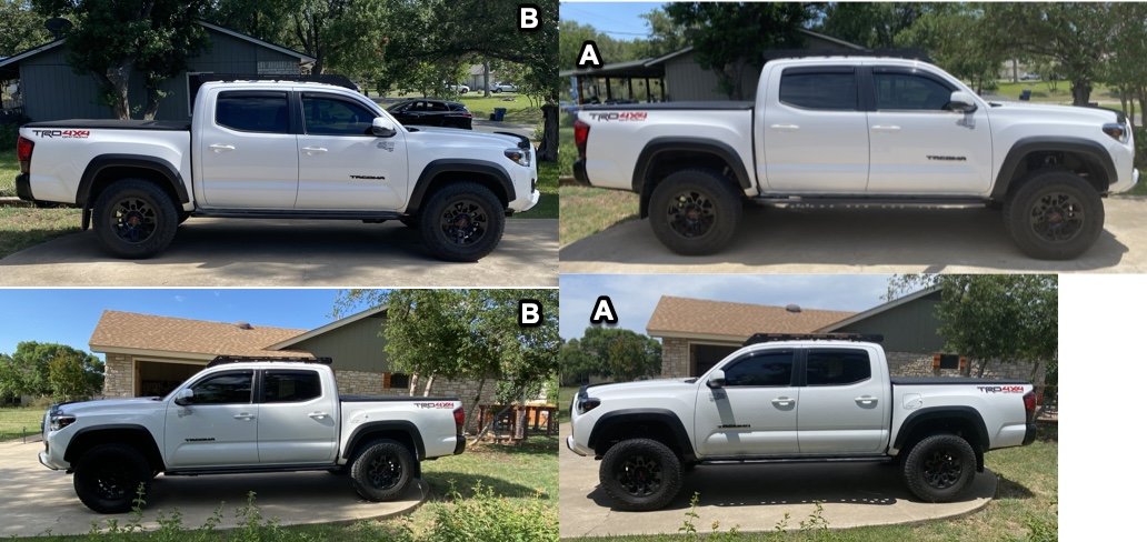

  19. Jun 10, 2022 at 4:34 PM
    #3499
    dleriche
    dleriche Wanee Warrior
    Feb 29, 2020
    #320735
    3,395
    D.J.
    Leander, TX
    2019 White ORD DCSB AT
    Not today, but last week. Thanks to AccuTune Offroad for the recommendations and tuning. Shout out to Texoma for the install and the conversation. Highly recommend his services if you're in the Austin, TX area.

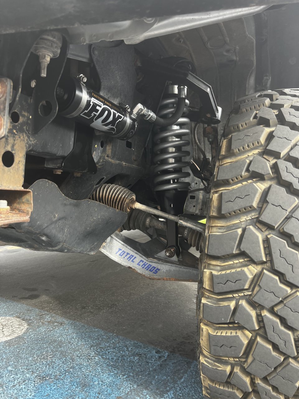

  20. Jun 10, 2022 at 4:57 PM
    #3500
    HIYota
    HIYota Well-Known Member
    Apr 12, 2011
    #54813
    2,558
    Angel
    Las Vegas, NV originally Kauai, HI
    09 Silver 6 spd TRD Sport DCSB 4x4
    Check my build thread...too much to list.
    So honest question being I just got Fox 2.5 w/DSC put on the truck. @AccuTune Offroad what do you guys change when it comes to tuning these being they’re already adjustable? Curious as I’m thinking ahead on rebuild since I go out pretty often. Oh and pic for relevance.
