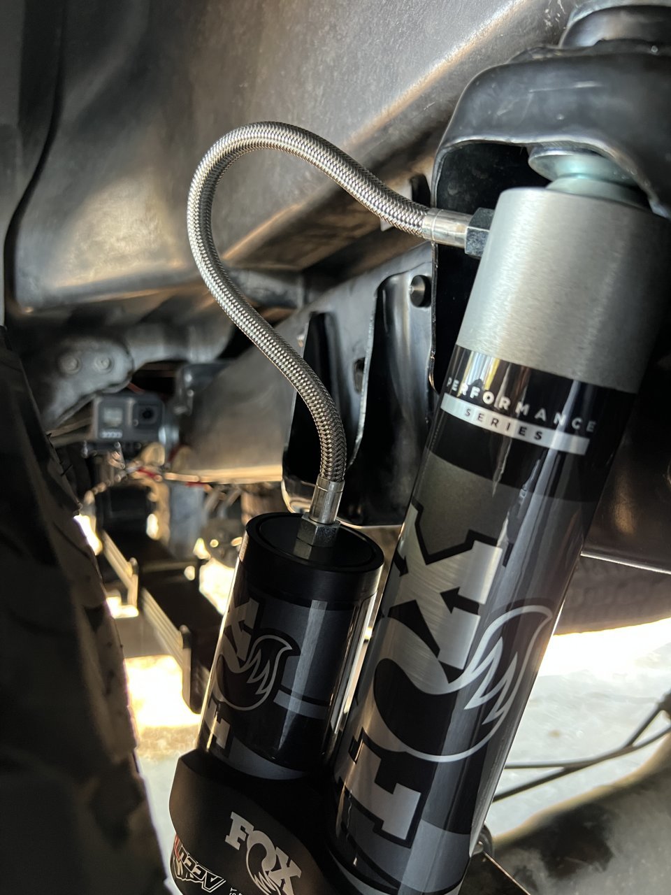

    Put the rear 2.0 w/resi’s from @Accutune in yesterday :D Still early, but on-road the tune feels great with the amount of weight I told them I’d be running.
    Really happy with the way the ride has improved now that the rear end is significantly more controlled.
    Also playing with a go-pro mount Ive made for the frame, helps me observe what’s going on down there while the suspension is at work, which is really new and neat for me. Watching the suspension cycle real time from the cab is really cool. Gopro is always tethered to the frame in case the HF magnet fails.

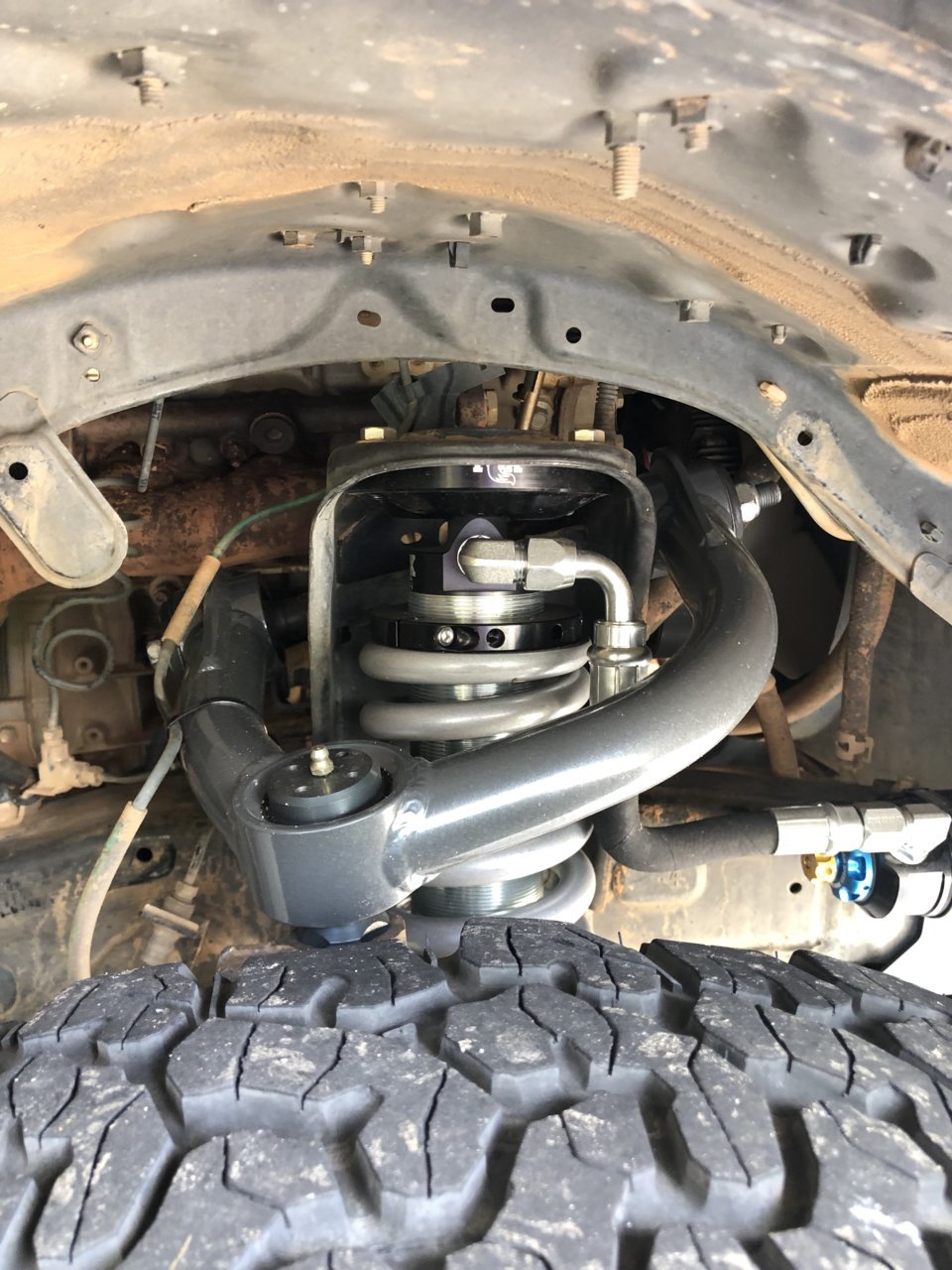

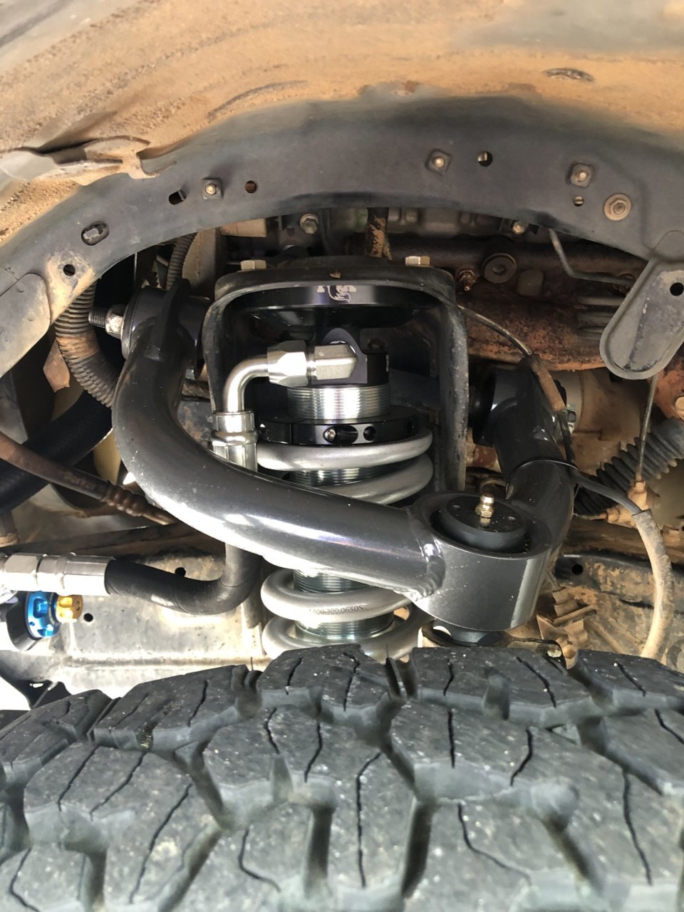

    Got about 500 miles on everything now so I think it’s all settled. I don’t want to toot my own horn here…but I’m gonna. I swapped to 14” 650lb coils and guesstimated the preload before install, and absolutely nailed it!! 2” rake front to back (which I want), and a 1/4” (f&r) drivers side lean with a full tank of gas :headbang:
    Oh, and both coil overs measure 21.25” with the weight of the truck, right where accutune recommends

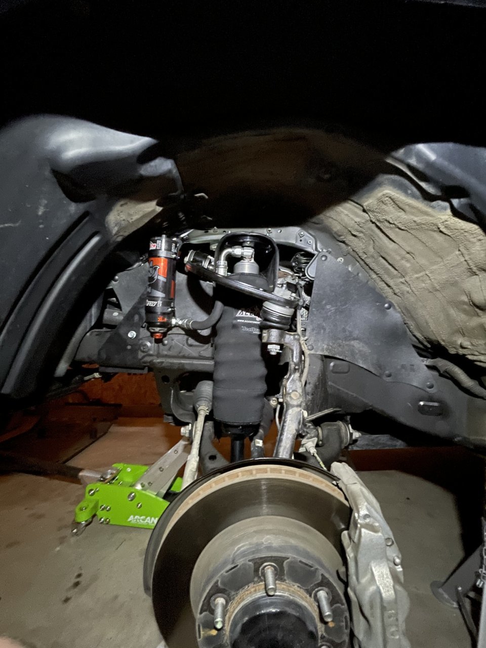

    Exhaust reroute RCI steel full skid plates (front, transfer case, transmission) Front camera (anytime backup camera) RCI rock sliders AC Drip mod OEM locking tailgate Brite box fogster anytime fogs Backwoods adventure mods hi-lite front bumper with Baja designs squadron pros ARB single OBA Fox 2.5 PES DSC 2-3” Wheelers superbumps + ubolt flip kit Deaver stage 1 u402 Cab mount chop+fender trim Rrw RR-7 -12 offset with 315/70r17 5.29 regear ARB front air locker Z precision big cupholder
    I’m halfway done with the front not really stock weight but more stock than some. It gave me 4” in one corner but it’ll get lower installing the other side and rear and front bumper. Still likely will be backing off preload. My PES came from @AccuTune Offroad though so it may not be in the stock position (stock springs tho)
    edit: my alignment was all jacked from not setting the SPC UCA right. After I fixed that it dropped ride height. I will update once I figure out where I’m riding it permanently but I’ll likely have to increase preload some to get back to 2-1/4”

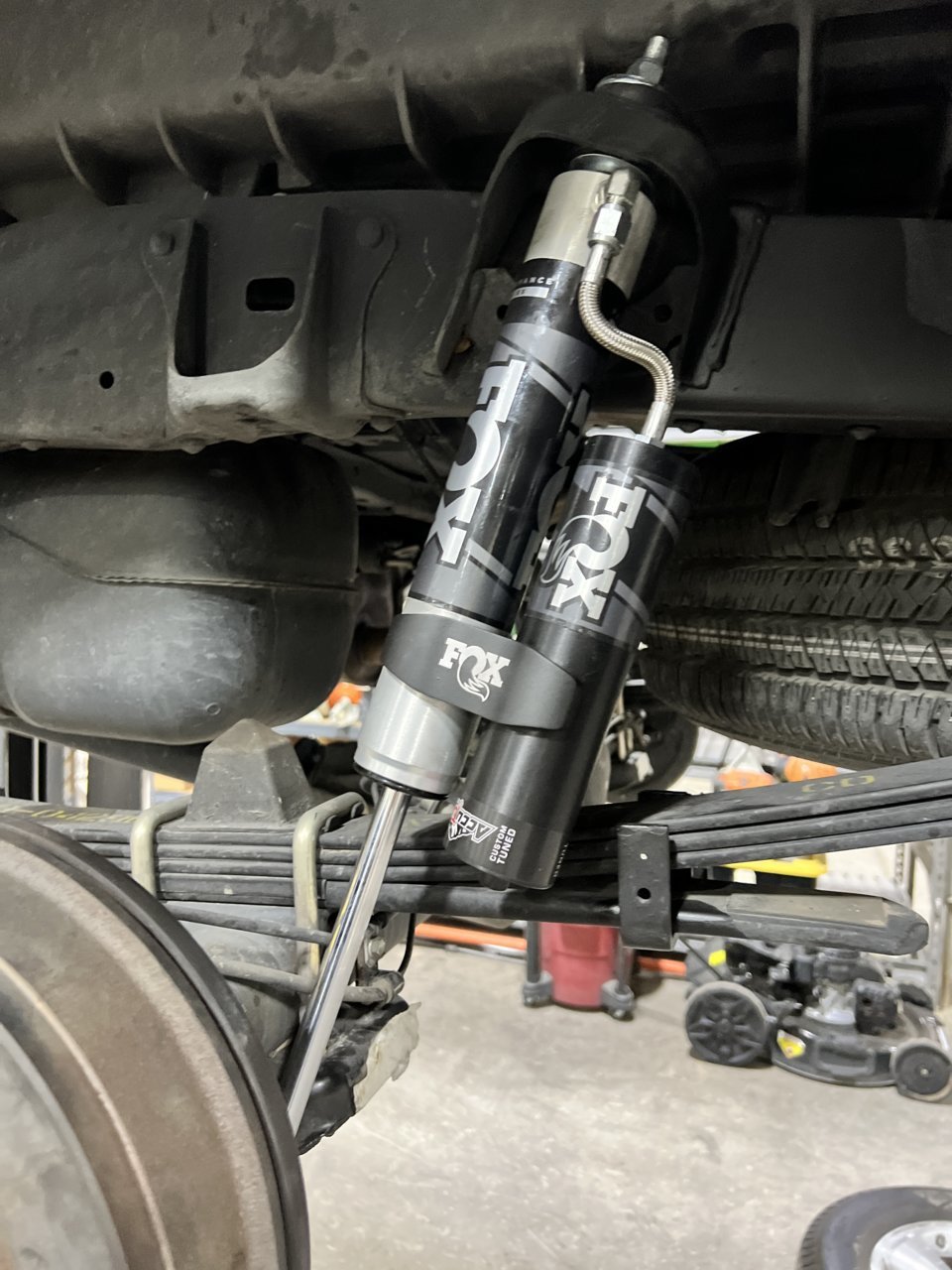

    Is anyone having rubbing issues on the left rear shock? Specifically the Resi hitting the leaf pack overload bracket as seen in the image. I noticed that under hard driving in the dirt it can hit it as I found out and have a nice scratch in the resi from it.
    I did loosen up the camp and rotate the resi out towards the tire but the whole thing can still rotate in towards the leaf pack.
