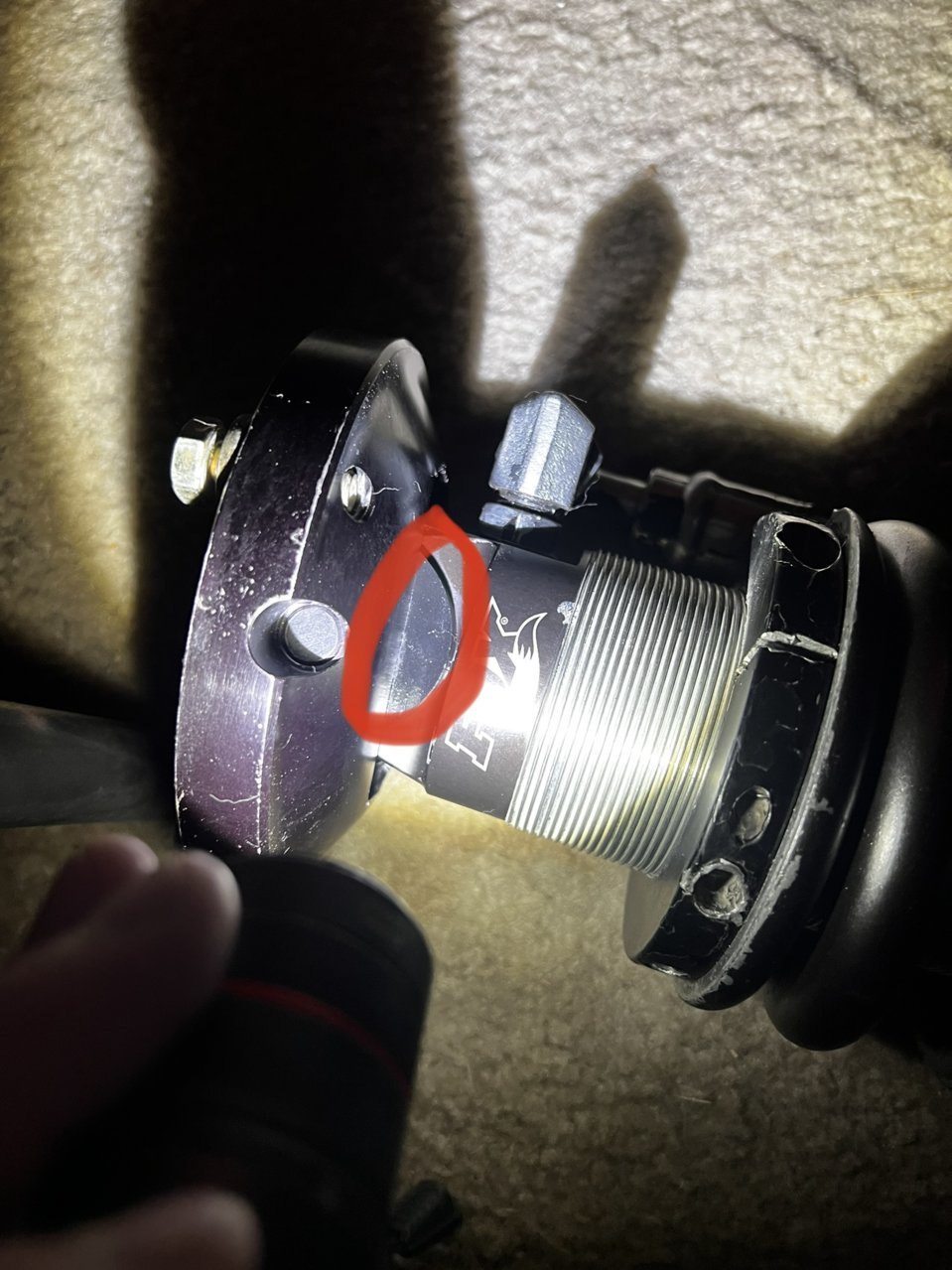

    Yes. I discovered a series of scratches on mine, mostly on the right side, I think. I mounted my reservoirs on the frame to alleviate the issue.

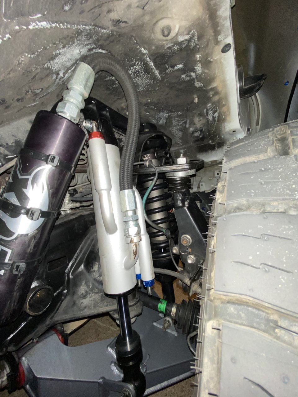

    Mid travel FOX 2.5 Coilovers FOX 2.5 secondary bypass FOX 12” Triple Bypass
    @AccuTune Offroad can I purchase the Fox Reservoir mounts from y’all?. The ones that mount in the position like kings.
    AccuTune Offroad likes this.

    I'm assuming you are talking about front coilover mounts? Probably best to go through Fox for that, we dont stock those.

    Yea.. I have a secondary bypass and don’t like where it mounts onto the secondary shock hoop. Tires rub on it. It has a large reservoir with multiple jic fittings.
    I wanted to know if y’all could put a shorter Resi on it. 161BE4DE-7CEF-4AD0-8ADE-22D2C28430F4.jpgback when I had it zip tied. It’s mounted now
    the resi is bigger than the shock body
