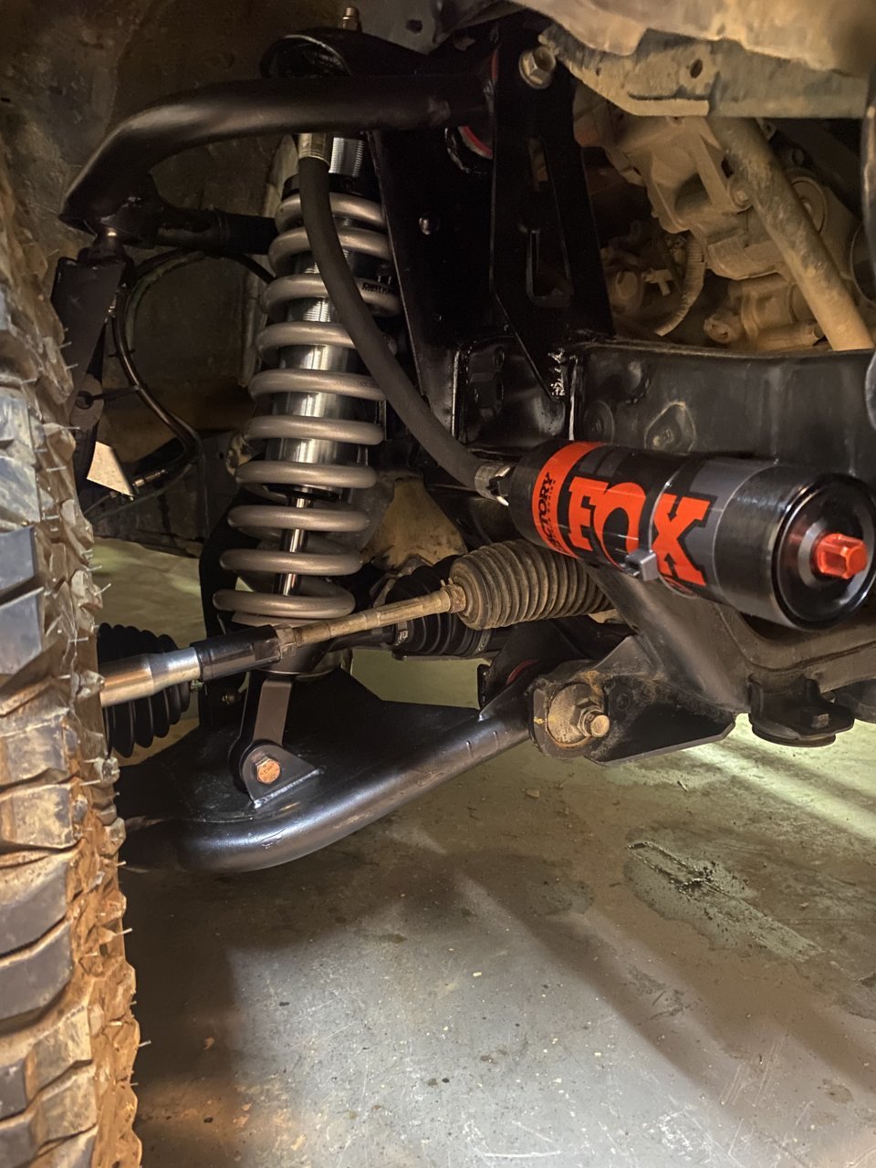

    Just finished up my long travel suspension. Here’s my fresh fox factory 8inch coilovers with 16inch springs. 44BCE577-25DE-4D89-A70E-174AB00B6E5B.jpg

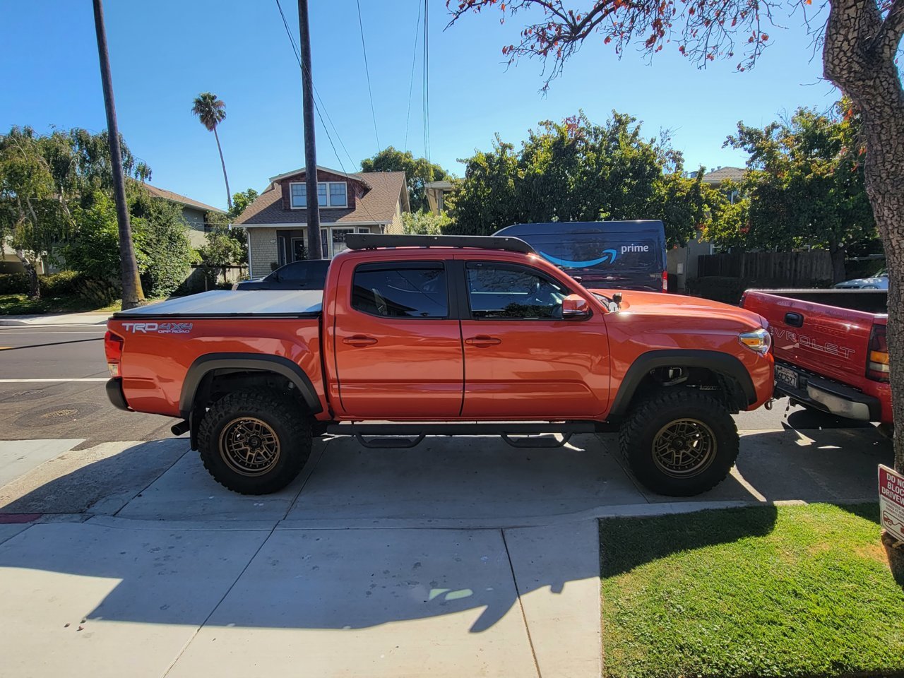

    Update on my setup. Just replaced some Elka 2.5s and went to the Fox PES extended travel, accutune bumpstop kit, and went to the icon stage 2 from the stage 1. Pretty happy with how everything turned out. Just running a bed cover right now and ride is perfect. Gained some lift as well in the front. Definitely recommended.
