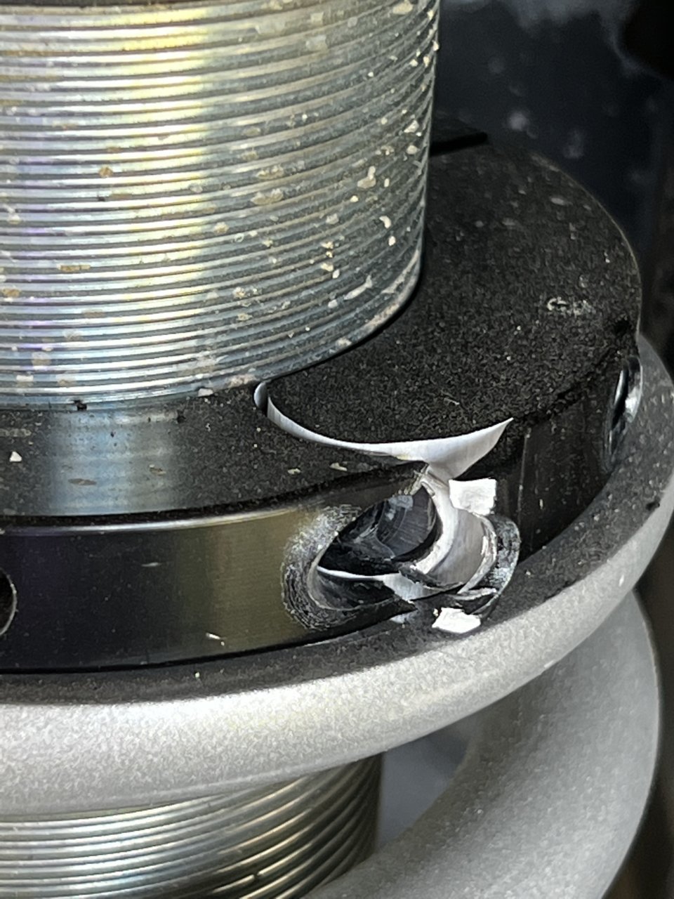

    Ouch, no bueno. Unfortunately this is one of the reasons we do not recommend adjusting preload with the coilovers installed on the vehicle. These are not easy to replace. That have to be threaded out/on the top of the shock body which requires the hose to be removed, which also requires the shock to be taken apart to be bled properly etc. Unless this is an IFP 2.5 coilover, without a reservoir?

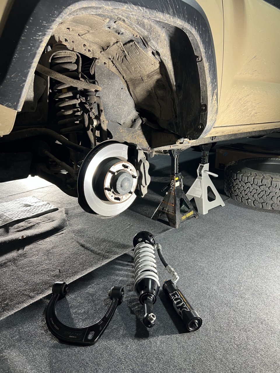

    DF35B620-6D2B-44BC-A621-46246EA30480.jpg I’m up early about to install Fox 2.5 DSC with remote reservoirs (standard 600 pound coilovers), SPC uppers, Tundra 2.5s in the rear tuned for the Tacoma, and Deaver stage 2 leaf springs.
    Other than my 100 pound Diamondback bed cover, I’m at stock weight. I’ll carry around 400-500 pounds of sand to make the leaf springs happy. I got the stage 2s because I intend to have added weight in the rear eventually. So I’m just planning ahead.
    The preload on both front shocks seem to be at 1.125”. Hope everything goes smoothly.

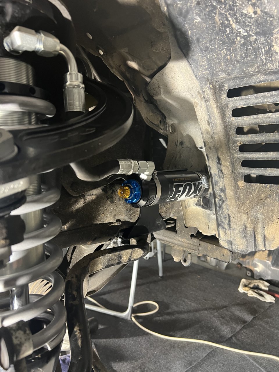

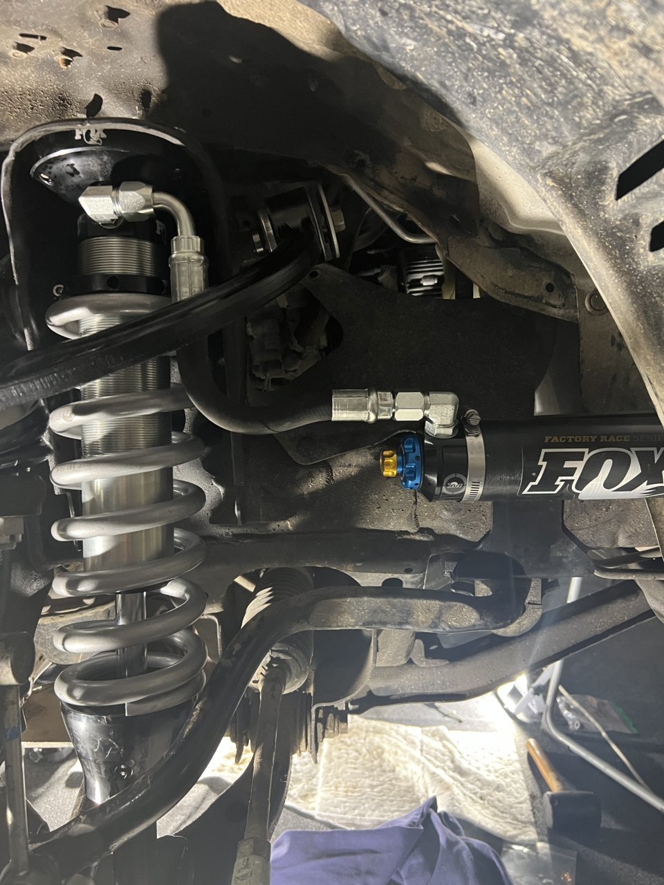

    855C2CBA-BCDA-4A4C-8520-375008EA5FAD.jpg 32FB8817-DF69-4036-8248-3903BF213024.jpg Do you guys have your reservoirs pushed up all the way to the front of the wheel well fender area? It feels like I could barely fit my reservoirs nicely on their brackets. The black knobs opposite end of the DSC knobs are touching the front. Is this ok?
