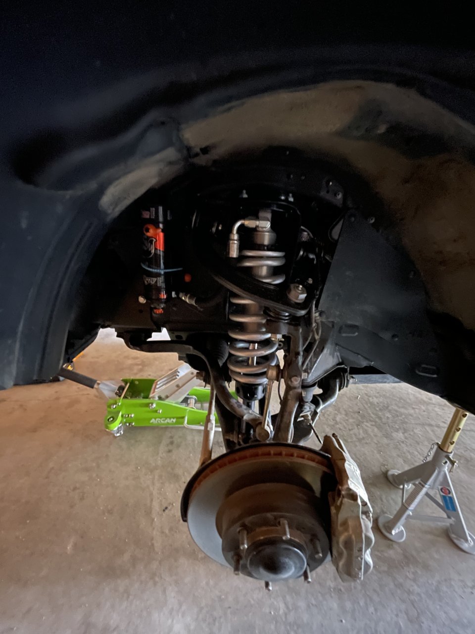

    I'd say you can cut that inner fender if need be I don't have the fender liner anymore 20220926_162522.jpg

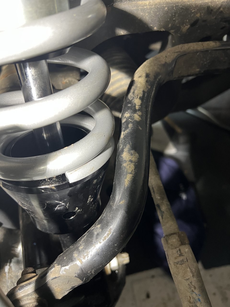

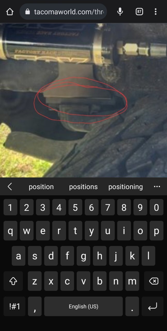

    Barely any clearance between sway bar and coilover on driver and passenger side with drop spacer installed. This can’t be right.

    You need the sway bar relocation brackets.. it changes the positionScreenshot_20221120_164807_Chrome.jpg

    I have the relocation installed in that picture I posted. I only have maybe 1/4 inch clearance. Idk if that’s enough. I guess I’ll see.

    Possibly installed backwards?

    Do you have the lower eyelet spacer installed? It should be facing the front off the vehicle

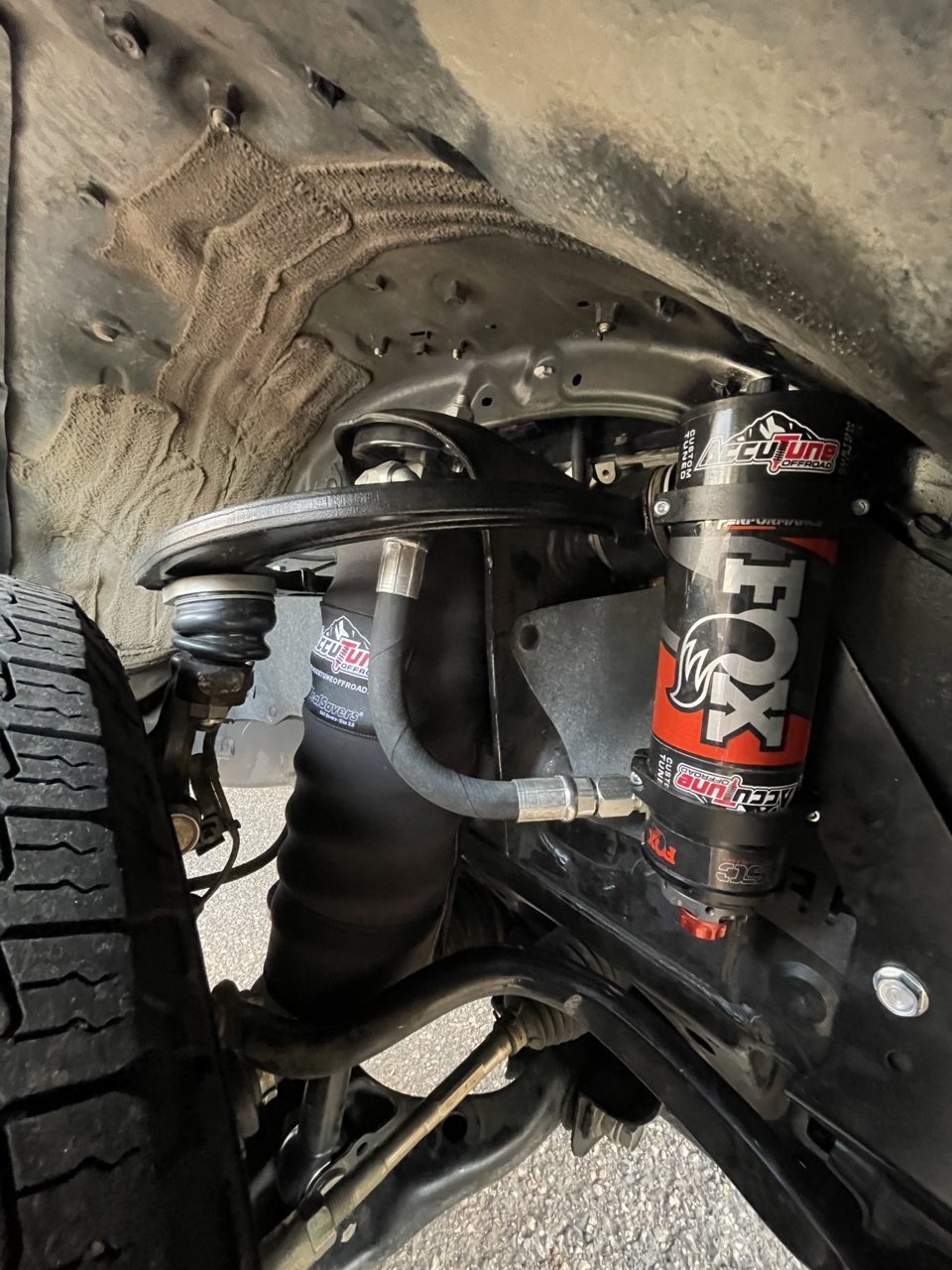

    Installed my Fox 2.5 coilovers yesterday and it was recommended by Steve at @AccuTune Offroad to go with 700# springs based on my mods. Got way more lift than I needed. Had Bilstein 6112 on before and already had 2" of lift. Got an additional 3.75" lift. Went from surface to fender 36.5 to 40.25". Was wondering if I can adjust to no preload and still have room for the shock not to bottom out. Not concerned about topping out since I'll be adjusting the other way, but was wondering about going to far the other direction. May need to get less spring? Too much lift is usually not the problem for most but any suggestions or advice would be appreciated.
    My goal was to get around one more additional inch and a much softer ride. I will say that even with the lift being as high as it is, the ride is night and day different. I love the ride so far, only about 18 miles since install.

    No, I have not reached out to Steve about this. I’m going to first try to adjust with no preload and see where that gets me. Is there any problem adjusting all the way up no preload?
    I also just measured the shock length at ride height and it’s 22 1/4 inches long. An inch and a quarter longer than it should be the right height. This is after I installed them with no adjustments.

    What weight do you have up front?

    I have RCI steel skid, dual batteries (NorthStar AGM), ARB dual compressor under hood. That's it up front. I do have Bamf sliders, drawer system/sleeping platform, fridge, camper shell and rear steel bumper.
    I spoke to Steve and he said to take all the preload out, which means I have to remove the shock. I tried with PB blaster and two 5/6 harbor freight punches and it was just to difficult to move the whole 1 1/4" all the way up. My shock on the truck loaded is 22 1/4" which is too long. Supposed to be 21" max. Ordered the SPC spring compressor today and it will arrive Friday. Not looking forward to removing the shocks to compress and move the collar and then reinstall. I took me over 4 hours to do the install myself. I'm meticulous so was careful and took my time. But it was difficult.

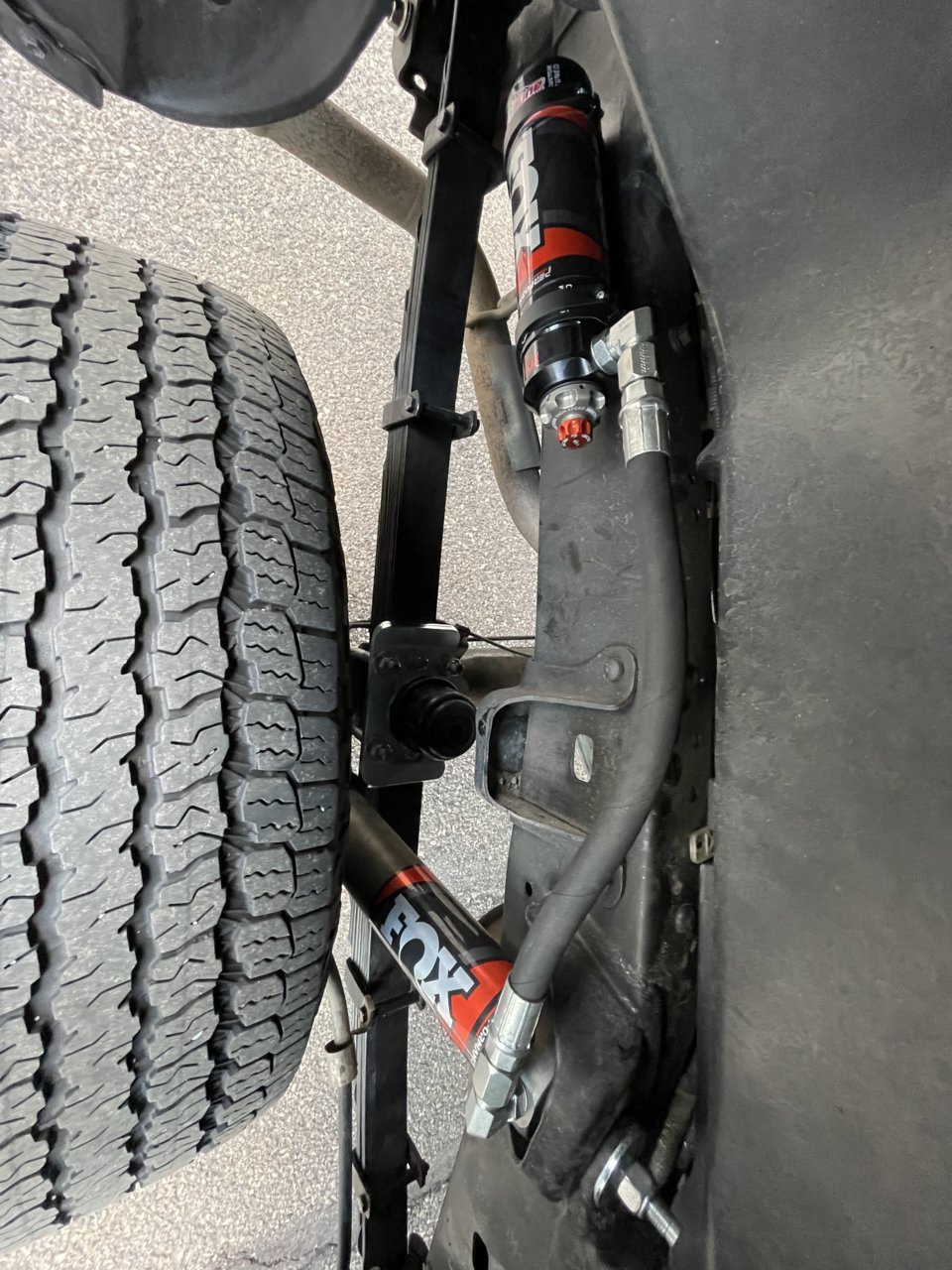

    Look what just arrived :bananadance:
