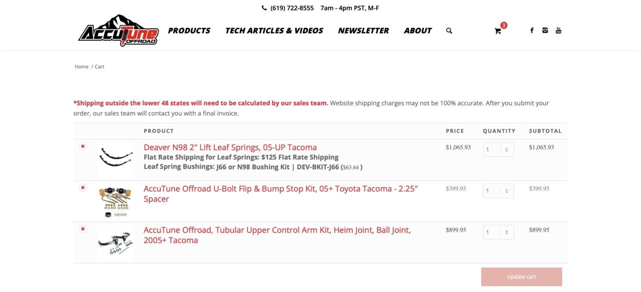

    That sounds potentially sketchy. :confused: Do you sell those/have a link? I think I've about made up my mind on the rest of the stuff...:popcorn:

    10,440
