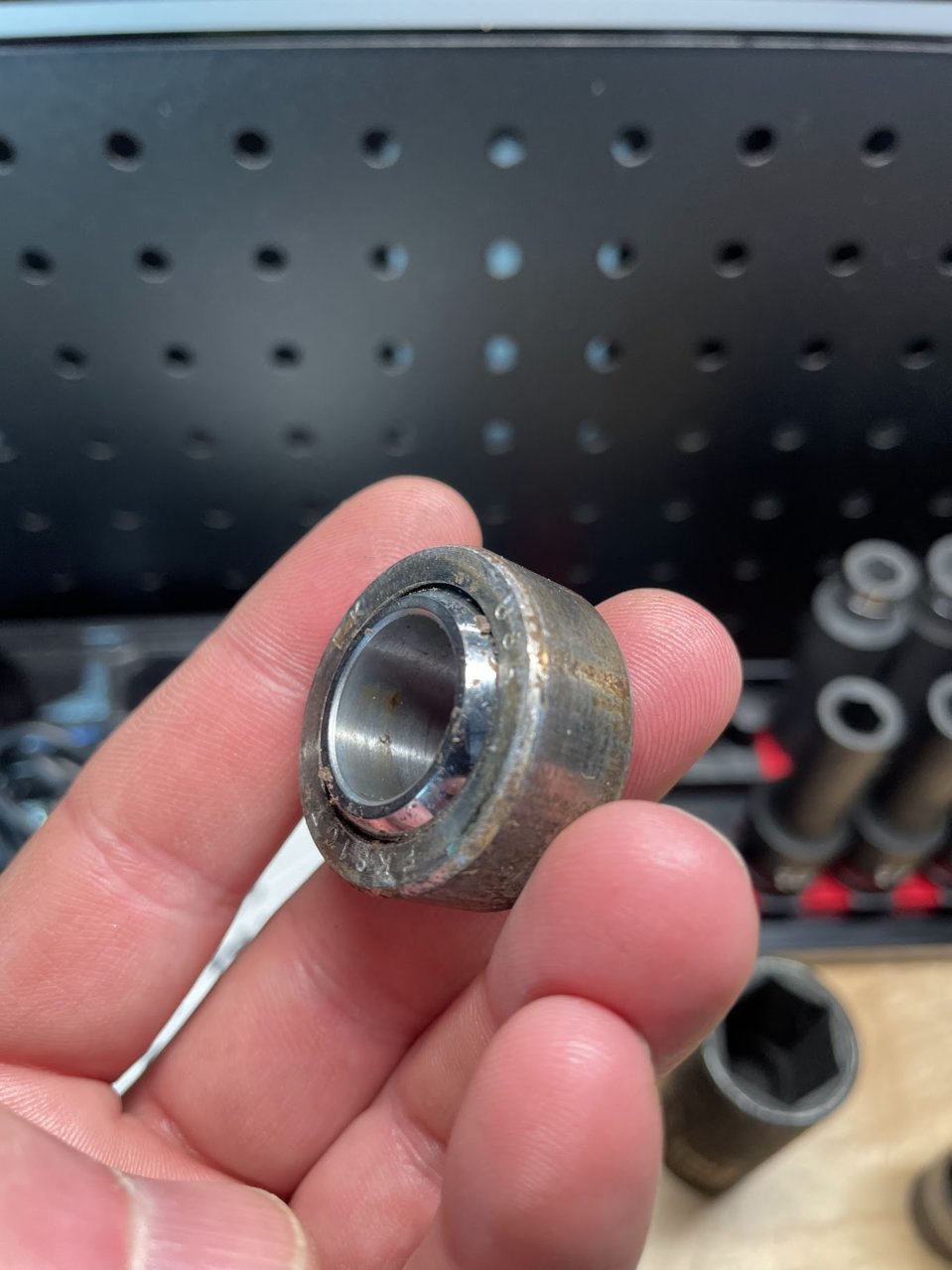

    How much life is everyone getting out of their lower bearings on the Fox 2.5's?
    Mine started squeaking pretty bad at about 10k miles. Swapped em out at 12k. Truck has been wheeled about 3x in that time frame, always pressure washed immediately after. This is the worst one, the other was a bit better shape.
    Some of the other companies pack their lower bearings (around the orings) with grease. So that's what was done this time.
    Used new lower shock bolts from 303 Shock Services, these have a smooth shoulder all the way down unlike OEM. I also purchased my bearings through him as well. Hoping this was a fluke (doubtful though as both sides squeaked), but maybe between the grease and the bolts they will last a little longer.

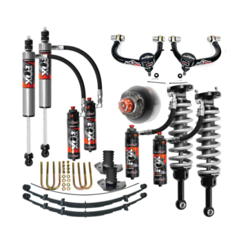

    Just bought Accutune's mid travel setup with fox 2.5 front coilovers, any suggestions on install, im clueless, not sure if I'll need to adjust out of the box, etc. 2022 TRD OR, just looking to get 2'' out of them.

    I bought mine directly from BDS/FOX and they came pre-adjusted out of the box with whatever "standard" lift height fox sets them at. 2"-2.5" I think. Driver's side has a pinch more preload I assume for the "taco lean." I think Accutune pre sets them too.
    From what I've read it's recommended to make adjustments off the vehicle with a spring compressor. If you set the truck on jack stands, let the suspension droop and then try to adjust you run the risk of breaking or damaging the collar or possibly chasing threads.
    There's several YouTube video's showing how to install. Otherwise find a competent shop.
    I haven't installed mine yet. I've got a 2023 on order that's tentatively due in late March. I might keep the 2017 and install them sooner though.
