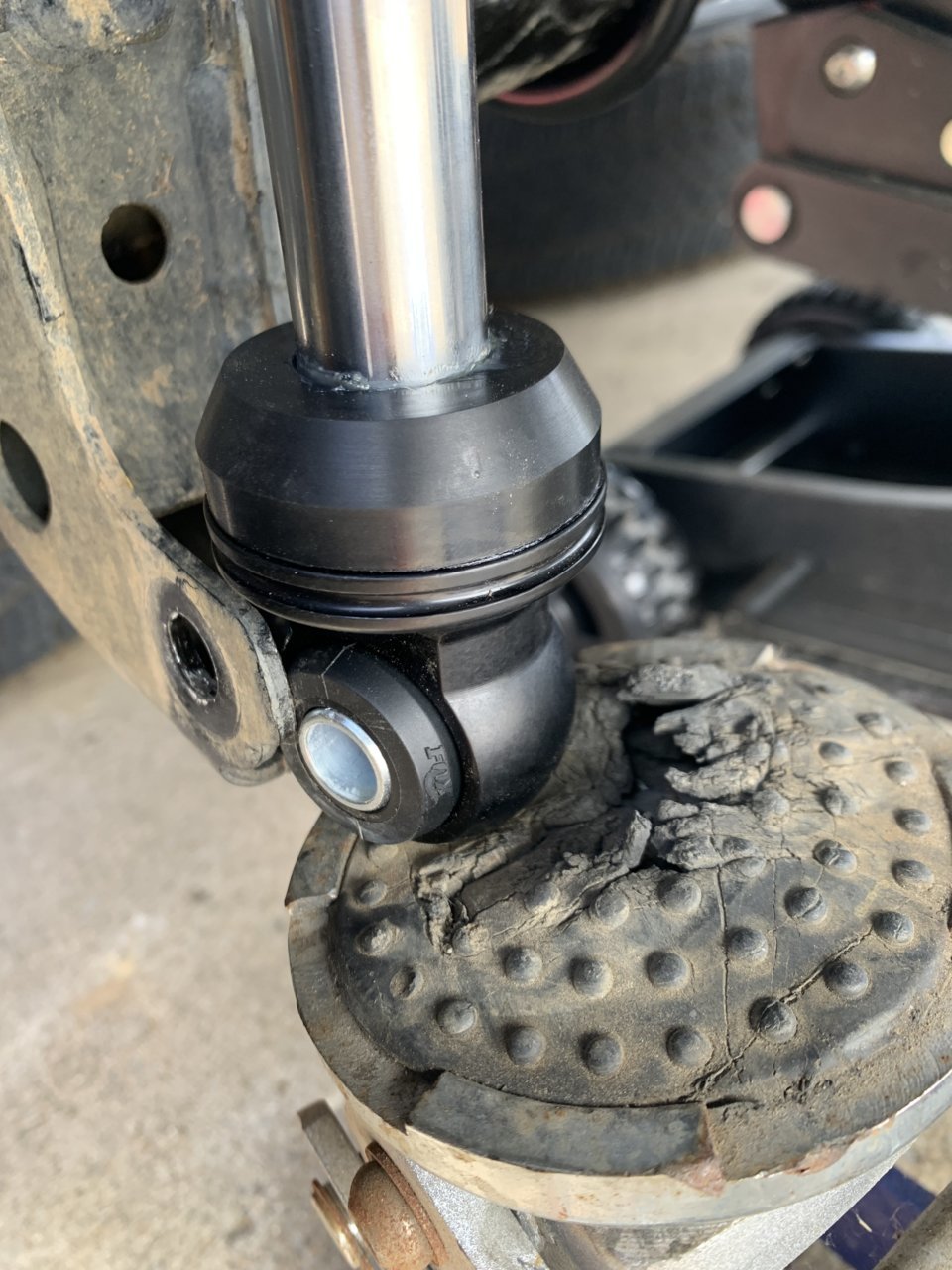

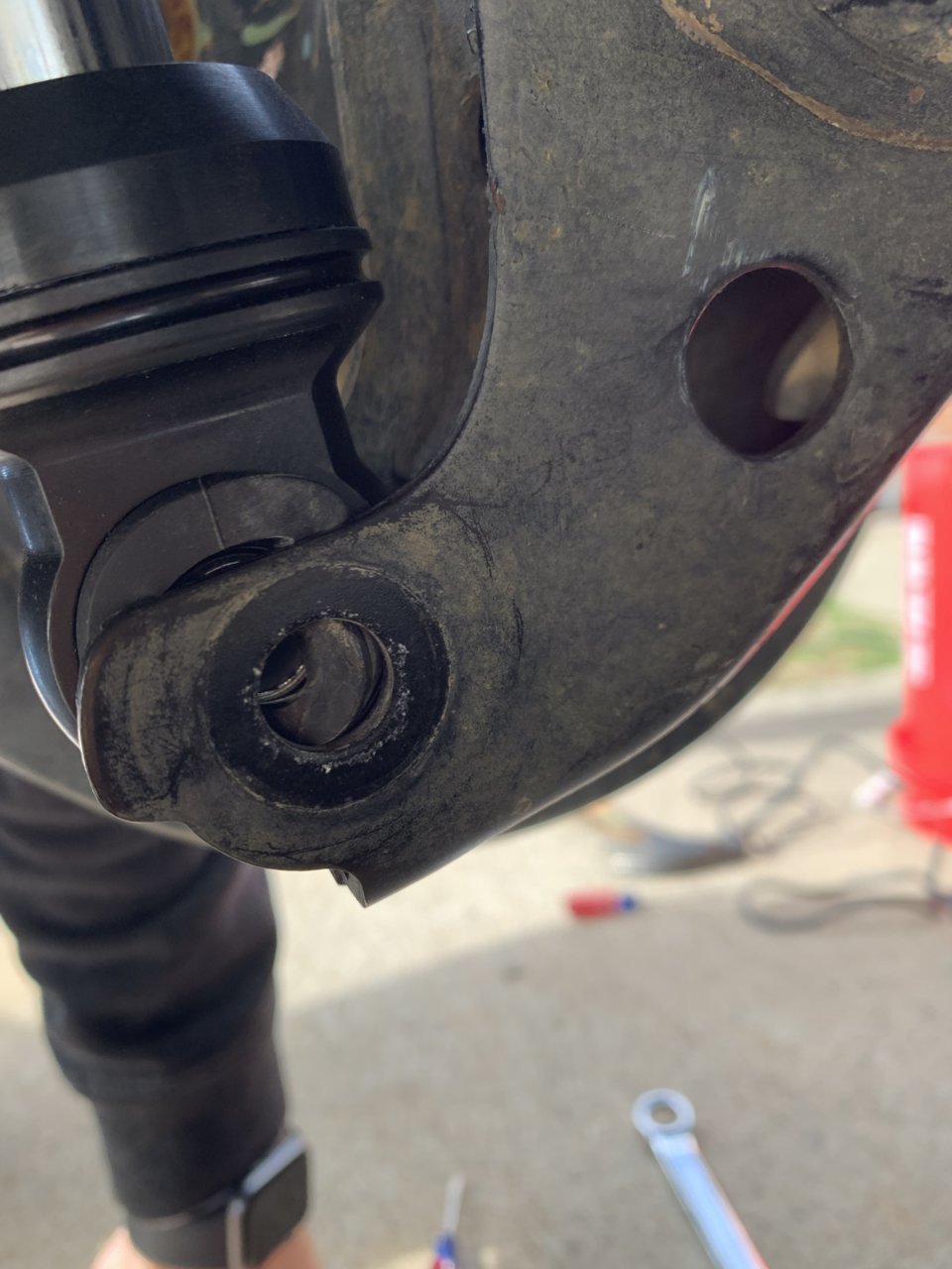

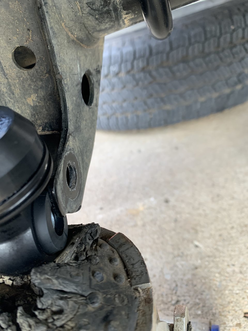

    Installed my Fox 2.5 PES rears last weekend. Anyone else have an absolute headache trying to get the rear lower shocks to line up with the mount?
    Noticed the metal sleeve inside of the bushing is not centered. Causing one side to have "more rubber", which gets distorted and protrudes out the bolt hole. My other rear shock is the exact same way, so I'm going to assume this is by design. The installation manual didn't mention anything about this nor which side the shock should be installed.
    I ended up installing the side with "more rubber" facing towards the wheels as I could monitor the rubber and use a tiny flathead screwdriver to direct the rubber from protruding. Lubed it up with a lot of waterproof grease, beat it with a dead blow hammer, and used screwdrivers to pry and push for alignment. Passenger side bushing got a little too marred up so I had to cut a sliver off the bushing with an razer blade.

    Same exact issue. Accutune told me that Fox has super tight tolerances to fit that way. took a bit to get it lined up for sure though. It's worth it!

    Hmm, that's good to know. Kind of sucks beating up brand new parts just to get them to fit. Hoping I didn't compromise the integrity of the shocks or the bushings.
    Would you happen to know if the metal sleeve inside your bushing on the rear shocks was more towards the wheels or the differential?

    I honestly can't remember but I just placed it based off the reservoir hose side out and the eye was in line so I went with that. Def a bit off hitting with a mallet and manipulating. The rubber got a little pressed like you said too.

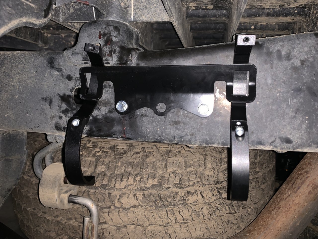

    Sanity check. Are these clamps in the correct orientation (Performance Elite's). Manual said to not feed the clamps through the slots in the brackets.
  13. Feb 21, 2023 at 8:44 AM
    #3693
    AccuTune Offroad
    AccuTune Offroad Well-Known Member Vendor
    Jan 28, 2019
    #281012
    1,657
    El Cajon, CA
    yes thats correct.
