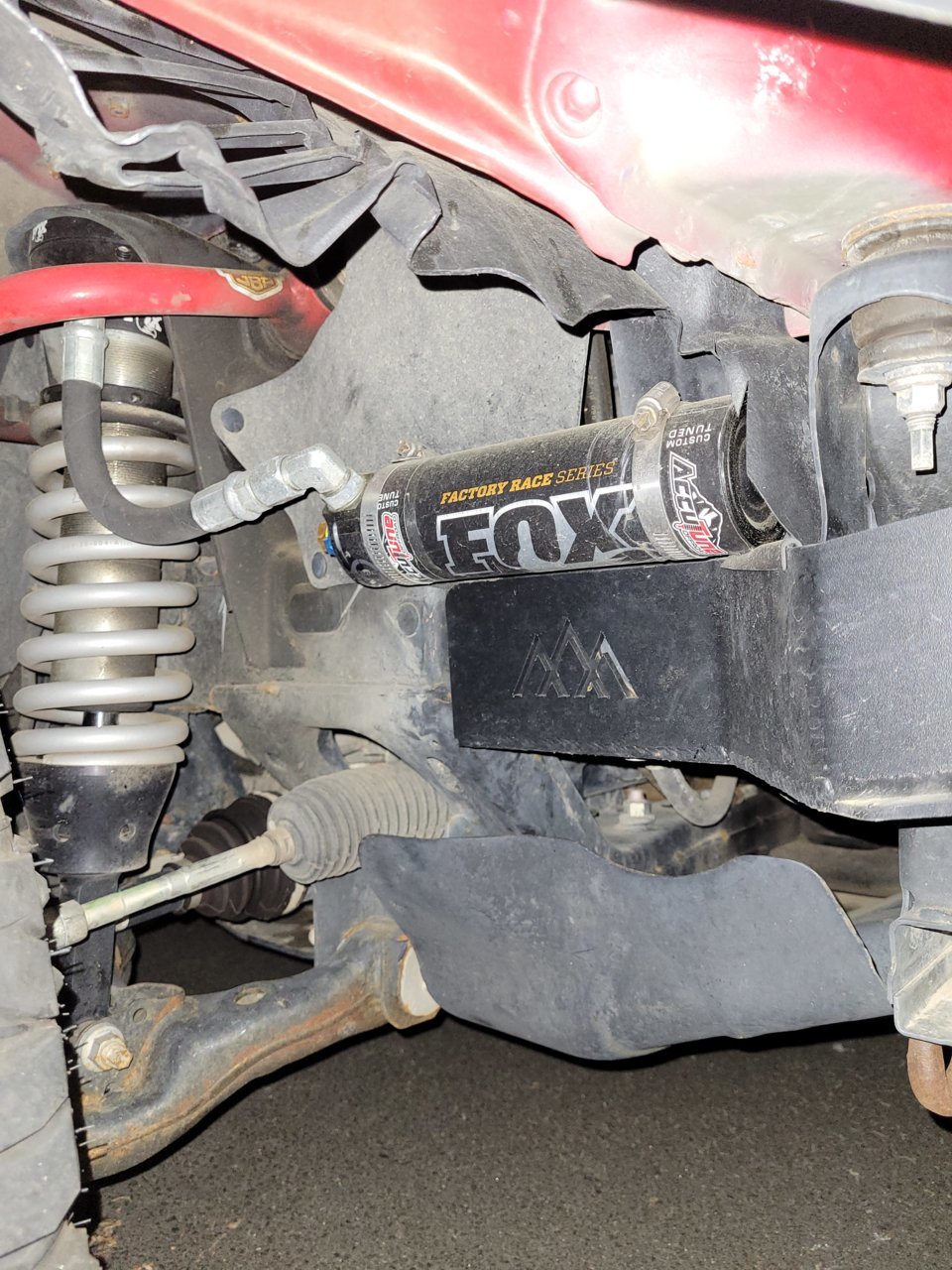

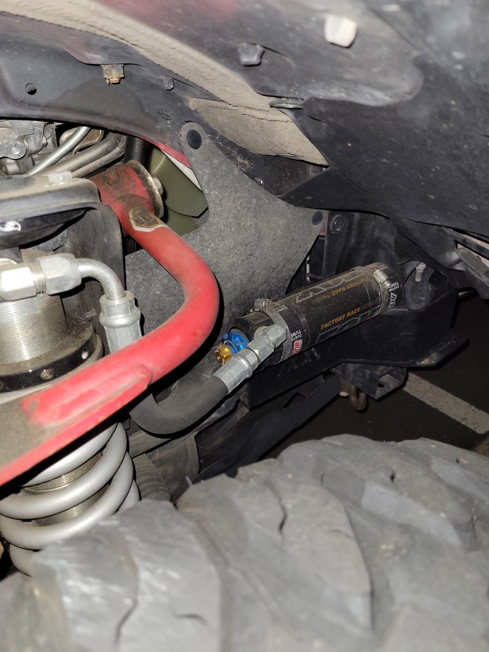

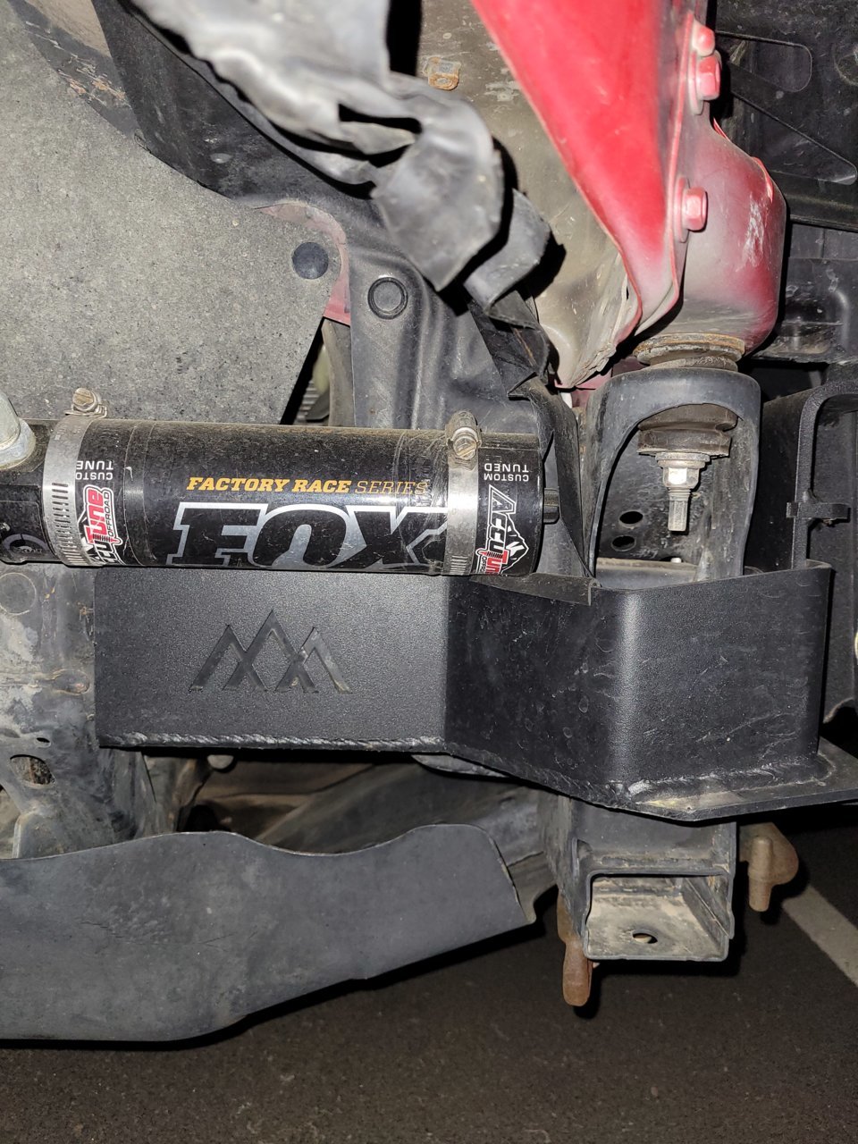

    Just installed a new bumper with frame supports for witching. The Fox 2.5 reservoir up front is hitting the fame support. I have pushed the reservoir as far back as I can without the hose hitting the coil. I have tried putting reservoir mount on the outside if the support bracket, but then the tire hits at full lock.
    Anybody face this issue?

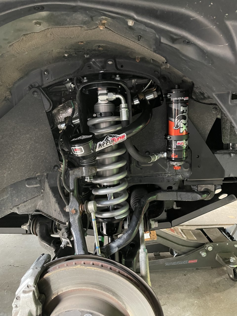

    Just picked up these up from Accutune today, waiting on the Archive kit to come in :D:D:D
