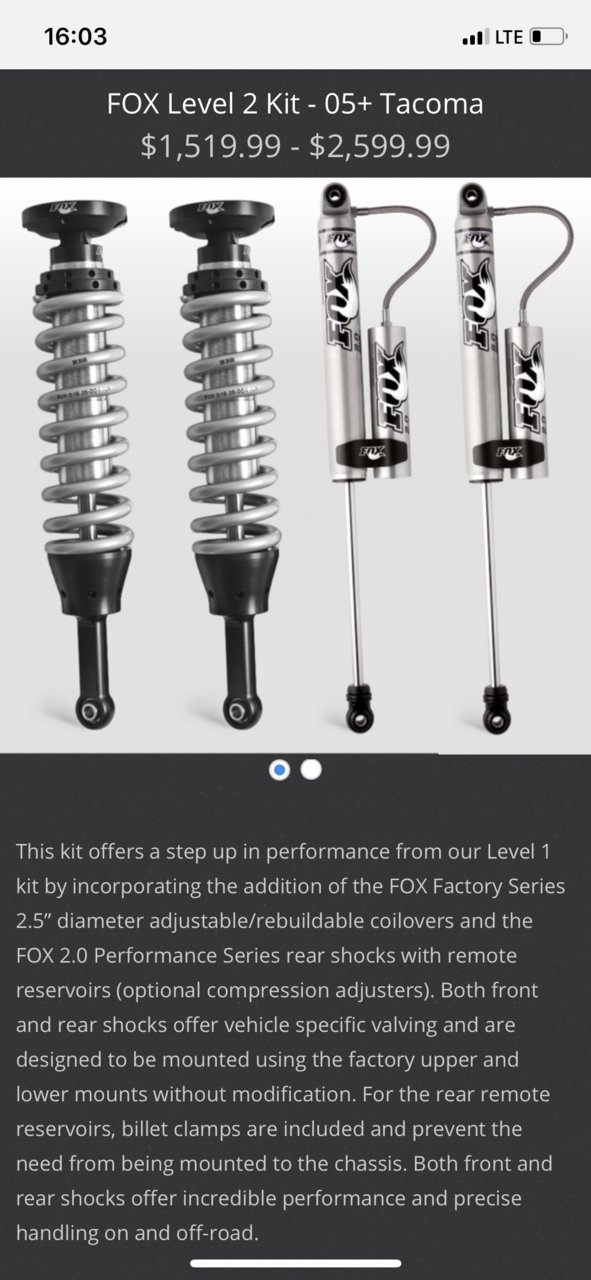

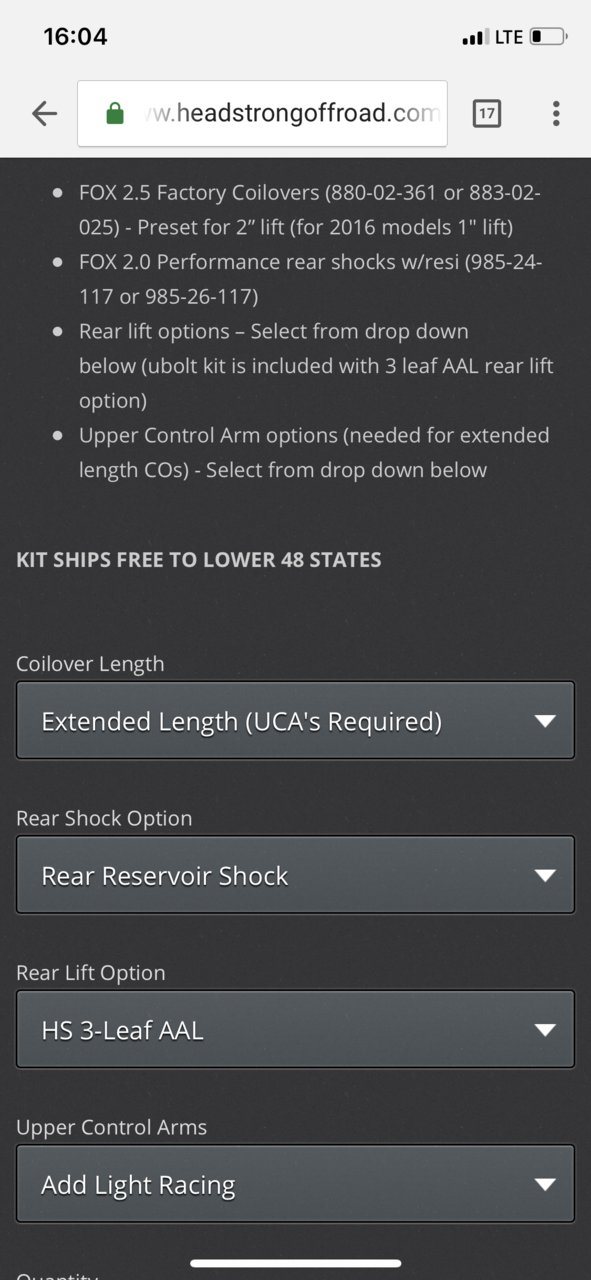

    Alright gents I have a question, I am getting ready to pull the trigger on a new suspension for my truck, 2017 TRD OR 4x4, and I think I have everything I’m gonna need for it lined up but I want to make sure that once I start ordering parts, I order everything I fully need.
    This is what I plan on ordering, FOX level 2 Kit. Here is a couple pictures of what I plan on ordering, if you think I’ll need anything else other than ECGS Bushing please let me know.

    Looks like most of what you would need, you may want to make sure that it comes with longer U bolts to account for the 3 leaf AAL. This is basically the same setup I have and I'm happy.
    This was all that I used, and I didn't really need new bump stops.
    - Fox 2.5 extended length coilovers
    - Fox 2.0 rear shocks with reservoirs
    - 3 leaf add a leaf
    - U-bolt flip kit w/ SuperBumps
    - Front SuperBumps
    - SPC Light Racing upper control arms

    If you have ANY extra weight, those coil springs will NOT be strong enough. I got the same front/rear set & the ONLY time I was able to lift the truck the advertised height (3" for 2nd gen), using Fox's maximum recommendations, was when I took off my front bumper! Those come w/13" 600lb. spring, which they're the ONLY ones using a spring that short w/that weight. There's a reason why they're the only ones, because it's too short/weak.
    I've added some weight so now I'm having to get 14" 650lb springs & have them installed on the C/O's. This is adding a significant cost to my set-up. I inquired w/HS about this set-up working even after adding weight & she said it'd be fine. Well, that's 100% BS! It was only fine absolutely bone stock, & it was pushing it even then. Don't get suckered into the same sham I did & order them elsewhere where they'll swap the springs for longer & stronger ones from the start. HS said they will but she told me it adds $300 to the initial price. I've read where others have been able to order them w/strong springs w/no upcharge. I tried to return mine to HS & was told once they're installed, they can't be returned. Other than getting a product that doesn't work as advertised, HS was great to deal with!

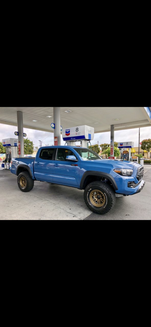

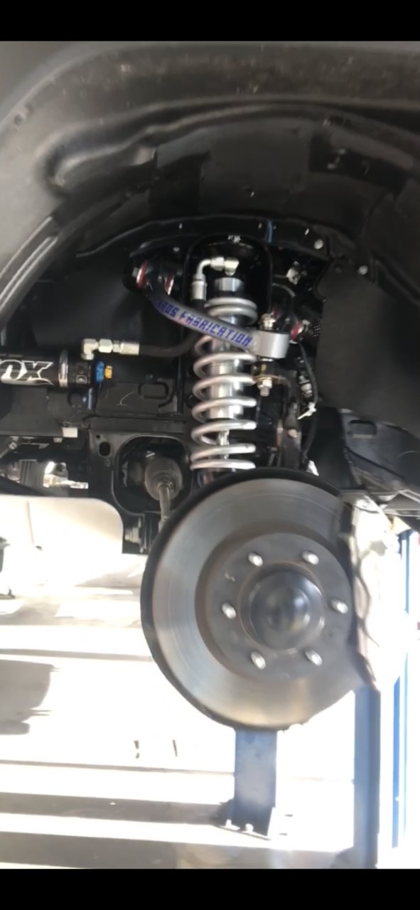

    I ended up buying getting
    Front: Fox 2.5 Extended/Resi/DSC
    Total Choas UCA
    Rear: Fox 2.5 Resi/DSC
    Readylift 1 inch leaf block
    I was told by Neil from Down South Motorsports if I wanted to run the 2.5’s in the rear at most I should raise an inch. If I wanted a higher lift to run the 2.0’s with adjustables. But I wanted to have the matching set all around so ended up going 2.5’s all around with the 1 inch lift by readylift. Night and day difference over stock pro fox shocks, especially the adjustability of going firm or soft. Definitely worth the extra money.

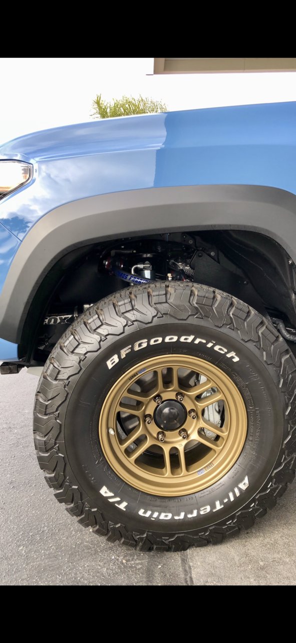

    Looks like decided to go without the sway bar. How does it ride?
    2018SMURFPRO[QUOTED] likes this.
  19. May 22, 2018 at 5:18 PM
    #379
    2018SMURFPRO
    2018SMURFPRO Well-Known Member
    May 14, 2018
    #253461
    155
    TOTAL CHAOS 3.5 LT RACE 18'S TE37 PROGRESSIVE
    I can feel a bit of sway but I have the stiffest settings so it feels like stock. I’m going to test it out on the trails this weekend.
