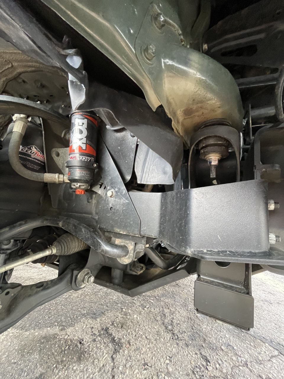

    anyone with the fox 2.5 Pe's worried about damaging their front reservoir knob from sway contact? especially when you folks plan on doing little off roading or rock crawling? i myself is contemplating on removing my sway in all or just before I plan on off roading. from what i see a bunch of people have already damaged the front reservoir dsc knob from hitting the sway bar

    Mine has not touched at all. Make sure your sway bar is centered? Idk
    I did fins and thing, hells revenge, and a whole bunch of off-roading in Colorado including Imogene. I think you have to just be aware and adjust as you go

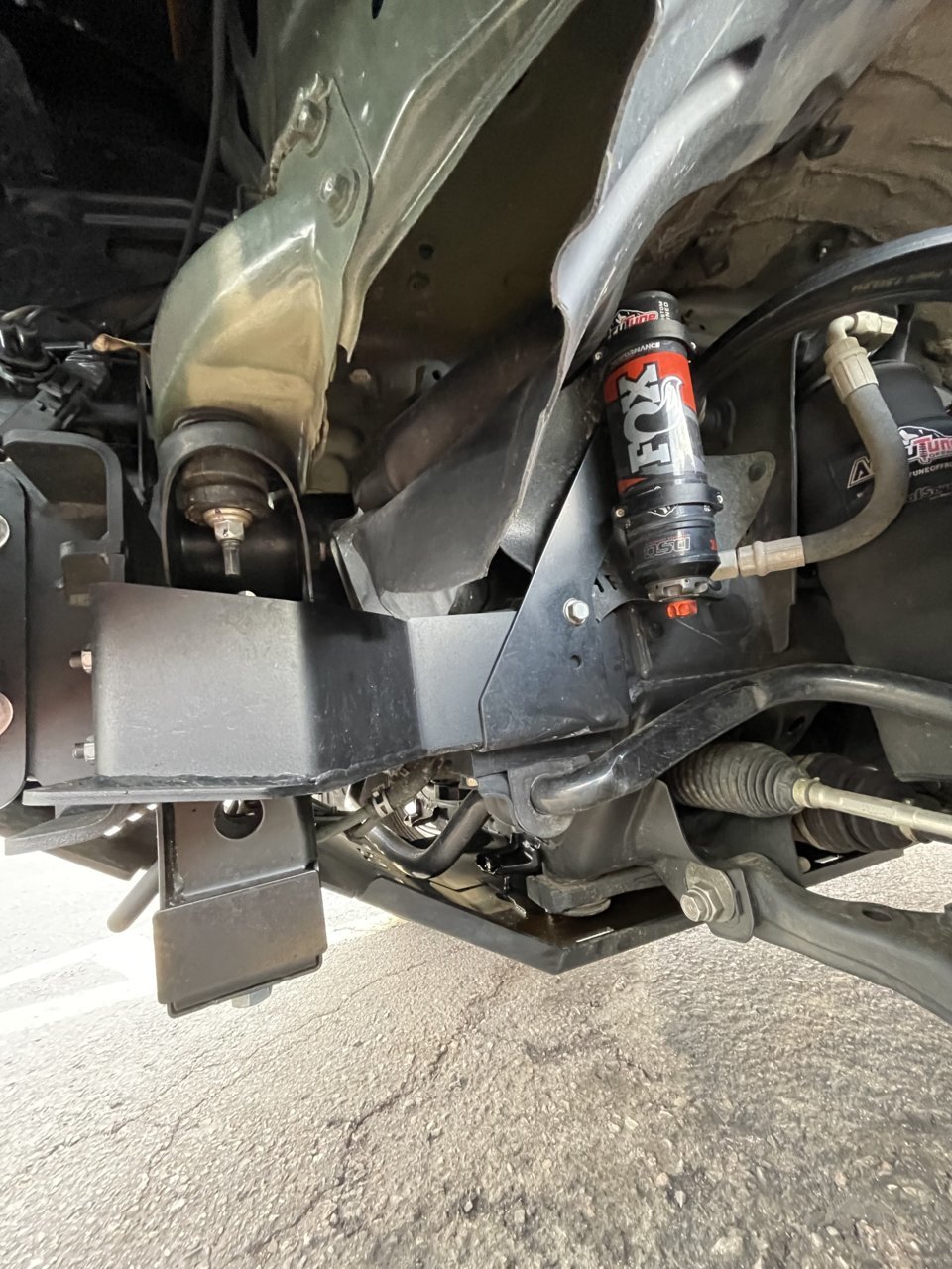

    Yea I don’t understand. Would having the resi mounted 1/2” further out (towards the tire) help? I’m running frame support brackets from backwoods adventure mods so my resi bracket sits on top of that steel bracket instead of my frame. I would think this would make it more likely to contact though and yet no issues here

    if you dont mind me asking could you post a picture of how that set up looks? the support brackets from backwoods adventure and a posted link

    5F318432-82D2-4EFB-95F9-183C0CC890C4.jpg E8FE405B-7361-49ED-8E97-50E1084D3D08.jpg 3B99375E-77D4-4078-ABE3-164F9F71F2E5.jpg
    https://backwoodsadventuremods.com/...-support-brackets?_pos=1&_sid=0992766ae&_ss=r
    note these fit with king shock brackets but for fox I had to drill a hole where the self tapping screw goes halfway up the bracket. Probably could find another way to attach it there too but that’s how I fixed it. It seemed I didn’t need to get the hole that perfect just close
    edit: looks like the frame support bracket also further spaces the sway bar down. Maybe that helps

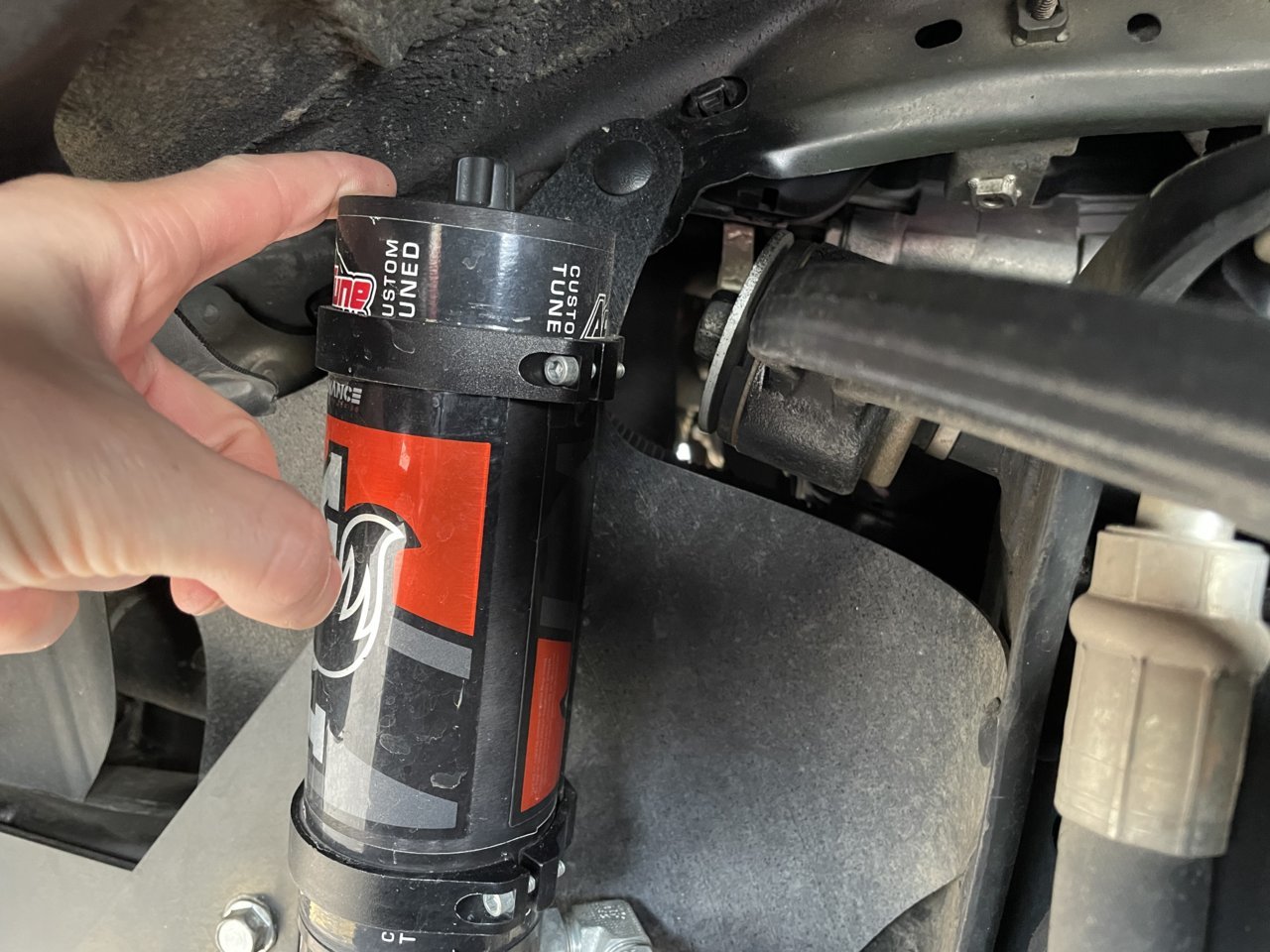

    i took pictures of how my resi’s are mounted and basically pushed all the way up. does it look like everyone else’s close to the sway bar?

    Looks about like mine. I’d say you shouldn’t have any problems. Update us if you do end up with rubbing but it looks like you got the resi up as far as it’ll go

    Mines is just like yours. Shouldn’t have any problems.
