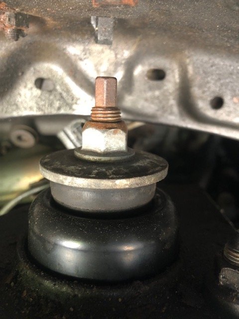

    damage from hitting front sway bar?

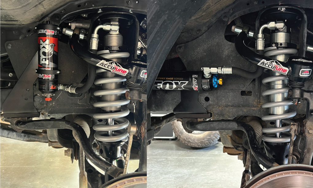

    can the mounting orientation be changed on the Pe's by simplying rotating the remote resi like the factory race and just using clamps? clamping the pe's resi to the frame or something?

    I haven't come across the sway bar issue yet ,granted my resi's are mounted as far up as they can go. Both low speed adjusters do not show any signs of damage or wear.

    Below is a photo of the the new Performance Elite Series reservoir mount vs Factory Race Series reservoir mount.
    -Can the PES reservoirs be clocked a different way? Sure, but not something we've done to confirm works and clears the sway bar. Proceed with caution.
    -Swapping reservoir brackets to the FRS style mount may work, Fox stickers would be upside down. Can't confirm its a perfect swap. This is not something we stock.
    -If you remove the reservoir bracket for some other method, you would be losing the sway bar drop that is part of the reservoir mount. So keep that in mind.
    -Adjusting reservoir fittings is still something we recommend a professional does for you. However, if you are a DIYer and have access to a Nitrogen Tank to properly discharge the shocks, you can reference this article to make adjustments.
    -Possible reservoir mounting option
