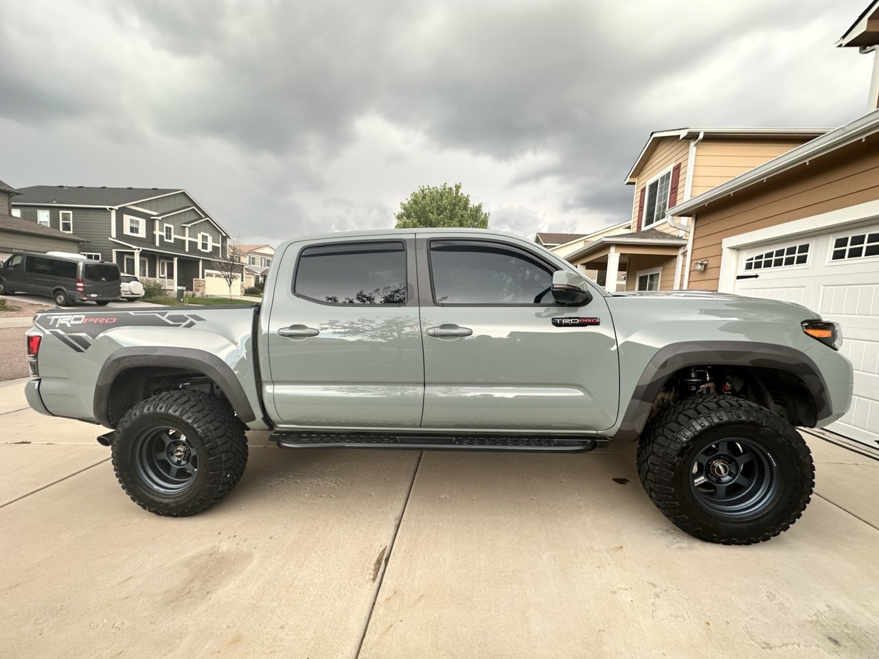

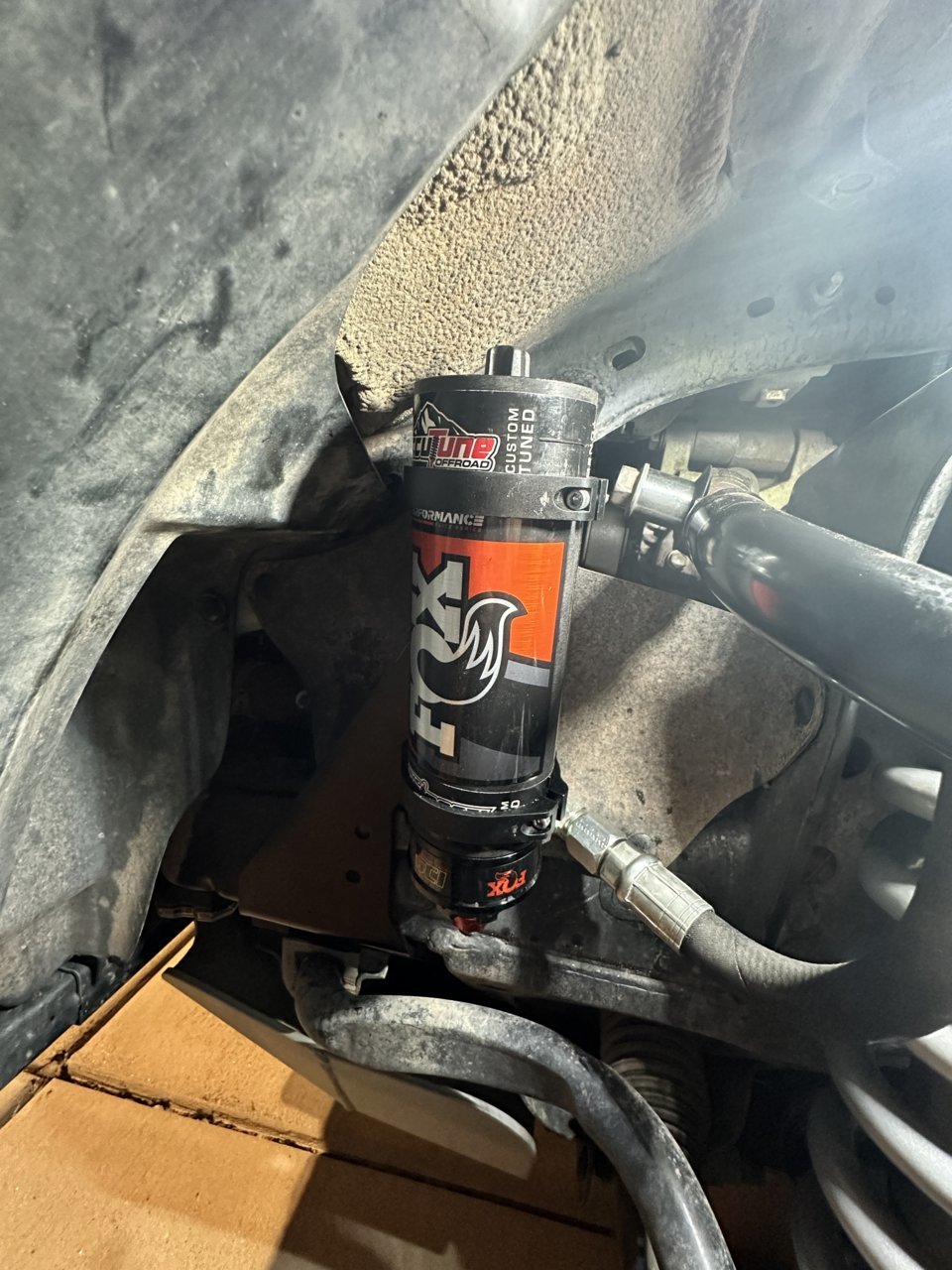

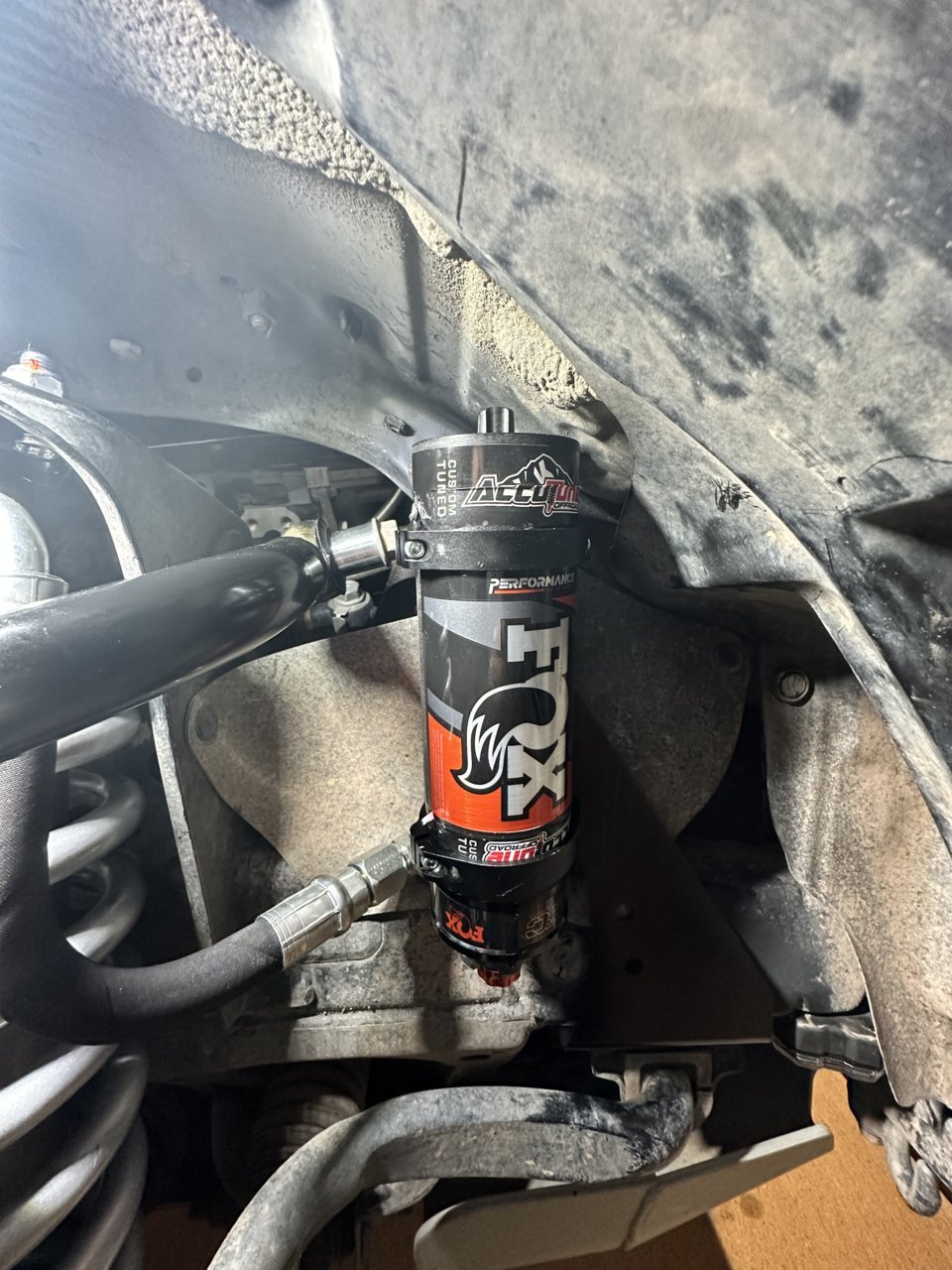

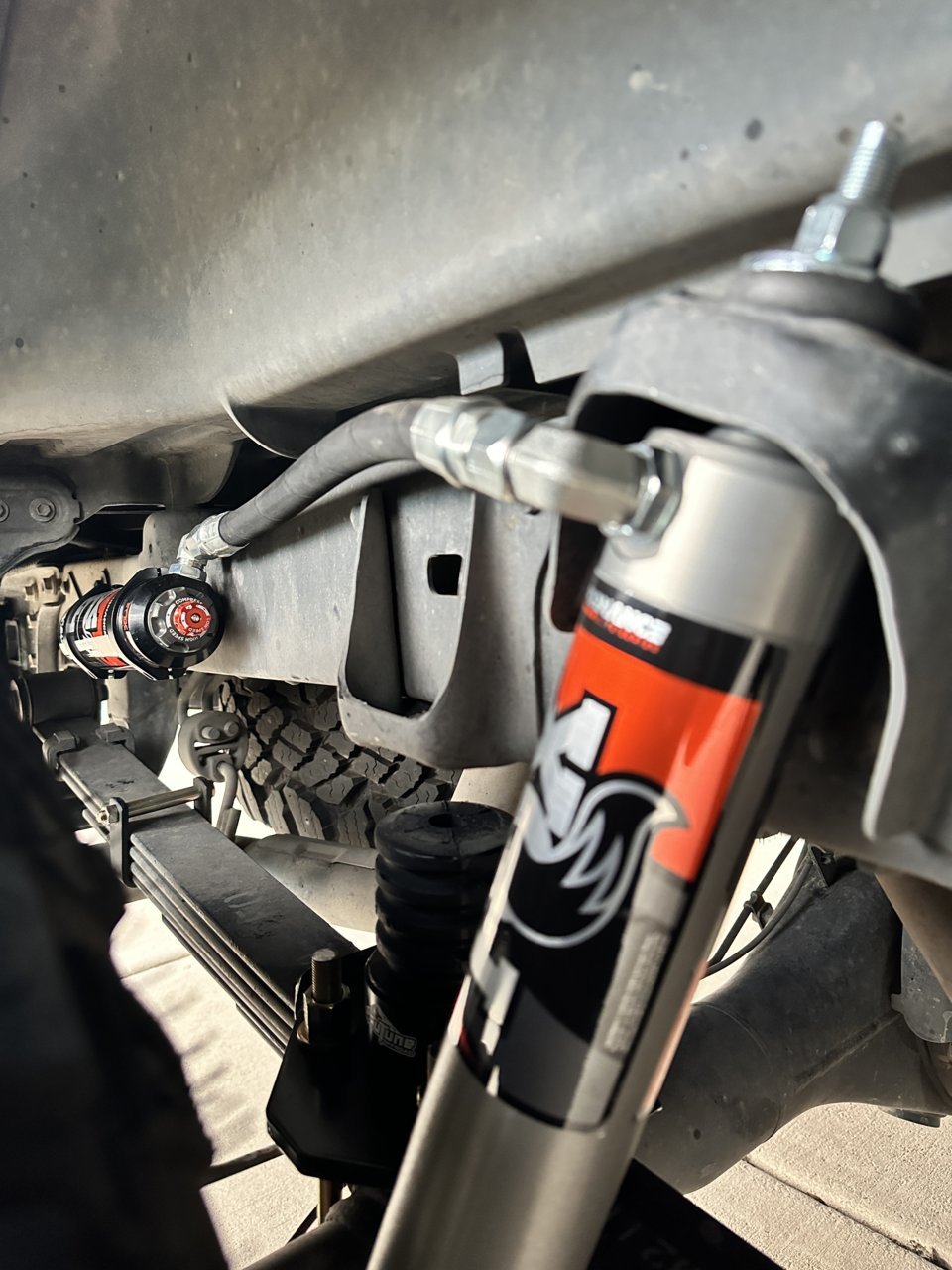

    Just got my suspension installed by Hefty Fab. Stage 3A with the Performance Elite Series shocks. So stoked!IMG_0411.jpgIMG_0412.jpgIMG_0413.jpg

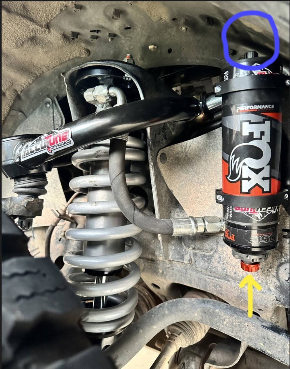

    Looks good. You're now another member of the Accutune family. I Accutune'd w/ FOX 2.5 DSCs on all 4 corners a few weeks ago, DIY on the install, happy with it so far. Sent lots of photos of my install to Accutune & they head-nodded & said it looked good. Excellent, detailed customer service via email w/ them.
    Note, in your first photo, the remote reservoir (RR) -- see the clearance between the red (small) DSC knob and the sway bar? The yellow arrow in my annotation below. There's not a lot of room there. The RR should be slid up as high as it's possible to go in its mounting brackets to reduce the chances of the sway bar coming up & smacking the red DSC adjuster knob. This has been known to happen & it can break the DSC adjuster mechanism. I see close to a full 1" of space between the top schrader filler cap on the RR & the top inside of the wheel well. (The blue circled area in my annotation.) Might want to close that gap to just 1/8" or so to maximize the clearance between the busy sway bar & the DSC knob at bottom.

    thanks for the tip. I’ll adjust it now. Much appreciated!

    Just edited my post & added illustration, reload page & scroll up
    Be super-careful w/ the screws in those remote reservoir brackets, they are easy to cross-thread & snap, ask me how I know. IMO those RR brackets look flashy and slick but the old style worm-screw clamps are a lot easier to work with.

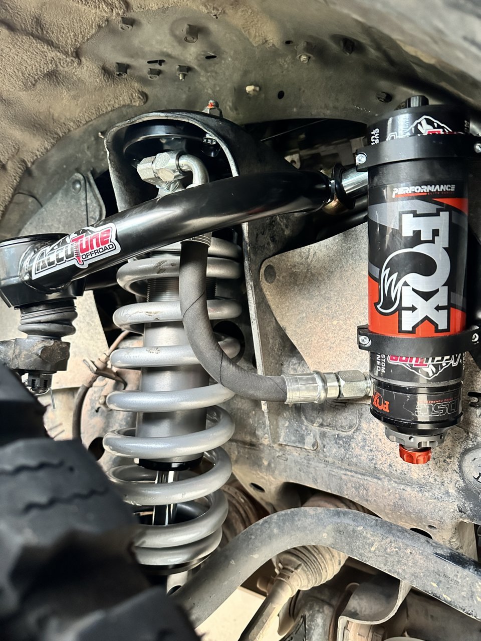

    just pushed them up a bit to where the outside edge of the top of the RR is almost touching the fender well. IMG_0416.jpgIMG_0418.jpg
