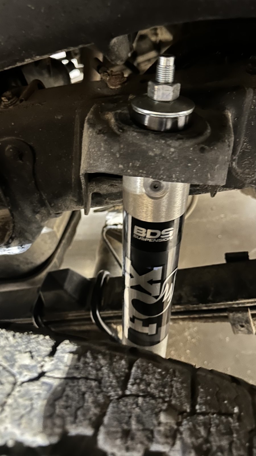

    Hey all, I’m installing my 2.0 external reservoir non adjustable (PN# 985-24-116) rear shocks on my 2018 Tacoma. I called fox and they said to adjust the top bolt enough for the bushings to be flush with the washers that come with it. Easy enough. My problem is that I can still turn the shock with my hand. Is this normal??
  2. Oct 2, 2023 at 6:41 PM
    #3842
    wretnuh
    wretnuh Member
    Sep 6, 2023
    #432951
    9
    Thinking about this more, I don’t think tightening them more would even help this because the bushings are separated from the shock body by those concave washers… thinking maybe this is just a common thing and something I had overlooked during my research. My concern is that the reservoir is attached to the shock body and if it rotated enough it could possibly start rubbing some other components…

    I would leave it as is, and check back after an off-road trip to see if anything changes. You really do not want to over tighten that nut. That stud is threaded into the shock body and we have seen them unscrew due to the nut being too tight.

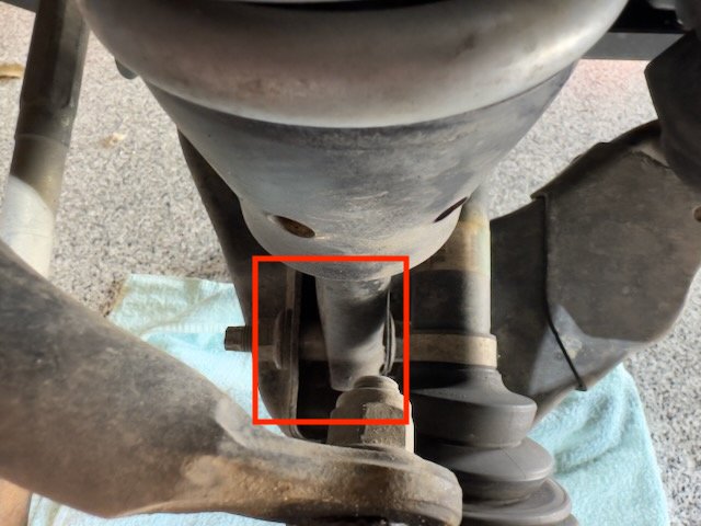

    Anyone know why this is happening and how I can fix it?
    My lower shock mount keeps rotating until it hits the side of the LCA mount.
  12. Feb 26, 2024 at 2:59 PM
    #3852
    TVH475
    TVH475 Well-Known Member
    Dec 18, 2018
    #276220
    325
    Montrose CO
    Possibly the bearing is shot in the eye of the shock?
  13. Feb 26, 2024 at 6:12 PM
    #3853
    jtweezy
    jtweezy Well-Known Member
    Feb 9, 2014
    #122631
    1,370
    Austin
    2014 4X4 DCSB OR V6
    Allowing it to rotate too much or too easily?
  14. Feb 27, 2024 at 5:37 AM
    #3854
    TVH475
    Dec 18, 2018
    #276220
    325
    Montrose CO
    It's basically a uniball bearing so if its completely worn out the inner bearing could be moving in the race. Mine are worn out, squeaking, but not moving yet. I need to send my shocks in for a tune up.

    Looking at some videos about worn lower mount bearings, I think mine is definitely shot. I’ll add those to my list and start there. Thanks!

    That can happen even with a new shock and or bearings. It's a bunch of cylinders that can rotate around the spherical bearings unfortunately.
    I have replacement bearings and the latest Fox lower spacers that have an O-ring to help keep the rod ends from turning.
    Good: https://www.303shockservices.com/product-page/2-5-coilover-lower-mount-replacement-bearing-kit
    Better: https://www.303shockservices.com/pr...-coilover-lower-mount-replacement-bearing-kit
    Best: https://www.303shockservices.com/pr...-coilover-lower-mount-replacement-bearing-kit
    We also have upgraded lower bolts that are shanked and a constant diameter vs the stock bolts.
    https://www.303shockservices.com/product-page/toyota-lower-shock-bolt-set

    Is that the right shock? I ask because I just looked at mine and it touches both sides of the shock mount with no play. What version shocks are you running?
  18. Feb 27, 2024 at 3:05 PM
    #3858
    jtweezy
    Feb 9, 2014
    #122631
    1,370
    Austin
    2014 4X4 DCSB OR V6
    Thanks! I also came across a post where someone got new equal length alignment spacers with poly bushings. Similar to tubular UCA pivots that filled the gap in the lower shock mount and prevented the rotation.

    It’s the right shock. Fox Factory Series 2.5 remote reservoirs with DSC.
  20. Feb 27, 2024 at 3:11 PM
    #3860
    GilbertOz
    GilbertOz Driver
    Oct 18, 2018
    #269844
    1,883
    CA
    2014 AC V6 MT 4WD, 84K miles
    FOX 2.5, Deavers, ARB, OTT, 4xInnovations
    Something looks drastically off in this photo. There should be no gap between the inside surfaces of the LCA mounting tabs and the outside of the shock mounting eyelet.
    I just looked at my FOX 2.5" DSC front coilovers (installed on an otherwise-stock 2014 TRD OR with stock LCA's) and there is no gap at all. On my vehicle, as-installed, it is not possible for the shock mounting eyelet to rotate in any axis except the intended one, i.e. around the longitudinal axis of the mounting bolt.
    Do you have stock Toyota LCA's on your truck?
