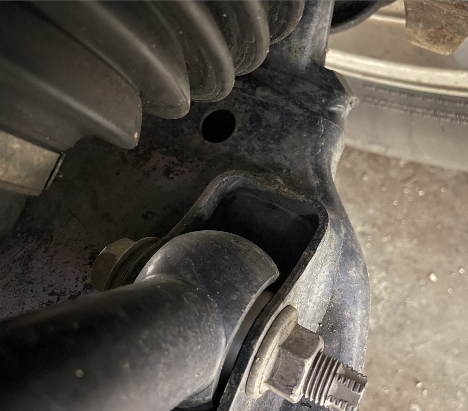

    Stock LCAs. If your mount is as wide as the gap in the mounting tabs, does that mean you don’t have misalignment spacers?

    Every Tacoma I’ve seen (and install videos) has this gap. Large misalignment spacer in the front, small in the rear. Same story, different truck.
    I’ve never seen one that has a lower mount wide enough to fill the gap between the lower mounting tabs. Maybe Fox released a new lower eyelet mount?
    Edit: it looks like the new performance elites (for the 3rd gens anyway) have a wider lower mount and no misalignment spacers. I have the old, steel body Factory Race Series.

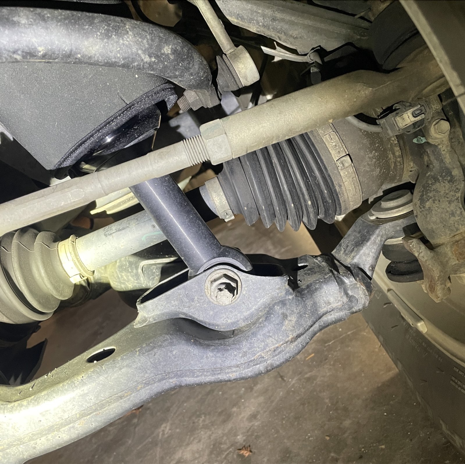

    I misspoke -- actually, there is a gap on mine, at least on the eyelets themselves. But it is fully filled by whatever sort of spacer/bushing that is inside them. Certainly there shouldn't be any play that allows the eyelet & stock lower mounting rod to rotate out-of-plane.
    My parts are FOX model #883-06-178-113, Fox 2.5" Performance Elite, DSC, 0-3" lift. (Aluminum body.)

    Nice, you got the PEs! It looks like they fixed a problematic design. That said…the old design has been fine for hundreds (thousands) of trucks, so I think it’s a solvable problem. I just gotta land on the right solution.

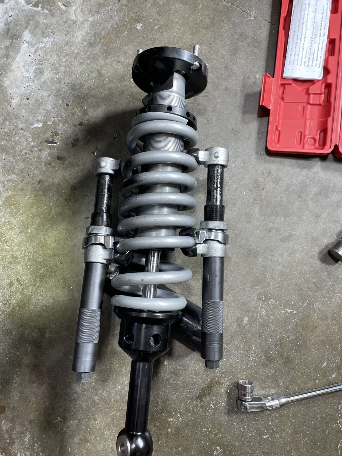

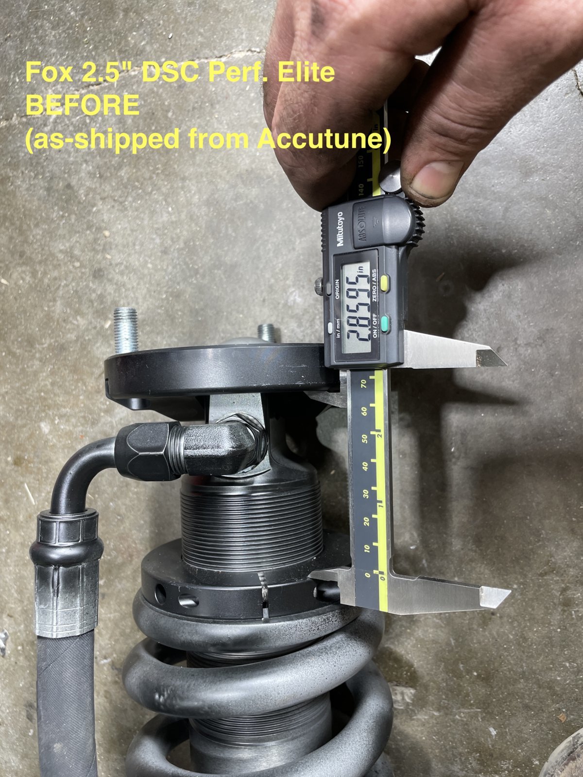

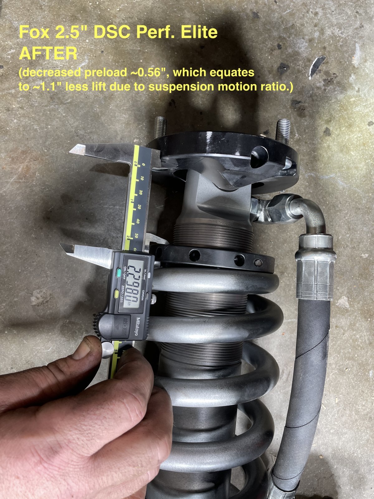

    I'm not sure what FOX sets them to from the factory, since I got mine from Accutune & they pulled them apart & re-assembled them as part of their normal sequence of custom valving/tuning, etc.
    As-shipped from Accutune, with their "Adventure"-level tuning, with 650-lb springs, the preload was set at 2.86". Note that as part of my order with Accutune I noted that I have an ARB front bumper but no winch installed, which increases stock front end actual weight maybe 30-40 lbs or so over stock. Note that the effective load is actually somewhat higher due to the ARB sticking way farther out (at least 6") compared to stock bumper.
    The as-configured-by-Accutune preload amount lifted the front end too high for my liking, and also caused the front CV boot accordion folds to touch/rub. I reduced preload by 0.56" (down to 2.30") which dropped the front end by a full inch of actual lift, due to suspension motion ratio.
    Note 1: If you are doing your own preload adjustments, invest in a quality set of spring compressors and take your cautious time getting to know how to use them. (For example: SPC Performance UNIV SPRING COMPRESSOR, model 40260) It is possibly to lose an eye, break teeth, or suffer penetrating flesh wounds if an improperly-compressed spring suddenly slips out of its restraints.
    Note 2: My FOX'es look a bit odd because I debadged them (removed all decals) and rattle-can spraypainted them black to reduce their visual signature.
    Note 3: The passenger-side coilover came from Accutune with a different preload setting, presumably to counteract "Tacoma Lean" due to battery, fuel tank, and driver weight on the driver's side of vehicle.) Its "before" setting was 2.44", and I reduced it by 0.65" to 1.79".
    See attached photos:
    DRIVER'S SIDE BEFORE
    DRIVER'S SIDE AFTER
    4runnersr569[QUOTED] likes this.

    Just to be clear, unless you tell us exactly how much preload you would like on the coilovers, we do not make preload adjustments prior to sending out.
    Also, just so others are clear, this is not how you measure preload. However, I do understand this method was used to see how much the preload collar was moved.
    TVH475 and GilbertOz[QUOTED] like this.

    Thanks for that clarification, important point. In my case I used the top-of-collar-to-bottom-of-the-top-hat measurement because my calipers aren't large enough to measure the full spring length. Preferred the accuracy of calipers vs. the looser (and easier to confuse) "counting the threads" method, or using a carpenter's tape measure on the spring.

    For measuring threads showing, yes that looks like a pretty good method. This is still not actually measuring preload. That term gets thrown around a lot and can easily get confusing, especially when trying to dial in your suspension for the best performance and avoid coil bind.
    Diagram below is an example of how to measure preload:
    VE7OSR and GilbertOz[QUOTED] like this.
