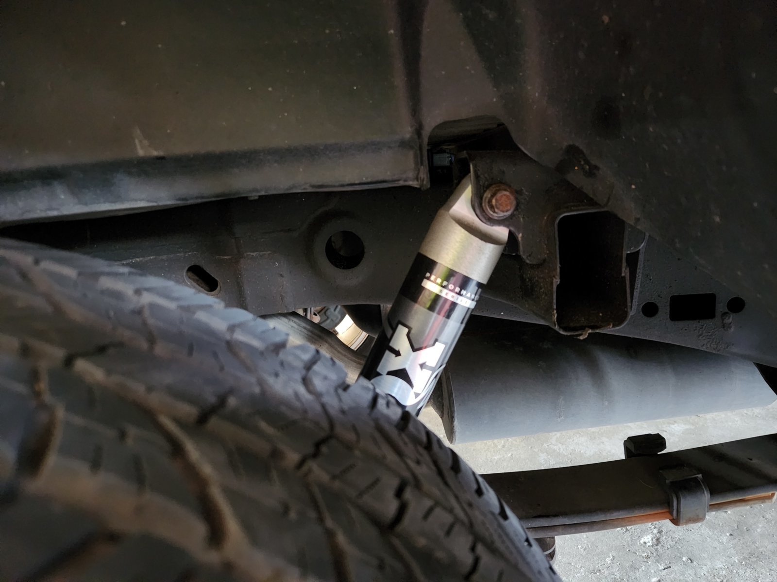

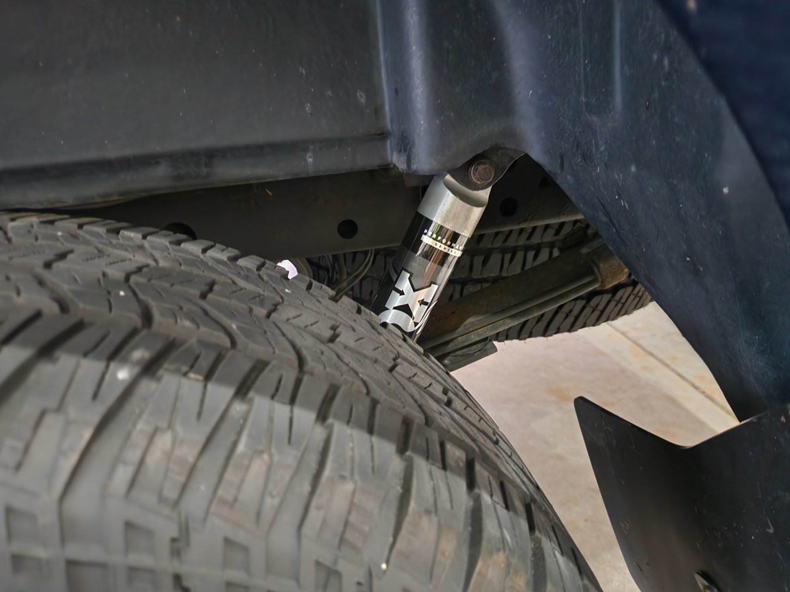

    Installed some 2.0s last night. So far I'm very happy with them!

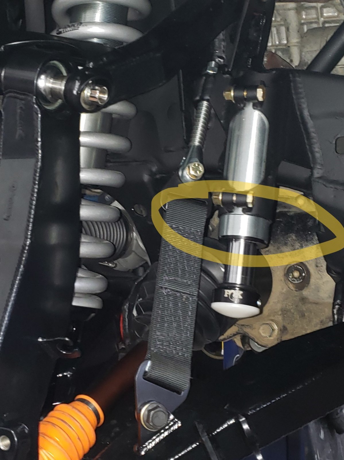

    @AccuTune Offroad can the bump stop be mounted in the can with a gap say 1/4" between the end of the can and the lip on the end of the bump stop?
    Also, what should the pinch can be torqued to?

    The pinch bolt style air bumps are not adjustable in position if thats what you're asking. The can rests on that lip of the shock body. I don't have a torque spec for those bolts.

    Yes, I would like it 1/4-3/8 of an inch further down.

    Are you trying to reduce up travel? Maybe for tire clearance reasons?

    Yes

    Got it. I have a few suggestions that may work.
    -You could fab a spacer/sleeve that goes over the air bump body taking up that 1/4 - 3/8 space
    -You could fab a 1/4 - 3/8 bump pad on the lower control arm
    -Trim inner fender/body more and maintain shock travel.

    Thanks for the suggestions.
    For now I'm going to use a spacer.
    Actually found some made out of hardened steel.
    They're made for a 2" arbor.

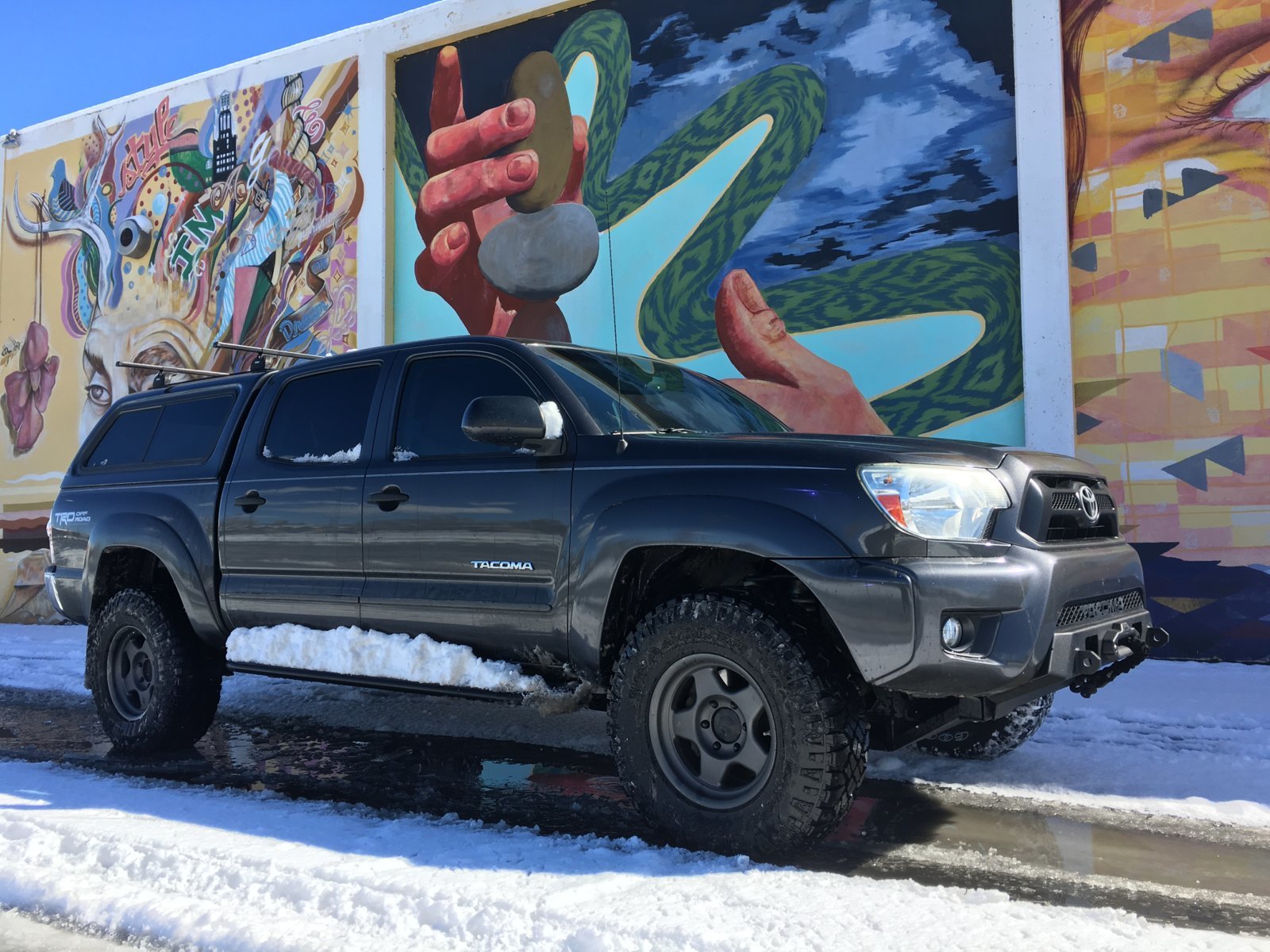

    This is my truck a few years back with a leer shell and the old style Dakar pack with the 3rd leaf removed (similar to the current medium duty pack). Fox 2.5 with factory preload up front. This is with an extra 120ish lbs up front and 265/75/16 tires.

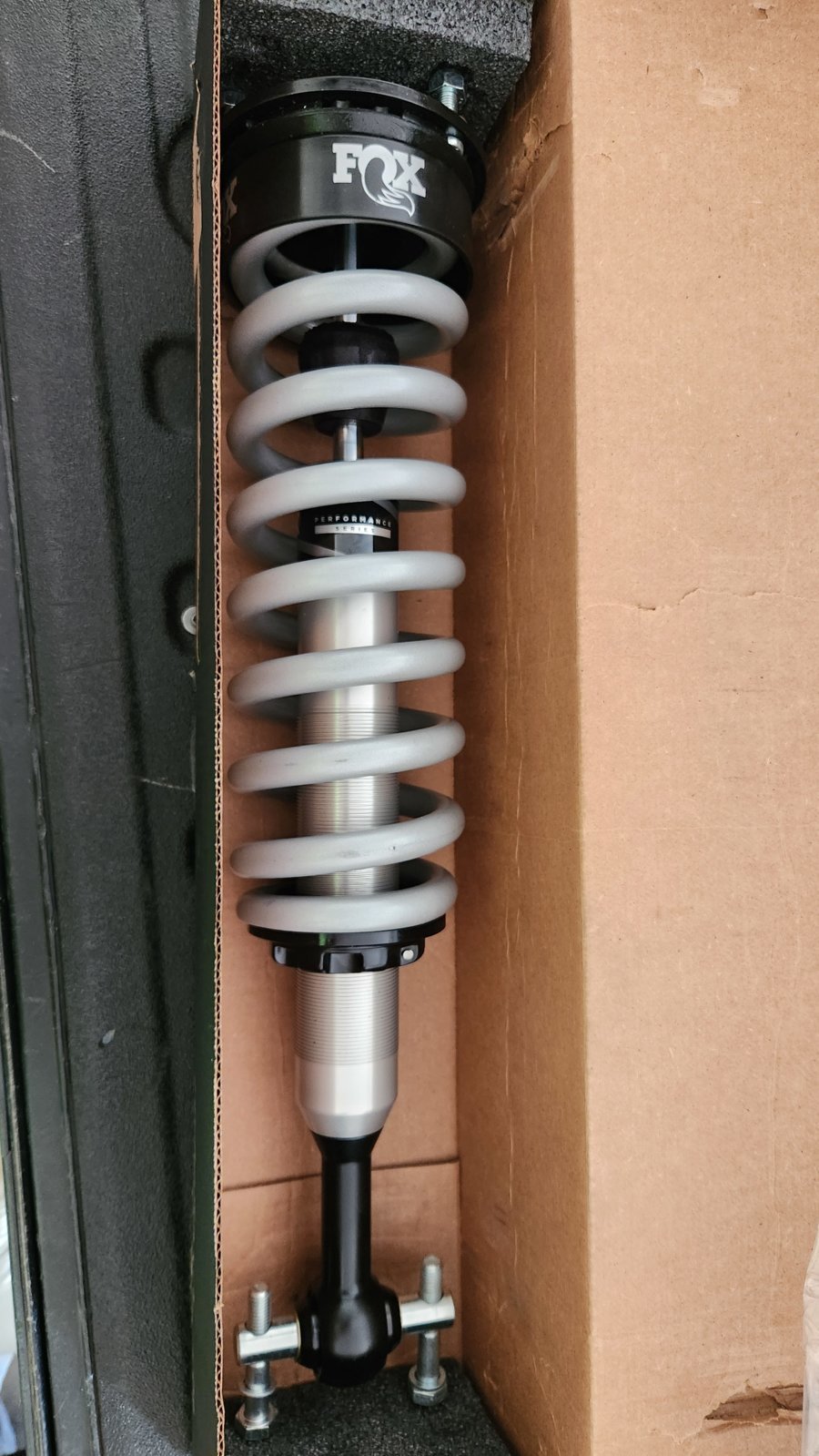

    Got these finally the other day! Getting installed at the dealer on Monday :bananadance::bananadance::bananadance::bananadance:

    Hey I got a question. My dealer just called and said my coilovers were missing the top nuts to install one of my coilovers. Do you have any way of telling me what the thread pitch and size is of the nut? My coilovers are #985-02-015

    Unfortunately I don't have that kind of data on hand. I would give Fox a call or hopefully your dealer can match up the nuts to source locally.

    I just called them and they were able to give me the number in like 10 seconds :bananadance:
