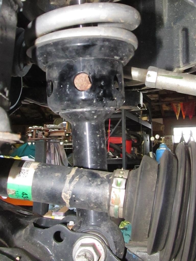

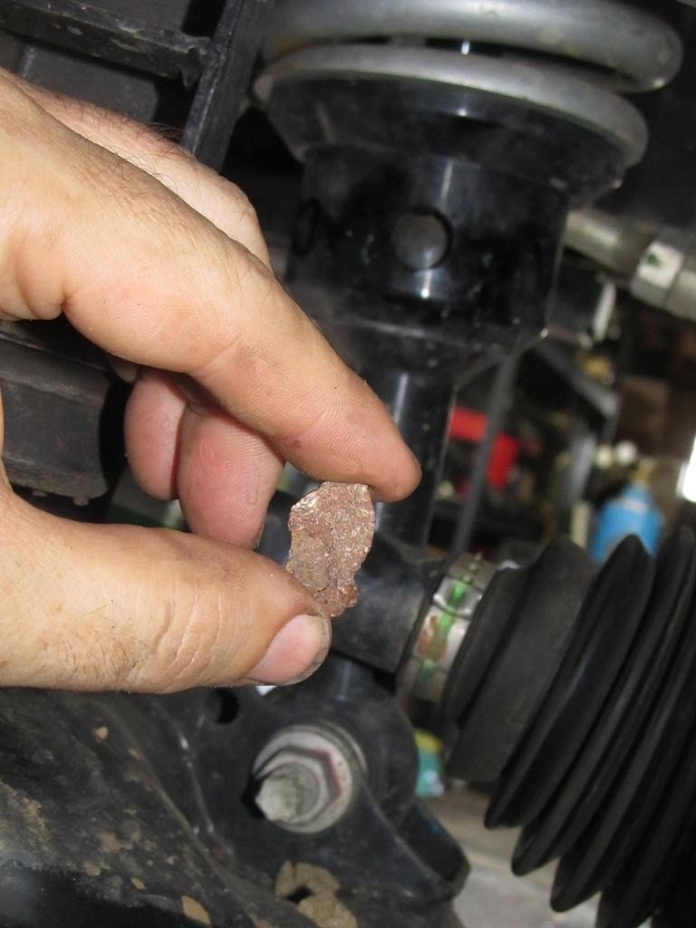

    Anyone else find rocks inside your shocks?
    Fortunately I didn't see any damage from this. Guessing I need some kind of a sock or boot or something to cover the springs with... What are some ideas?
    TXpro4X4 likes this.
