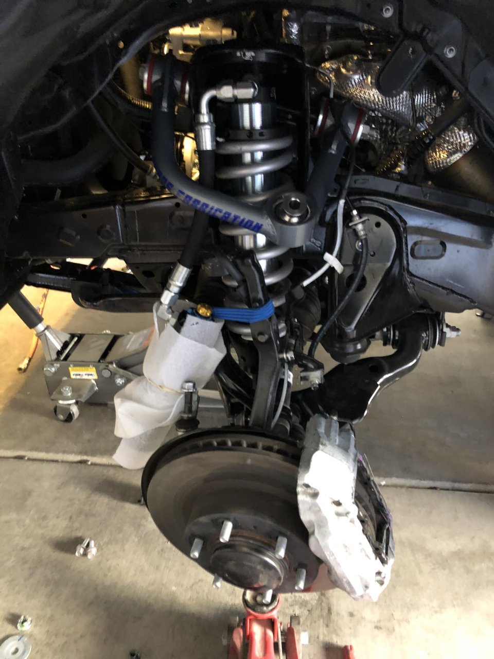

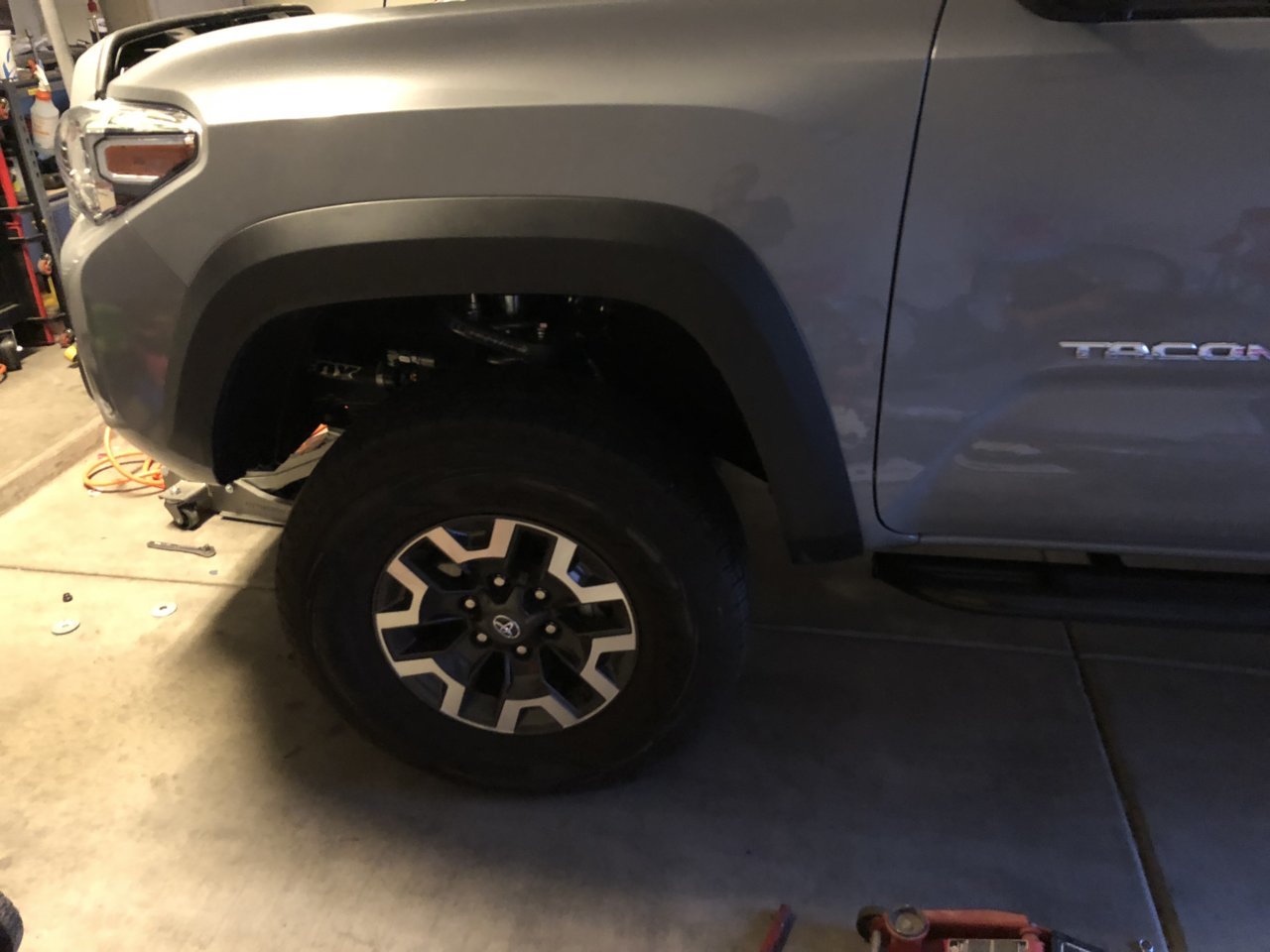

    Did the front on my 2018 last night, I still need to put on the progressive leaf pack, I left the height set to whatever fox has them set too, may need to raise it once the the wheels and 285s go on. The front end seem a bit higher then level at the moment. I’m hoping to avoid doing a CMC for a little while longer. I have -20mm 3.75bs konig counteersteer X 16x8 that are inbound from FNwheels and 285/75/16 duratracs to wrap them in.

    Y’all cranking them up a bunch to clear a 285/75/16?

    Sounds good, didn’t want to do a CMC but oh well. I’d like to not crank them up at all, I guess my offset with the wheel will dictate what I need to cut too

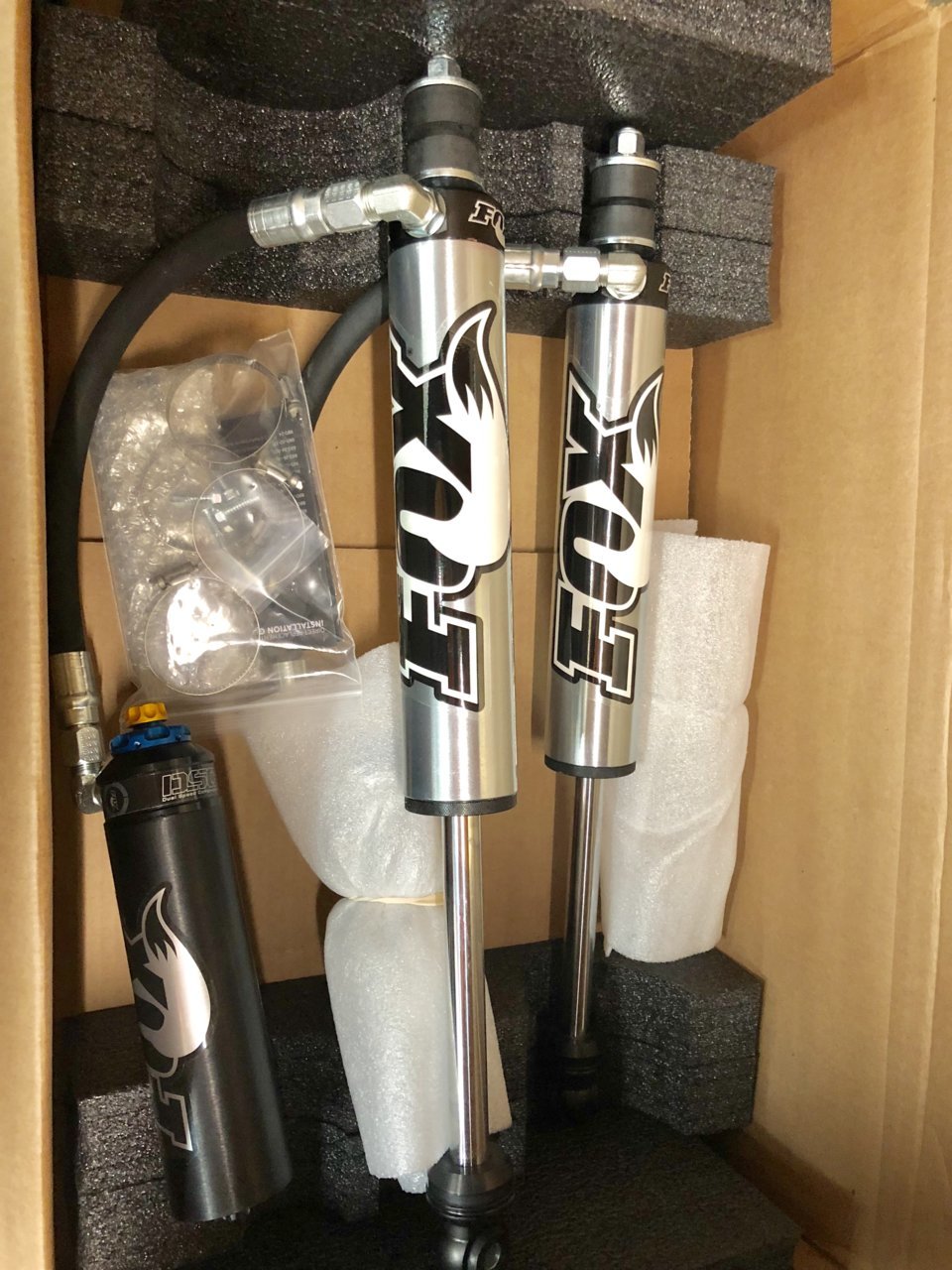

    Well these showed up yesterday 3 weeks early. I’ll try to get them on today if I have time. I wish I would have gone with 650 springs up front since I’ll be adding the honey badger bumper

    Look real nice bro.. if you don’t mind me asking, where and how much?
    650 springs are the way to go..
    Has your front settled yet?

    A bit over 1300 through vivid racing since i chose two day shipping. And the fronts seem fine
