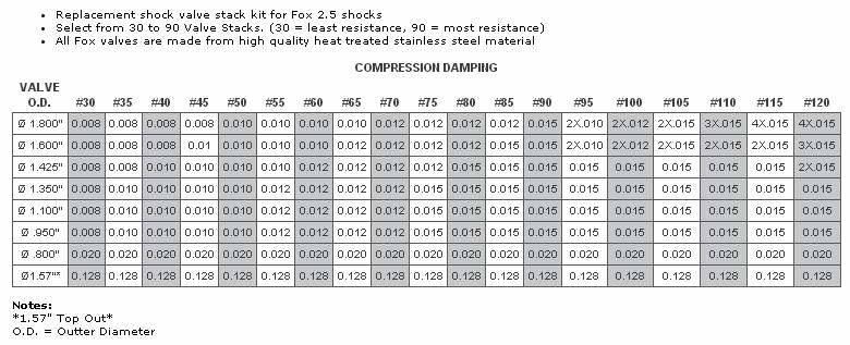

    Rebound is the same with out the 1.800 valve
    On one of my shocks they forgot to change the 1.800 valve and it still had a .008 shim so they come really soft....

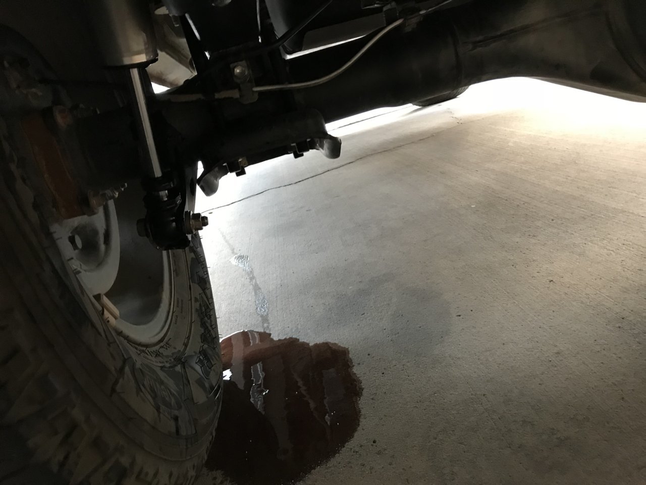

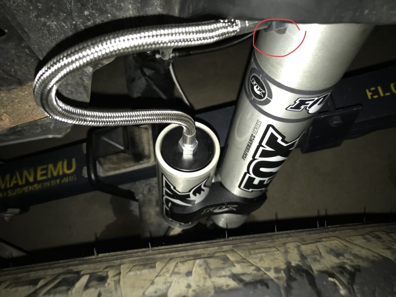

    Update: Looks like an install issue. Resi hose hit shock mount.
    Not impressed so far. <35 miles since install, all on pavement. What is the Fox warranty department like to deal with?
    985-25-118 performance series 2.0 remote reservoir with OME Dakar medium leaf pack.
    Noticed a weird oil trail into the driveway, look underneath and rear shock is pouring oil out. Leak was from where the remote reservoir line comes off the main body.
    Hopefully can get it swapped out fast.

    Looks like the resi hose is contacting your shock mount and that stress caused the failure.

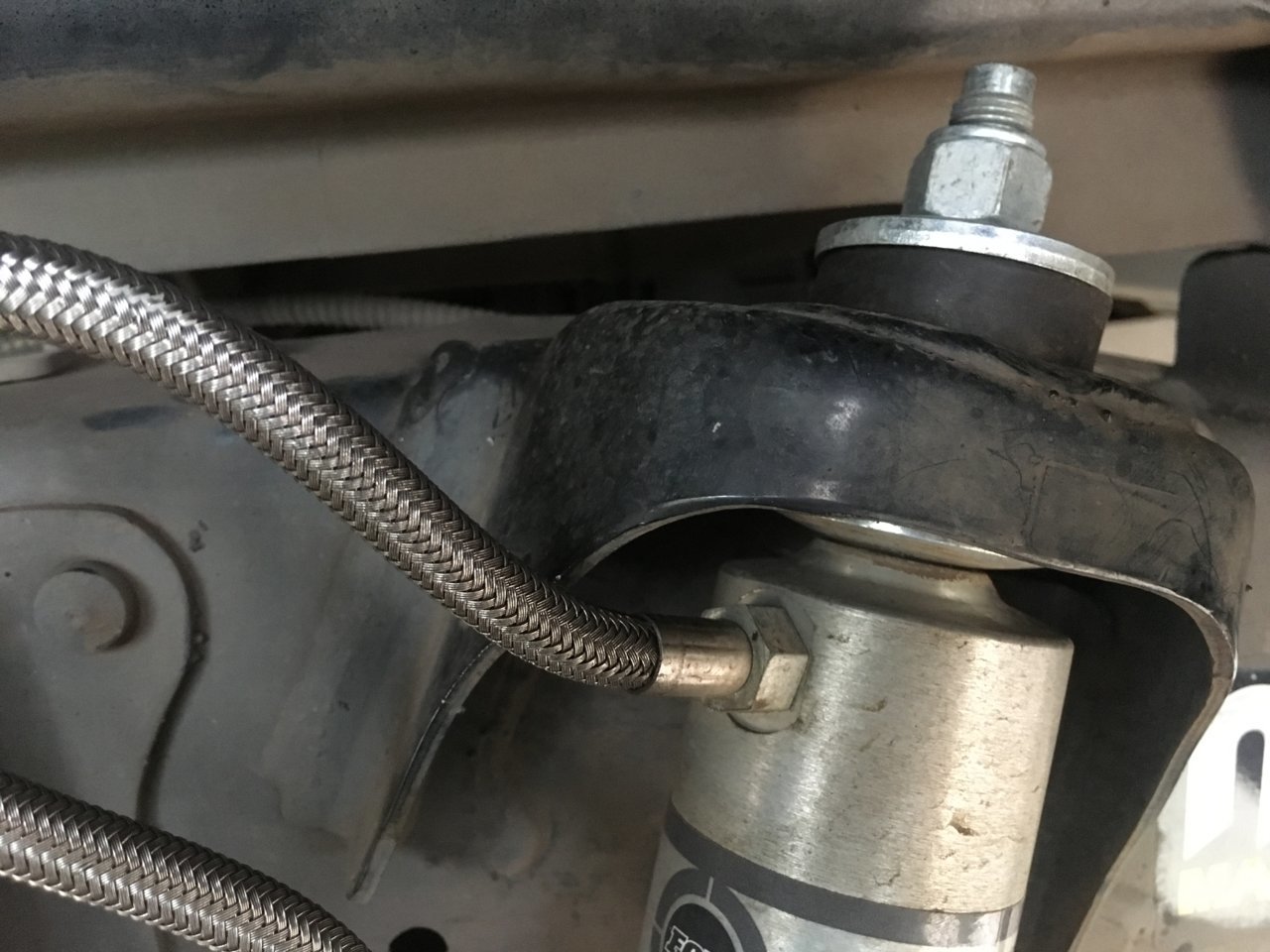

    Resi hose is touching your upper shock mount, definitely busted under compression. Here’s my hose, I made sure I had at LEAST 1/4” of clearance.

    Your shock is mounted without necessary clearances. The reservoir also needs to be moved 180 degrees.

    Thanks for the help guys. Now to talk to the install shop.

    I check mine often. The shocks can rotate even when installed & fully tightened. I grab it & twist it (difficult but doable) away from the mount when necessary. One day I'll trim that upper mount.

    Yeah, they installed that way too close to the mount.
