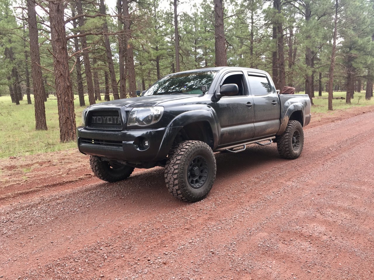

    With Fox 2.5 ext. travel C/O, Fox rear 2.0 RR and medium Dakar leaf pack. Extra weight is front plate bumper, Smittybilt 9.5 winch w/synthetic line (~40lb. over stock combo), SOS Sliders and rear plate bumper (same weight as stock plus hitch). Measurements taken from center of hub to bottom of fender flare with a full tank of fuel.
    Before lift:
    DF 19.75
    PF 20
    DR 21.75
    PR 22.120
    Lift initially gave me 2.75" up front (at Fox's max rec.) and 2.75" rear. I now have it cranked about 5 threads more than Fox recommended to get to the numbers below with the added weight.
    After 10K miles of lift installed:
    DF 21.5
    PF 22
    DR 24.25
    PR 24.5
    As you can see, I'm not anywhere near the 3" lift (actual lift in front now is 1.75") and will be going to 14"/650lb King springs as soon as I have the time to finish stripping the blue paint, reprinting them and then going somewhere to get the springs swapped out. I do all my own mechanical work/welding but I don't have access to a spring machine that'll remove/replace these coil springs.
