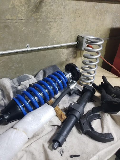

    9he8EOV7Fs1BOQk0WTMcX2bWYIk39MA6GuTzGb3I_eacde07bb2bd19b5574e7365fe11577ab385cb10.jpg
