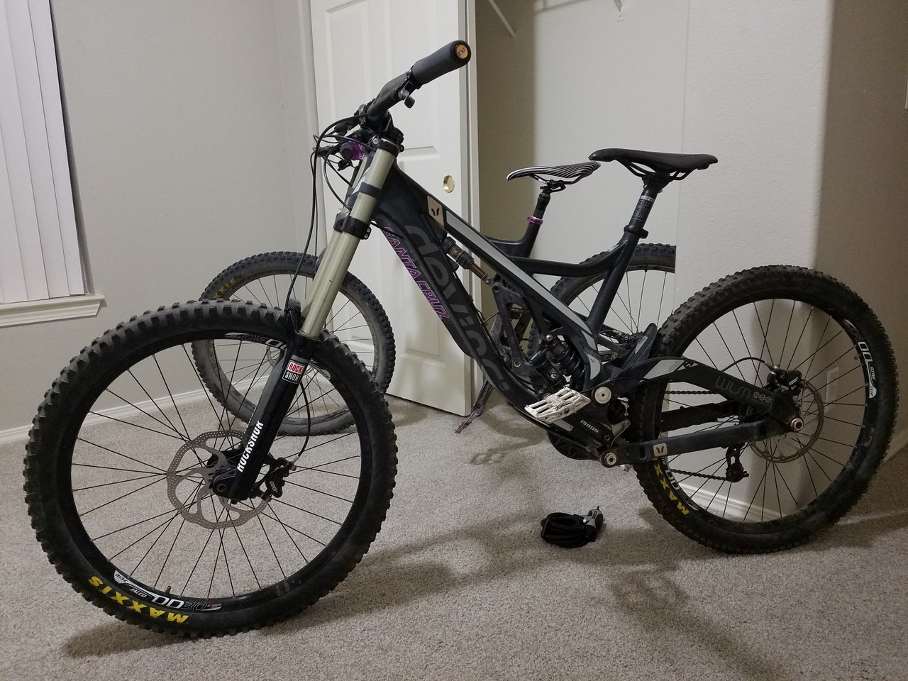

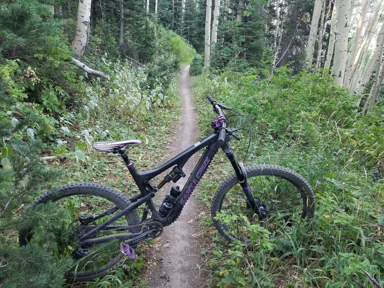

    Gunshot-6A
    Gunshot-6A Not a Fed
    Dec 29, 2009
    #28389
    18,959
    Conner
    Salt Lake City
    2015 TRD Offroad
    Me too!
    Fox Float X on the Bronson and Fox DHX on the Wilson.
    Tatts521 and jeff b like this.

    Nice whips. I haver Fox Float 36 and Evolv on the Fuji Auric and a old school fox float on the 07 Kona Dawg
