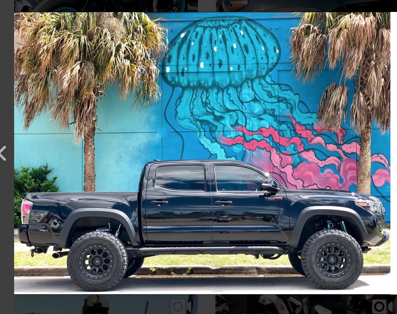

    Hey everyone. I'm looking at the stage 3 w/ either 3AAL or medium Dakars for the rear. I'm really trying to get a certain stance here like the picture below (yes, I know Andrew has Kings in this pic; don't kill me haha). I like the level look; I don't do any heavy hauling on a normal basis, maybe the occasional trip to the local dump. Will I be able to achieve this with the mentioned setup? I was also considering the 5100/OME 888 and Dakar route as well.

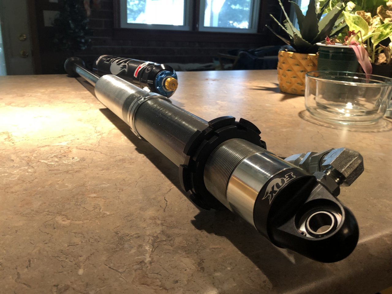

    What’s the easiest way to adjust the 2.5 coilovers? Do I really need the spanner wrench or can I use something similar that works better and or better price?
  19. Aug 4, 2018 at 1:04 AM
    #599
    abqnurse80
    abqnurse80 Well-Known Member
    Mar 27, 2017
    #214544
    987
    Nic
    ABQ, NM
    2012 FJ Cruiser
    Bilstein 5100 all around, first clip front. AVS window visors, BFG AT KO2s. JBL.
    Just be careful, but I've been using one of these the last few years!!! A few people have usedvarious screw drivers ground flat, etc..
  20. Aug 4, 2018 at 1:22 AM
    #600
    Slvr14tacoma
    Slvr14tacoma Well-Known Member
    Jun 25, 2017
    #222390
    621
    Mid travel
    2 punchs or similar tools is key like the ones posted above (cut off screw driver or whatever) with 5/16 diameter I believe. Its been awhile i forgot. Never used a spanner wrench but cant image it is better than this method. If you are looking at Coilover put them in holes at 4 o’clock (right hand) and 6/ 7 o’clock (left hand) approximately and you can get some good torque going clockwise if raising. A little lube helps. Best tool fit in holes helps to not elongate them
