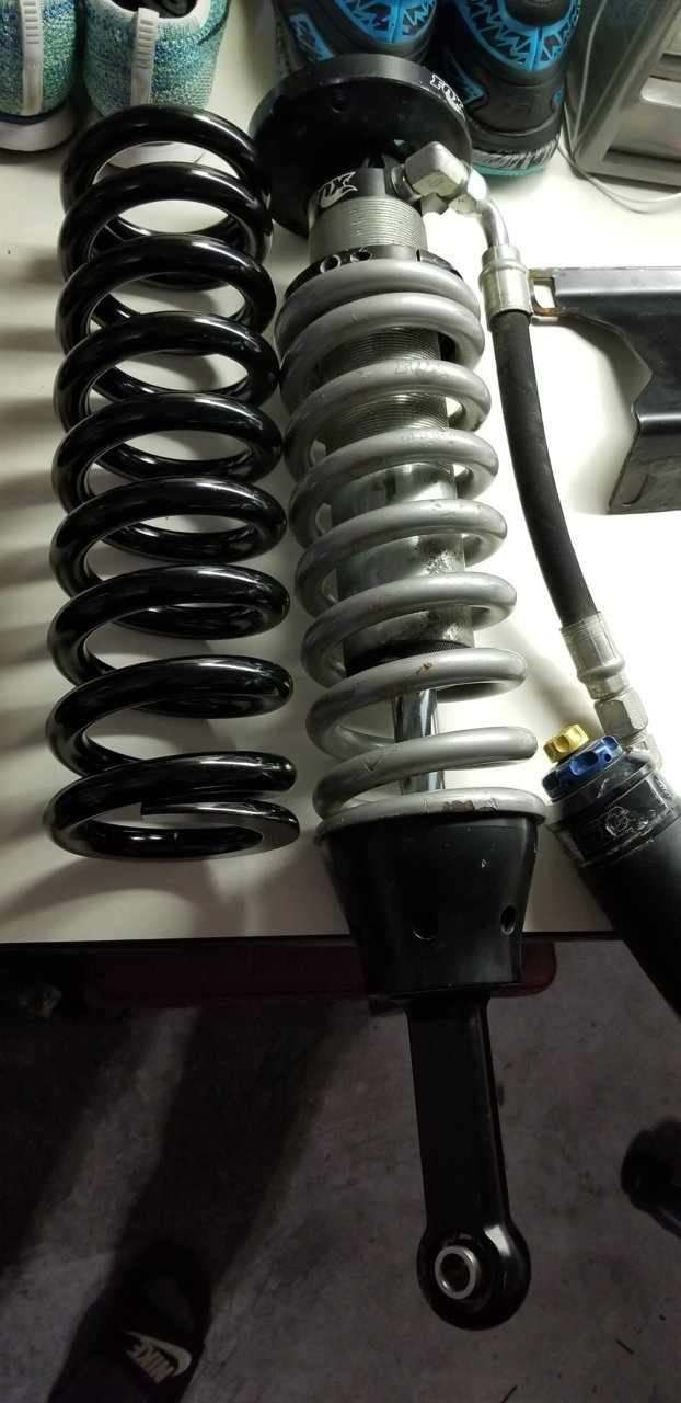

    how much preload should I have with a 14" 700lb coil on the 2.5 rr with dsc? I'm trying to net 2.75 inches.. 20180807_214202.jpg

    I'd imagine zero to very little bro.

    Just finished leveling my setup with the new Fox 2.5 DSC shocks. I'm running 14" 650lb coils and my measurements are 23" drivers side and 23.25" passenger; measurements are hub to fender. Driver's side needed a good bit more preload than the passenger side which I believe to be par for the course. The amount of preload is shown in the pictures below. Going to experiment with the compression adjusters soon.
    Driver's side.
    Passenger Side
