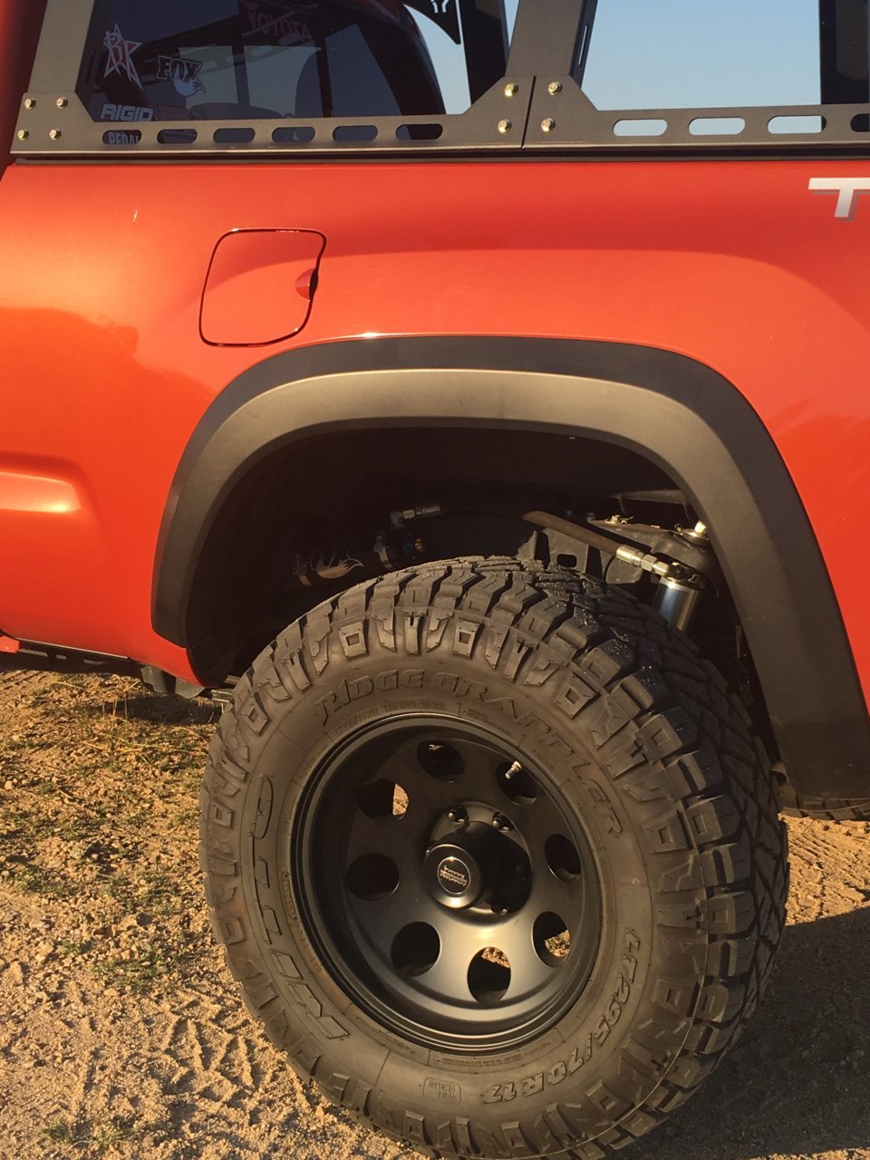

  4. Aug 12, 2018 at 9:52 AM
    #644
    Tacomamike mike
    Tacomamike mike Just that, nothing more.
    Sep 6, 2016
    #196650
    3,960
    Michael
    2017 DCLB TRD OFFROAD 4x4
    Working on it, dissent offroad racks, shift sense pro, pedal commander , ARB twin, rigid SS dually's , dual batteries, ARB fridge , 2.5 Fox coil overs wResi , 2.5 Fox rears w resi Total chaos UCA , deaver packs , Nitto trail grappler's 33" .
    5226B3B5-0F1D-49F0-AE9F-8DB98D7B3FF5.jpg These Fox’s are great! They eat up all the bumps !41FDB1E3-5EF3-48A3-A65E-C9911F13DB3B.jpg
    double_duez, RangerComa and Biggums like this.

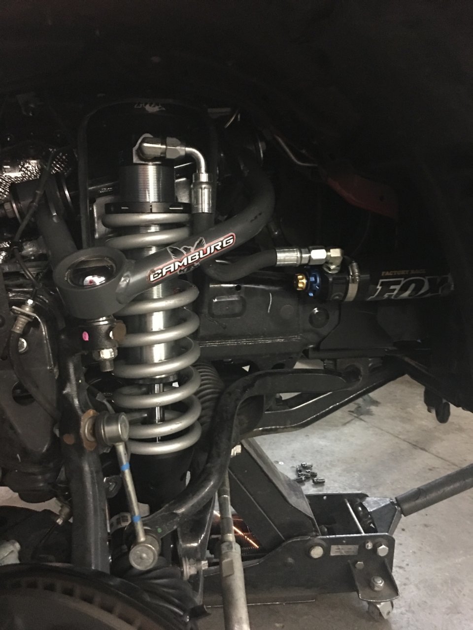

  13. Aug 12, 2018 at 10:23 PM
    #653
    el_toro408
    el_toro408 Well-Known Member
    Aug 12, 2018
    #262580
    59
    Aaron
    Southern California
    2017 Toyota Tacoma TRD Off Road 4x4
    Fox 2.5 Coil overs Fox 2.0 Rear Shocks Add a leaf 275 70R 17 BFG K02 Fuel Vector 17*8.5 +7
    Just had a shop install Fox 2.5 coil overs. They pretty much maxed out adjustment and I’m not a big fan of that. Can anyone link me to place that sells upgraded springs? I think the current spring is a 13” 600# spring. Think it would be nice to go up to 14-15” 650# Also from hub center to bottom of front fender I measure around 22”
    Any help would be appreciated. Thanks

  14. Aug 13, 2018 at 2:16 AM
    #654
    Tacomamike mike
    Sep 6, 2016
    #196650
    3,960
    Michael
    ^^^^^^^^^^^^ was thinking the same!!

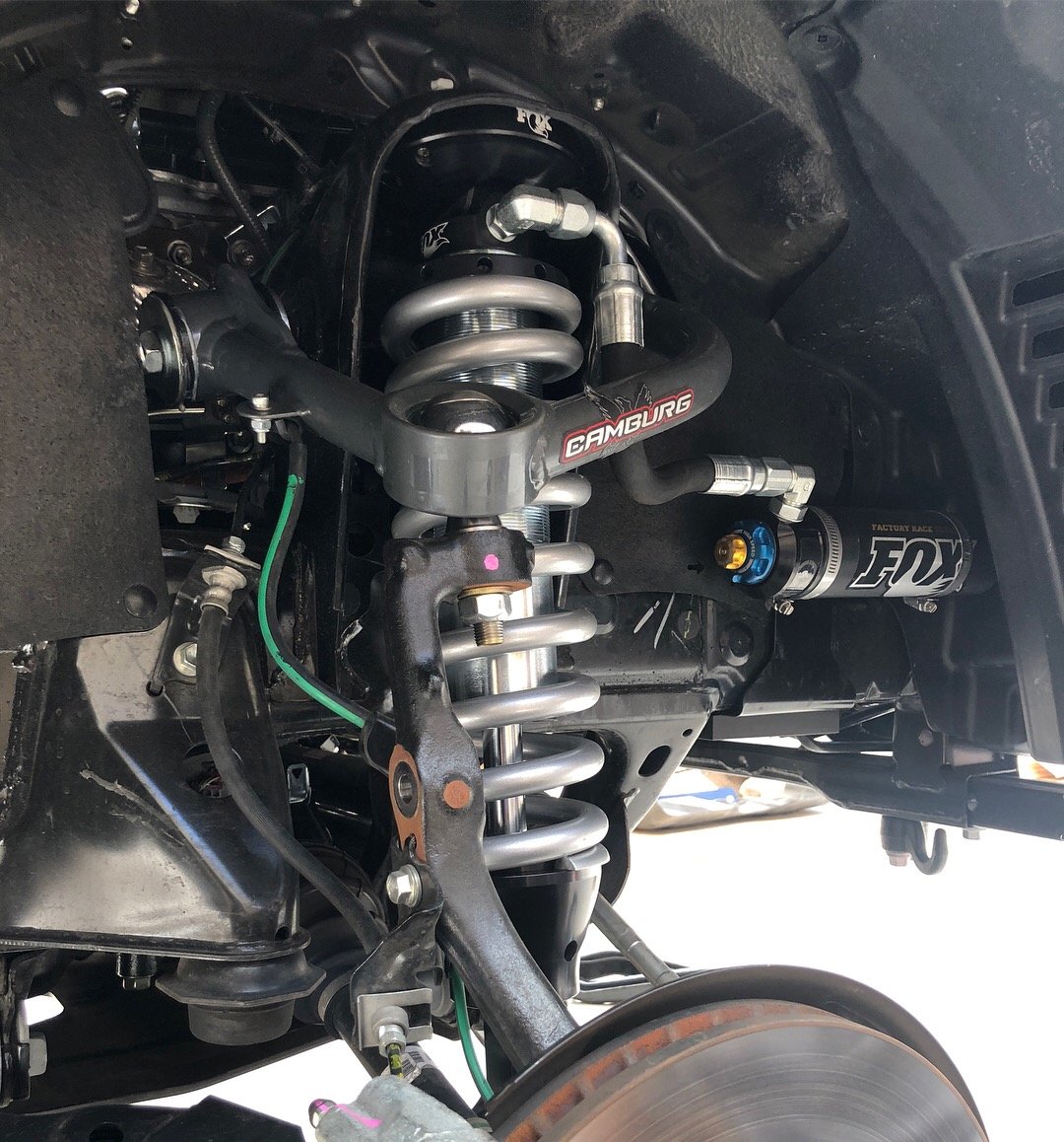

  15. Aug 13, 2018 at 4:42 AM
    #655
    ItalynStylion
    ItalynStylion Sounds Gooooood
    Jun 15, 2009
    #18467
    5,926
    Steven
    DFW, Tx.
    09 Double Cab TRD Sport 4x4
    Accutune Offroad setup my Fox shocks with a 14" 650lb Eibach coil spring. My preload is minimal for 3" of lift. They also custom valved them prior to sending them to me and they ride great.
    Taco1.1, *TRD* and MCDavis like this.
