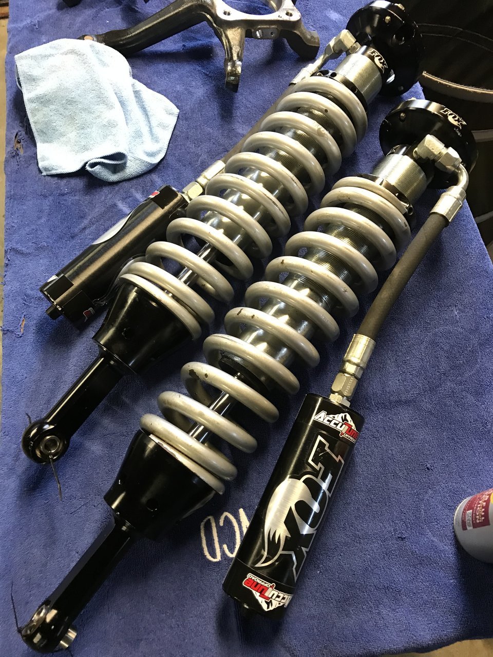

    If I told you what I paid for em...you’d hate me. And yep, extended, a loooooong way. Full length for my 6” drop bracket!!
