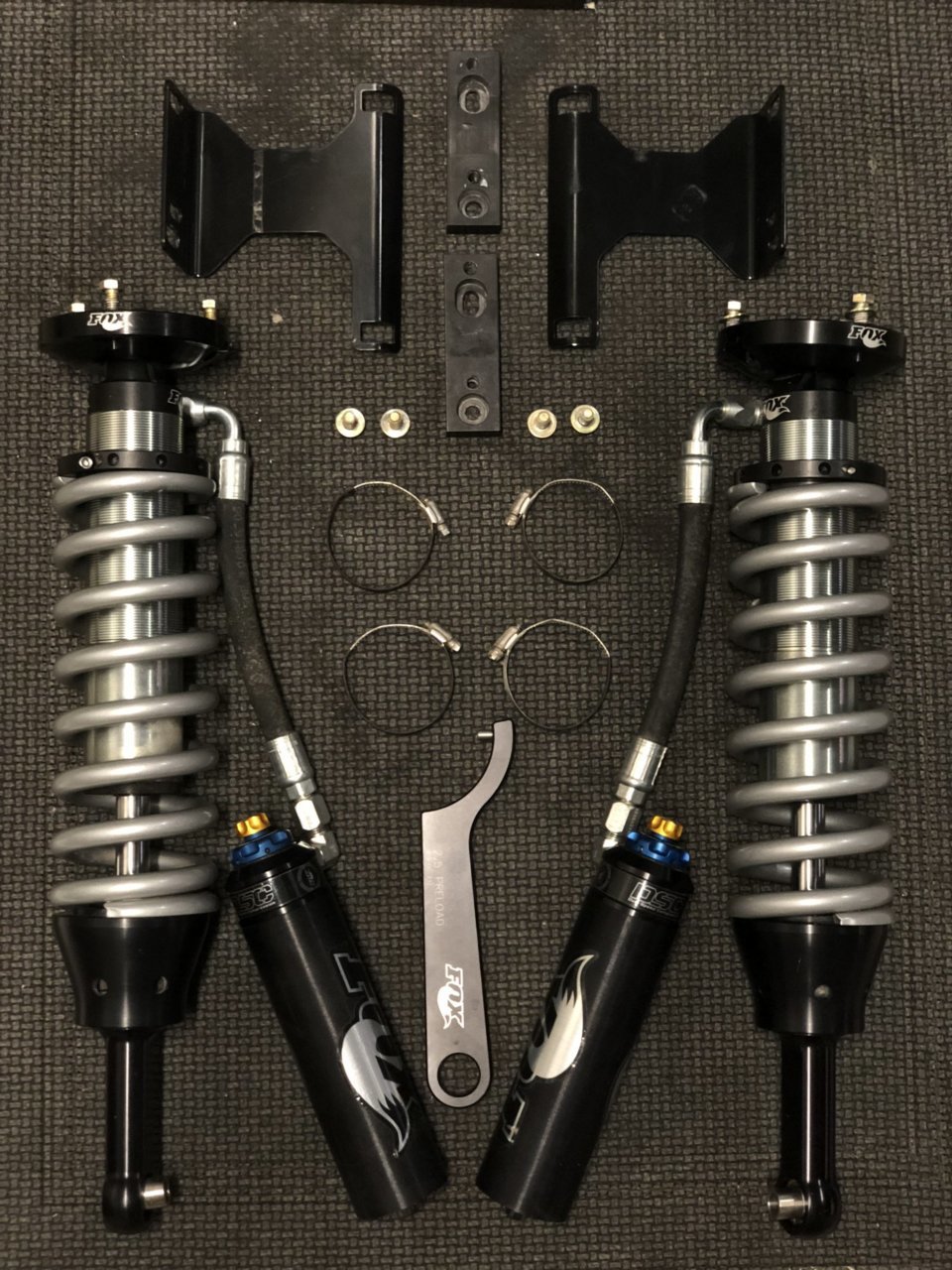

    18 TRD sPort 4x4 (11mgmsport)
    oem pro grill 17” pro rep wheels Fox dsc shocks

    you will like them, they ride well once dialed
