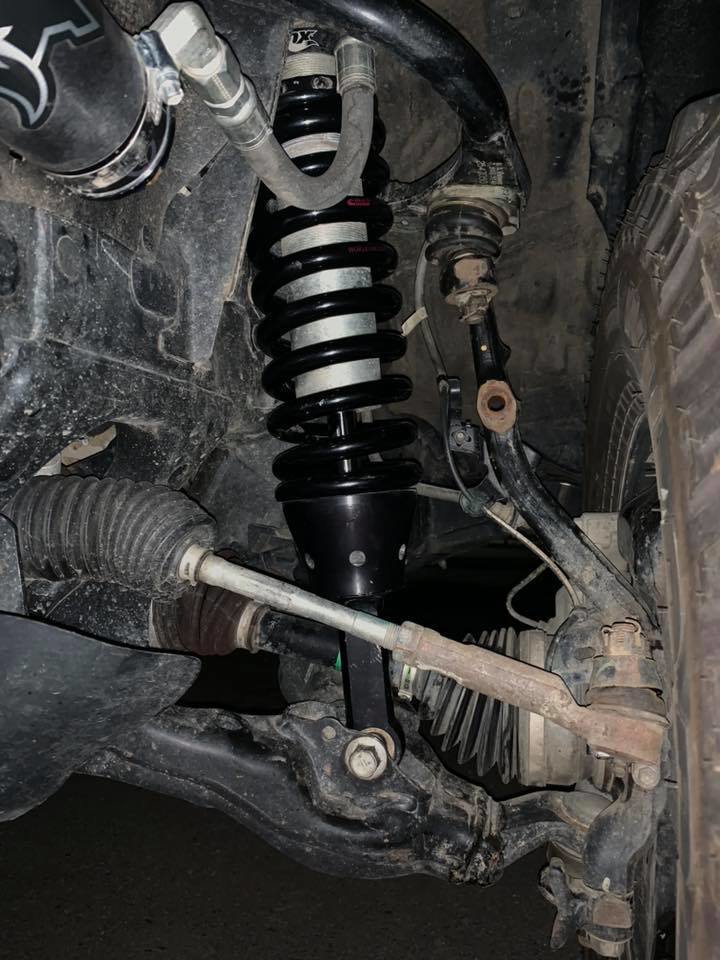

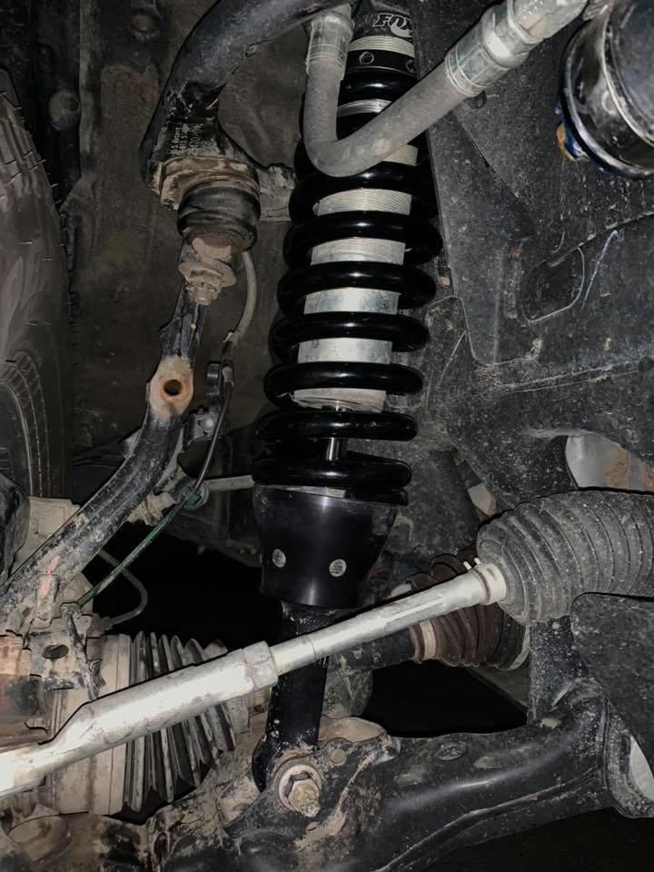

    seems to run decently... i'm just wary of tearing CV boots..

    Looks great man, enjoy it more and worry less

    Your CV boots are fine. As long as you're within 2.75"-3" of lift. Plus those bad boys will settle.
    Catfish21 likes this.

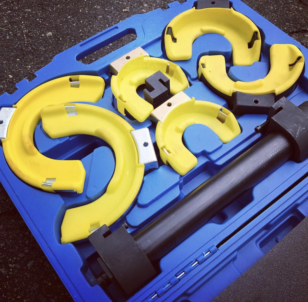

    I got the same compressor, works good. This was the only way I could adjust mine 2.5ext coilovers. Tried with a punch on the truck and lots of lube , no go. Punch with a short pipe= bent punch.
    Biscuits and MCDavis[QUOTED] like this.
