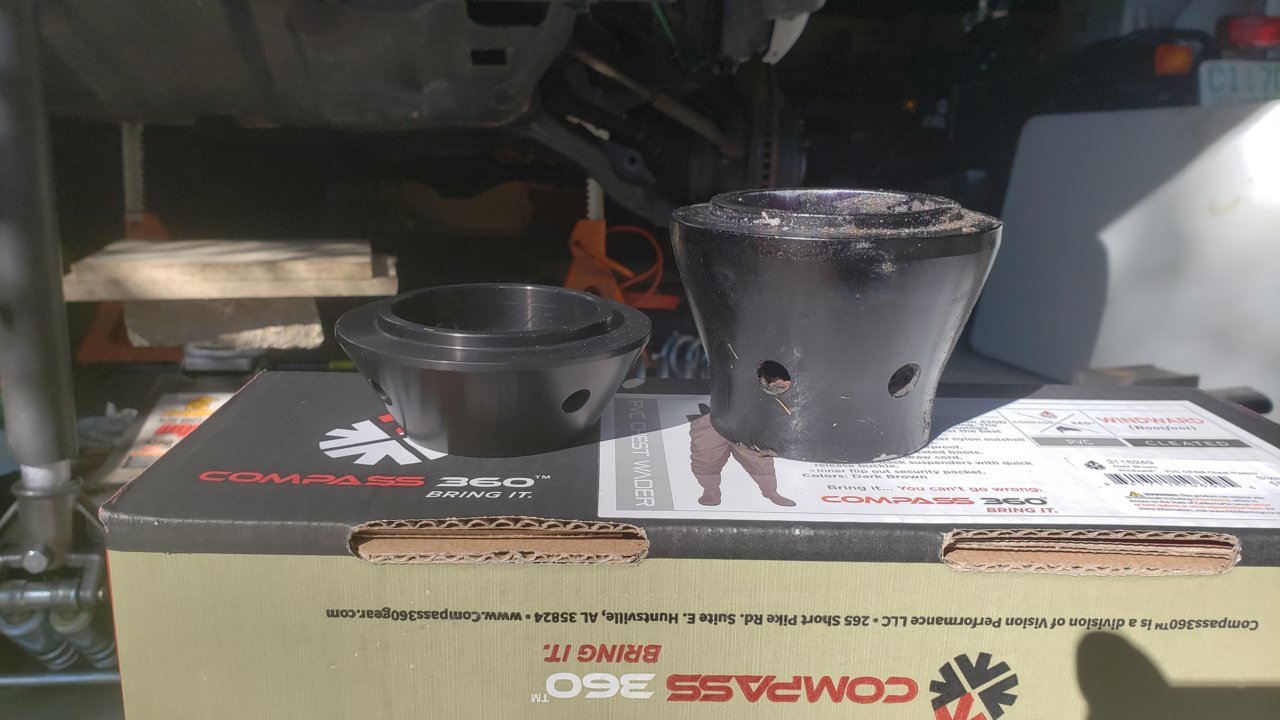

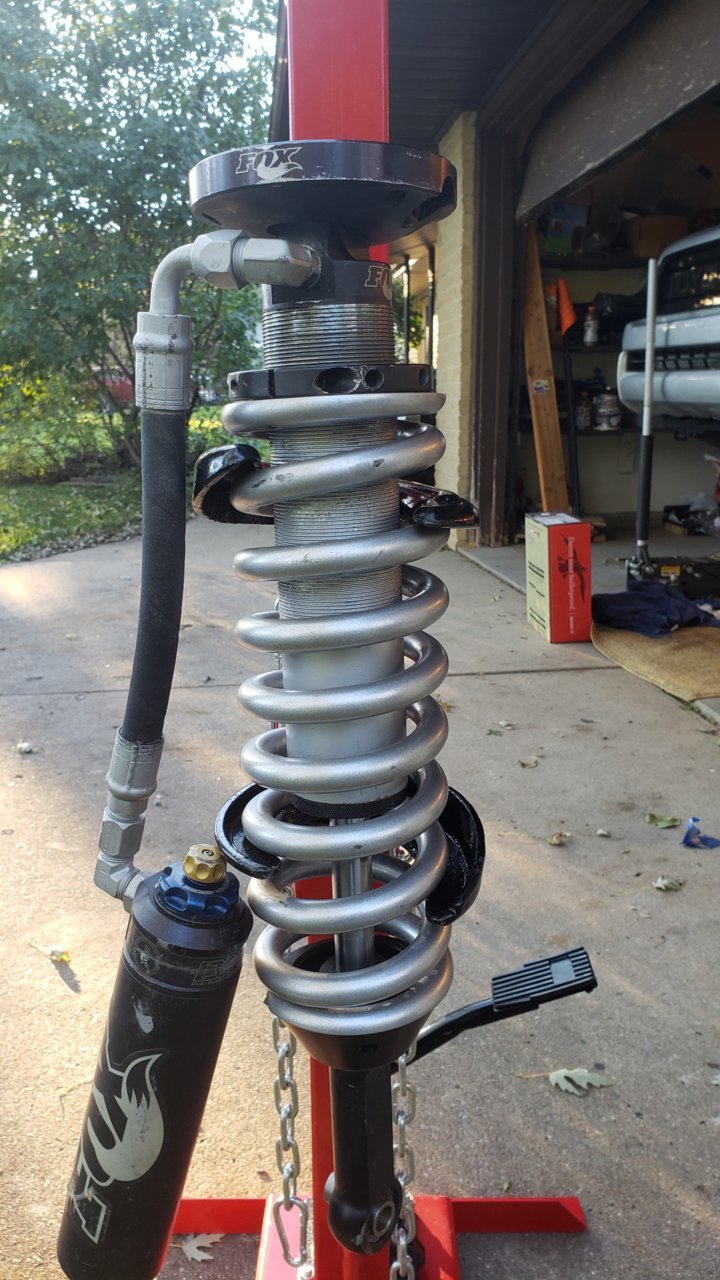

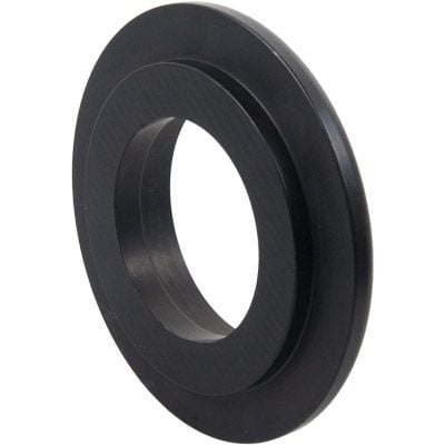

    Yeah the 600 is on the light side, for more than 2" of lift the preload is crazy and you can hardly turn the adjuster.
    With the 650 it much easier to adjust be cause you use less preload.
    Now if I can get the spring back off....... That's the problem I need to do another tweak on the valving and getting that spring off is a b****...
    I popped of the 600 not too bad now I'm having trouble getting the 650 off and there are no shock guys in WI....
    Think I'm going put in shorter lower spring retainer, so I can get them apart easier...
    I'm thinking of putting in the 1.6 length... If everything clears...

    These guys use the flat one to go from 14" to a 16" spring for a chevy...

    Won’t that cause you to have to make a bunch of preload again?

    I will have the same preload(tension) but it be lower on the threads so I will have to screw the collar down more but I will also be able to back the collar off so get the spring off easier. will give me anther inch or so to loosen it up..
    I have to test it out....
    I do know these spring tools max out on the 650 spring with these shocks... A little scary.... I need to get a clam shell spring remover, seams to be the best, but another $200...

    This spring compressor is a good option. High quality and heavy duty.
    Specialty Products 40260 Universal Spring Compressor https://www.amazon.com/dp/B0039K4AJA/ref=cm_sw_r_cp_apa_JWsWBbQTBXE1H

    I wouldn’t even try it with those! Maybe use 2 sets at one time?

    Yeah, those can only do so much.. Regular shops won't or can't get the springs off. I have a truck guy about 45 min away I can try next week.
    That's why I'm going to try changing the lower retainer so I can back off the spring and get it out easier...

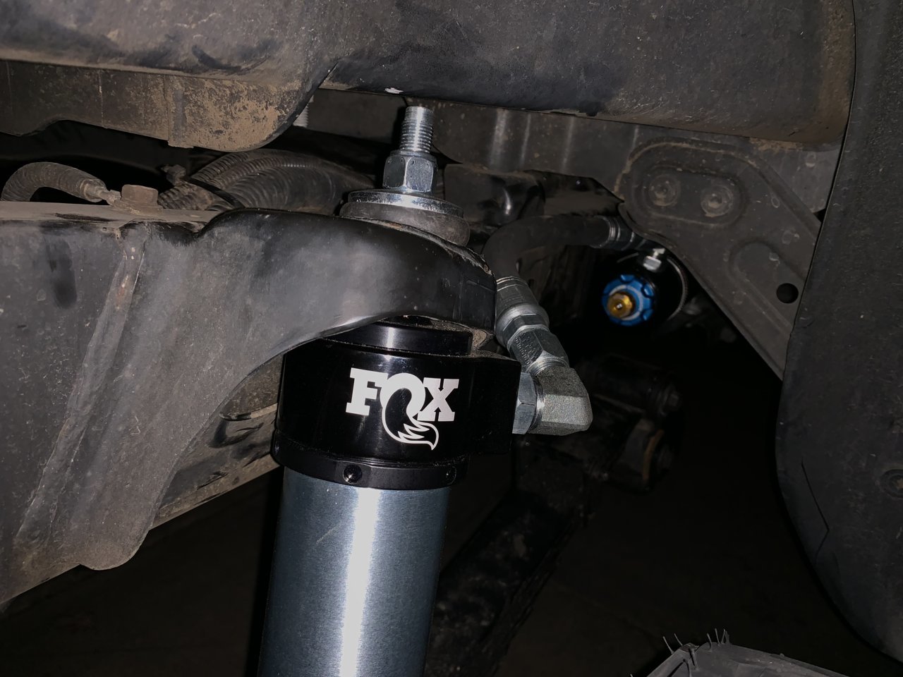

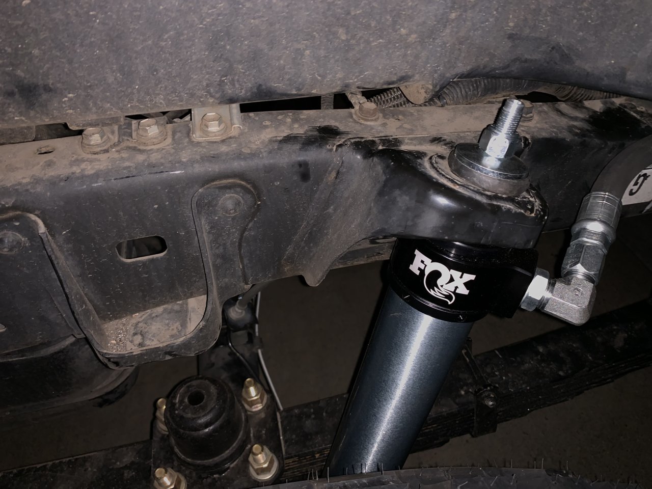

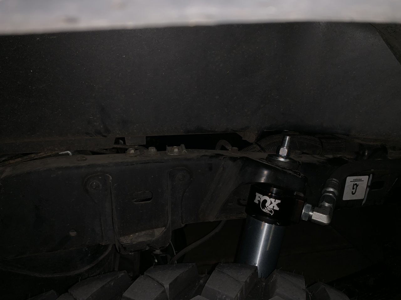

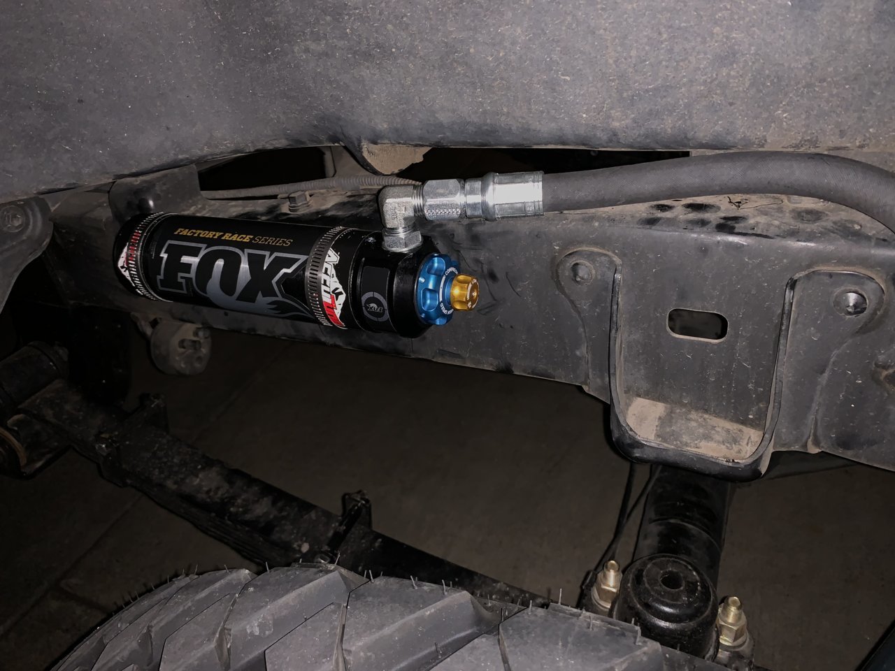

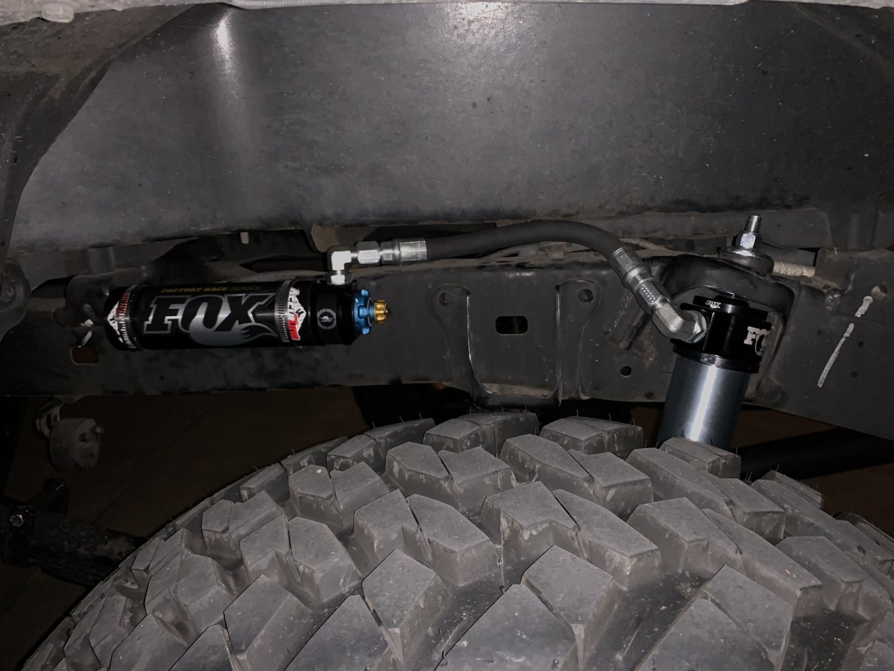

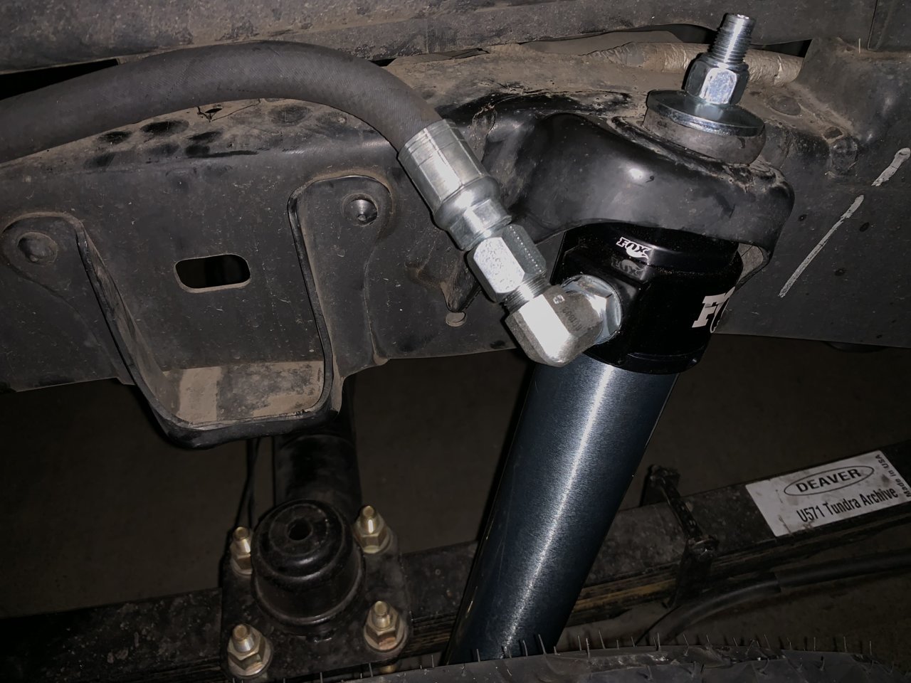

    Just installed my Fox 2.5" Remote Reservoir Rear Shocks, DSC - Thanks to AccuTune Off-Road, Inc
    Passenger Side
    Driver Side
    They both are placed towards the Rear of the truck but I’m not really liking the Driver Side mounting location. I decided to come on here and see if anyone had the same issues and it seems like many do. I did see a couple other mounting locations I may try myself.

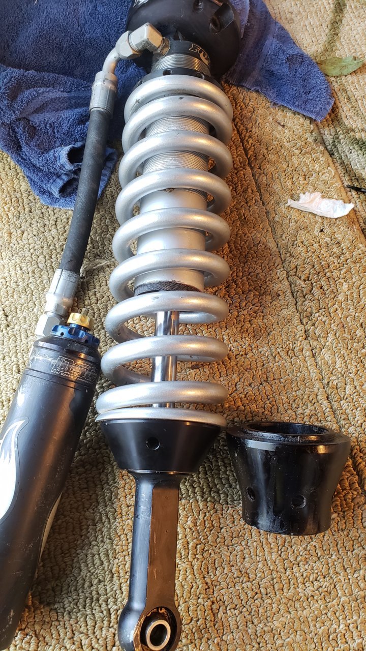

    Getting the shorter lower retainers worked perfect, 2 day shipping from poly, my weak Amazon spring compressor worked like a champ because I didn't have to compress the spring so much, fits and clears everything and had enough good threads to get the same adjustment.
    So instead of having the collars down 3/4" I have the crank them down 2" but the first 1" is free play on the spring compressor.
    I'm so happy, I now I can pull my shocks apart to revalve or rebuild with no problems..:D:amen:
    Of course I think I may have my valving set now....
    Cheap amazon spring compressor had more than enough with the shorter retainer and was maxed out with the std retainer.
