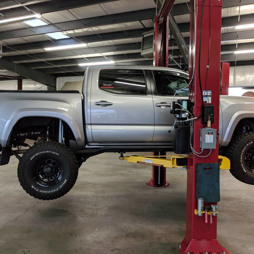

    I second... Spring under is definitely the way to go. 14" fox bypasses for mad droop IMG_20180731_095859_059.jpg

    Yeah I went with the archive garage kit because they spec'd up to a 14" bypass for it without having to operate on the bed. Love the clean look while still adding an insane, almost ridiculous amount of capability for a stock looking truck

    Archive garage hammer hangers with the long SUA shackles, Archive SUA kit with raised air bump strike pad, and deaver SUA heavy duty expo leaf pack. Pack is a little stiff but very comfortable ride at stock weight but I have plans for a roll cage and bumpers and already have a beefy skid plate and sliders so it should be perfect and hopefully will wear in without sagging much!
