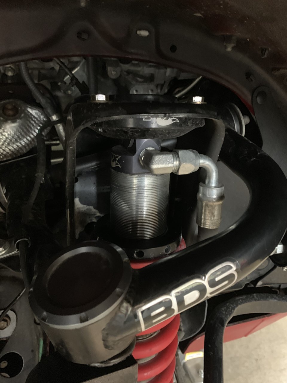

    Hmm. I wonder why because mine are probably cranked more than most people have theirs cranked.

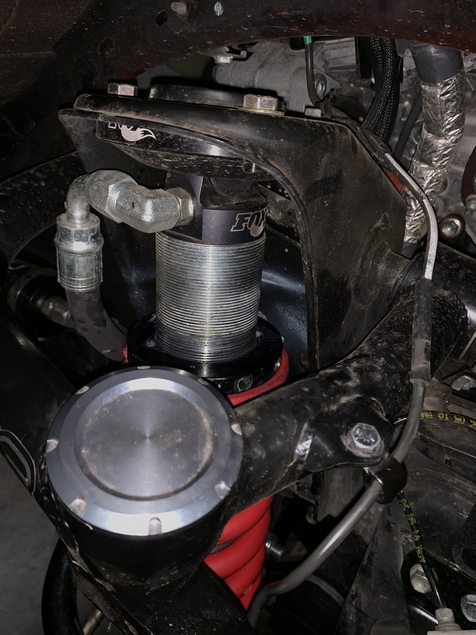

    that seems like a lot of preload

    Drop bracket lift, so that’s a longer coilover and just appears to have more preload.

    Yep, drop bracket here too and I have 2.5" of exposed threads. Still a long way from coil bind.

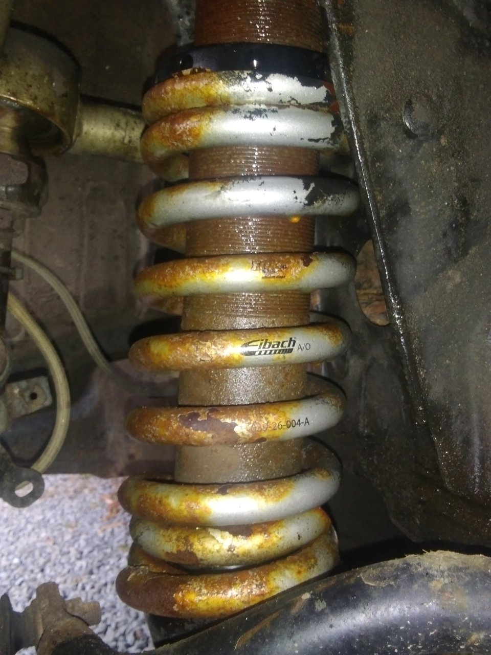

    Call Eibach again today about the spring failure on the Fox 2.5s, long story short they dont Warrenty or offer discount on broken springs that were made for Fox.
    Nor do they sell replacements in the needed size.
    4 years old in Pa

    Wow, that's in rough shape!
    We have a bunch of those springs here that are take-offs. 13x3.0x600 are $20/spring + shipping.
