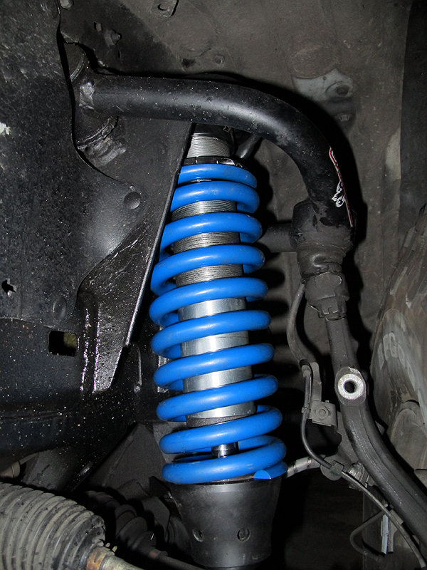

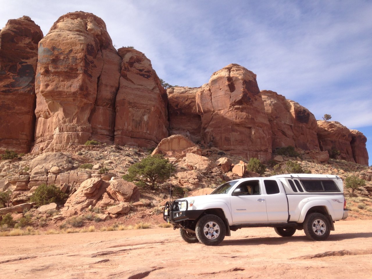

    DaveInDenver
    DaveInDenver Not Actually in Denver
    May 18, 2013
    #104390
    3,595
    David
    Grand Junction
    2008 Super White TRDOR AC 6MT
    Unexceptional
    Actually, yes, just took this about a month ago. The front is 650 lb/in King coils set to ride at about 23" from hub center to fender lip.
    The rear is standard CS047R leafs but I've since rebuilt the rear packs to put in an extra leaf to bring the back end up a bit. I don't have an updated photo yet, though.
    austin2009 likes this.

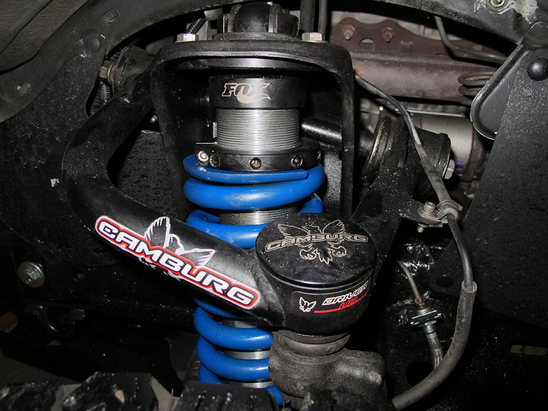

  14. Dec 11, 2018 at 3:51 PM
    #1054
    austin2009
    austin2009 Well-Known Member
    May 28, 2015
    #156258
    711
    Austin
    Boise, Idaho
    Lifted and Locked 09 2.7L 2TR 4x4 5 Speed
    DRIVETRAIN- -4.56 Nitro gears -ARB rear locker -SPC UCA's -Fox 2.5" RR fronts/650lb coils -Bilstein 5100's rear -1.5" AAL -285 BFG KO2’s -16x8 MK6’s ARMOR- -ABR bumper -BAMF LCA skids RECOVERY- -Smittybilt XRC 9.5k synthetic winch -ARB OBA STEREO- -Pioneer head unit -Rockford T series speakers -Rockford 500 watt amp -Rockford P2D4 8" sub LIGHTING- -Calirasied ditch lights -Caliraised amber fogs -Hella Black Magic’s -Blue Seas fuse panel
    Are your fronts the extended travel? Did you get 3” of lift out of them?
  15. Dec 11, 2018 at 4:06 PM
    #1055
    DaveInDenver
    May 18, 2013
    #104390
    3,595
    David
    Grand Junction
    Unexceptional
    I have extended travel, standard IFP no-reservoir shocks and I have Camburg ball joint UCAs. I have the driver side collar set about 1.5" down the body and the springs sit compressed to about 11.5" from their full 14" length. I could probably turn the collar down farther on the body if I wanted to push the front end up higher but I wasn't after 3" of lift.

  18. Dec 11, 2018 at 5:00 PM
    #1058
    DaveInDenver
    May 18, 2013
    #104390
    3,595
    David
    Grand Junction
    Unexceptional
    @austin2009, as it sat in that photo it was pretty much level with a roughly 300 lbs camper on it. It squatted a bit full loaded, which is why I ended up putting the D29XL in the pack. With nothing in the bed and the camper on it sits at about 24" hub center to fender and it squats about 1/2" to 3/4" or so with my normal camping junk.
    I run IFP 2.0 rears, also no reservoirs. I wish I had rebound adjusters I guess, but ultimately not sure if I would have done reservoirs or 2.5" no-rez shocks if I had it to do over.
    I'm very happy with the ride over all, loaded and unloaded. I might need to tweak the rebound damping (it's kind of harsh coming off sharp steps) in front but otherwise definitely satisfied.
