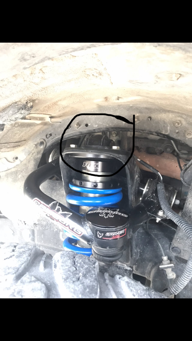

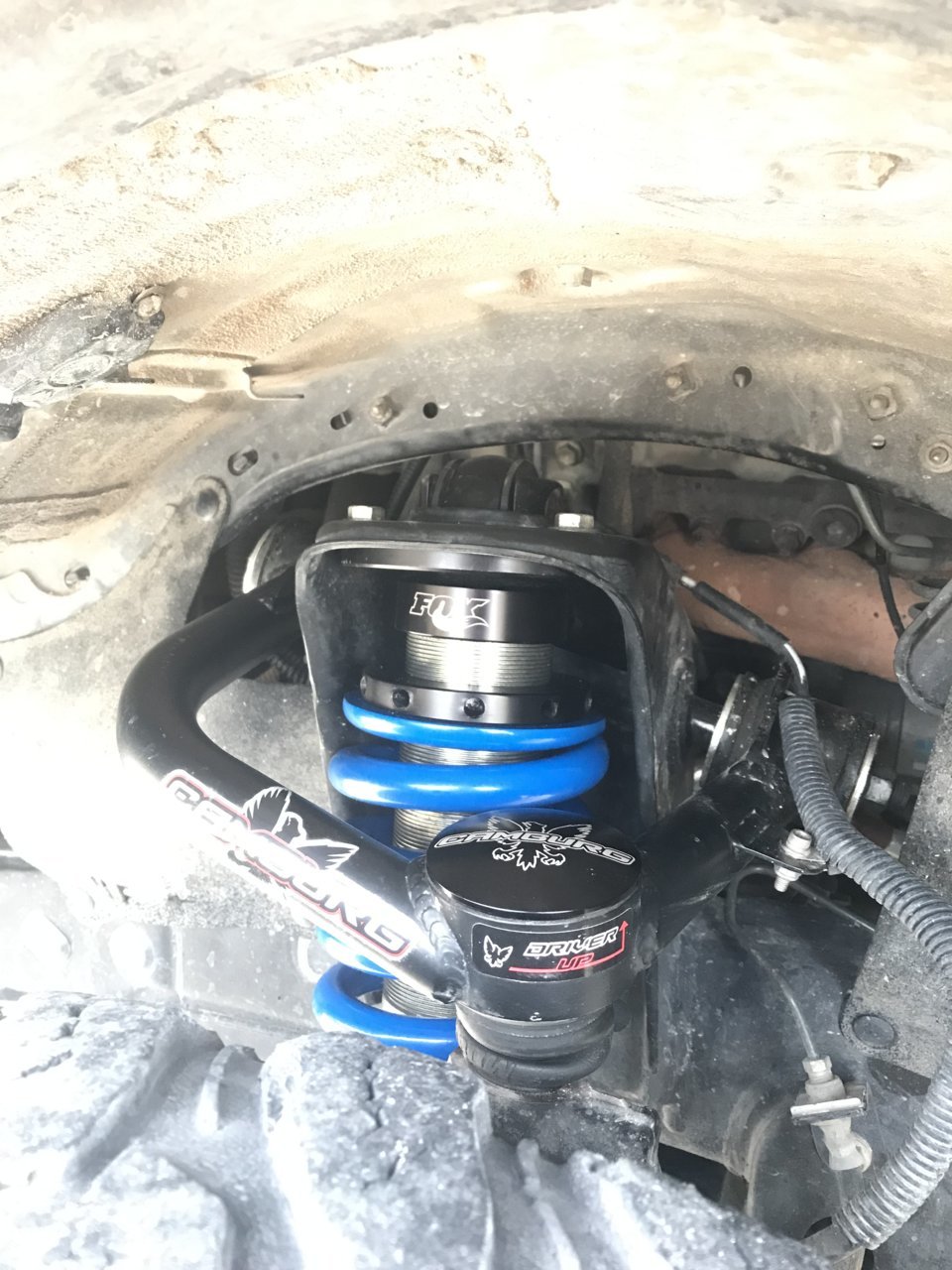

    Alright I got a question for you fox gurus. I recently bought a set of of the 2.5 ifp coilovers about 2 weeks ago and just found out they were rebuilt by accutune after getting taken off the previous owners truck. I bought them with the 13” 600lb coils on them as the previous owner didn’t have any extra weight up front. Anyways, I put the king 14” 700lb coils on the other day and it’s a hell of a difference without having the massive preload with my fully armored truck. Anyways, I’ve been wondering why the shock body is mounted thru the coil bucket rather than most fox 2.5 c/o’s that I see and are mounted below the mounting point in the coil bucket. Is it an IFP thing, updated design? or whats the difference? Included pics of my setup and pic of what I’m talking about
    Edit:mine are ext travel344E8AC4-9863-465C-96FB-BF91D62DA127.jpg6411AE83-7C4B-4F02-91C7-328A948C59AA.jpg

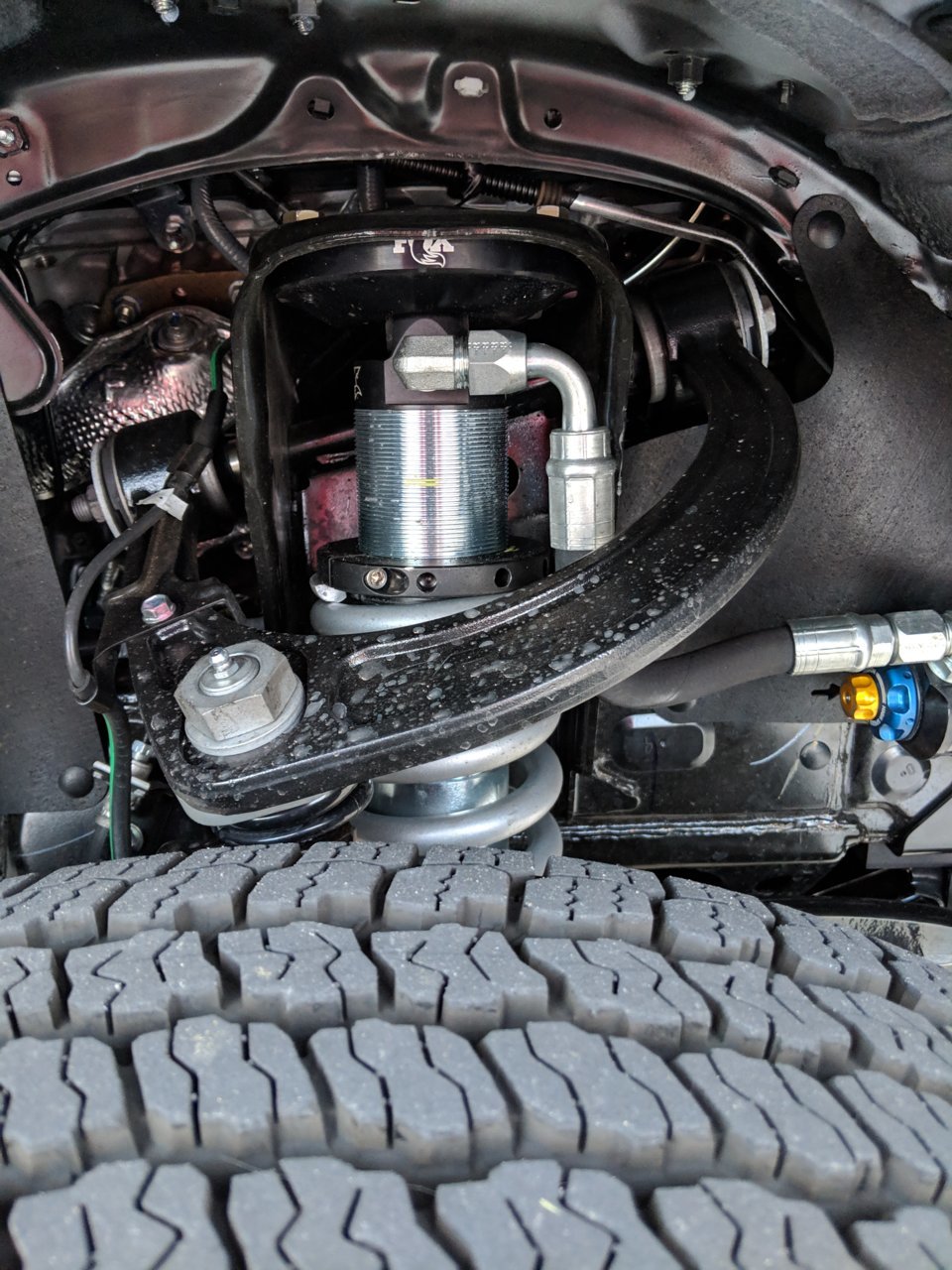

    mine has a small hump but not as big as yours, maybe difference with reservoir models

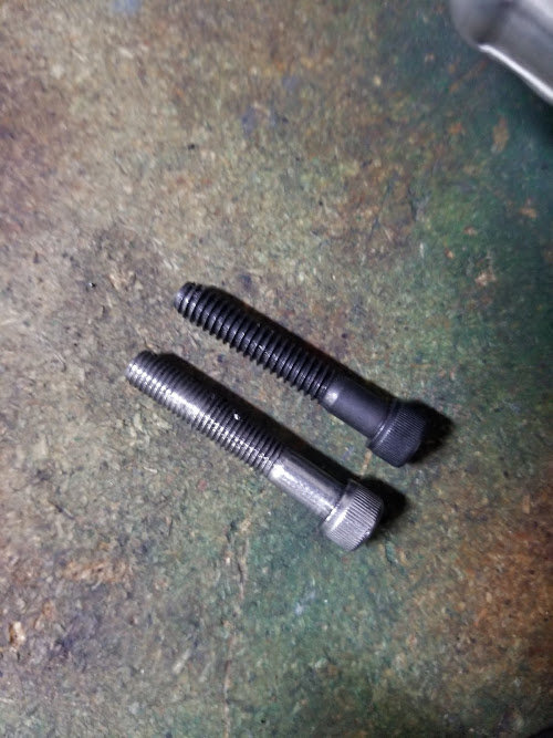

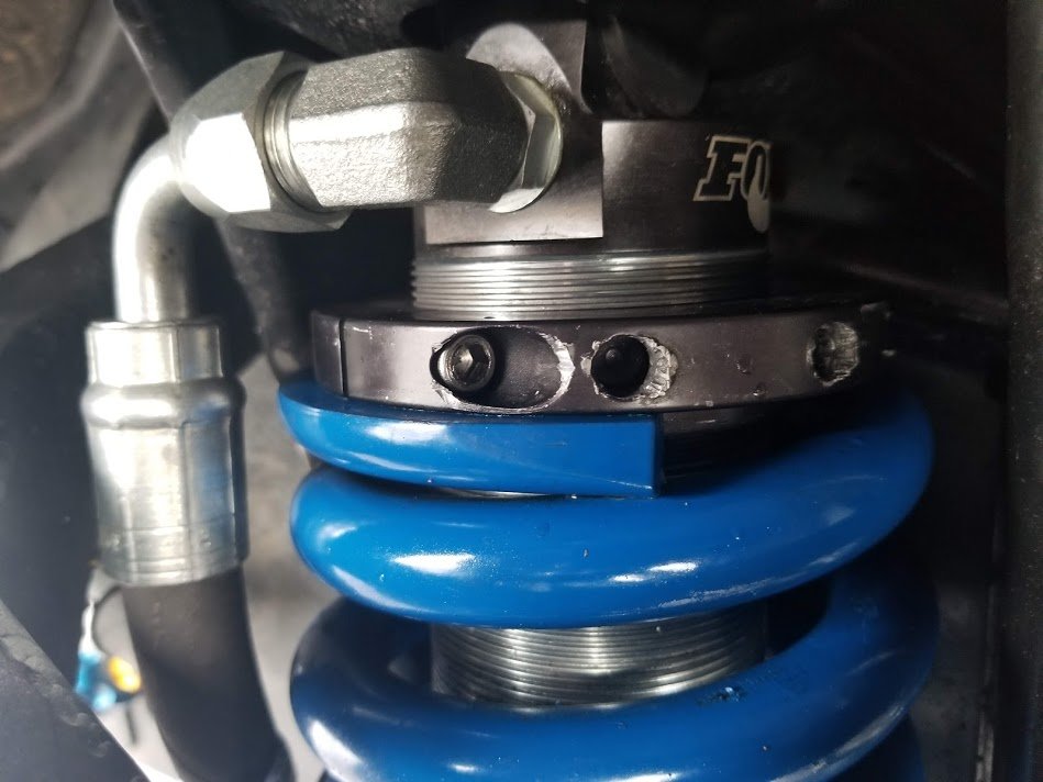

    on a different note, anyone got info on the thread/pitch and length of the allen head bolt that locks the collar? the shop that rebuilt it nearly rounded out the allen head
    6HEf2DSxZSHaJRKDRl_im-8K1MFNkTiLib9Umfi5_aa93d1e100f40ded359f76eefe79ffabeaacda2b.jpg

    I believe it's just a 1/4-20 socket cap bolt. At least if memory serves a 3/16" Allen key is what I use. I have never completely backed it out so I do not know how long it is.
    Which is important to mention, if you are adjusting your ride height with the coil overs on the truck only loosen that bolt enough so the collar can turn. Do not back it out completely, that can let the collar slip or strip the threads.

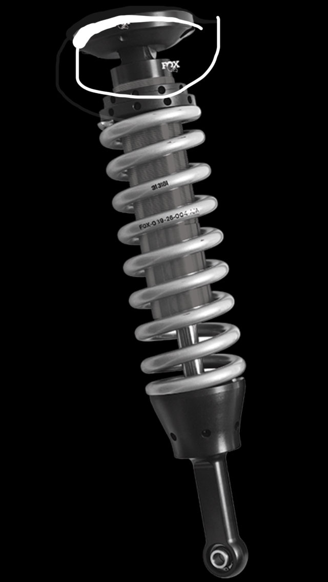

    That raised top eyelet design is unique to IFPs and increases the internal nitrogen volume. Remote Reservoir shocks have the lower top cap.

    well that 1/4-20 bolt was a no go, it needs to be much finer, it is however a 1.5" in length
    reached out to fox once again to ask for the specs of the bolt since the first time they gave me some info it was way off on what it was.
