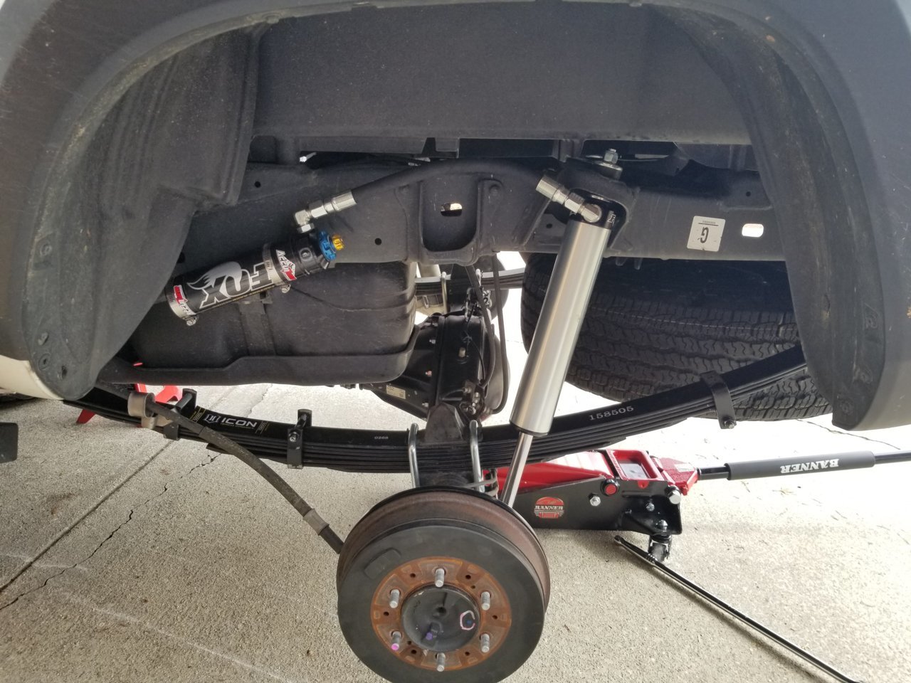

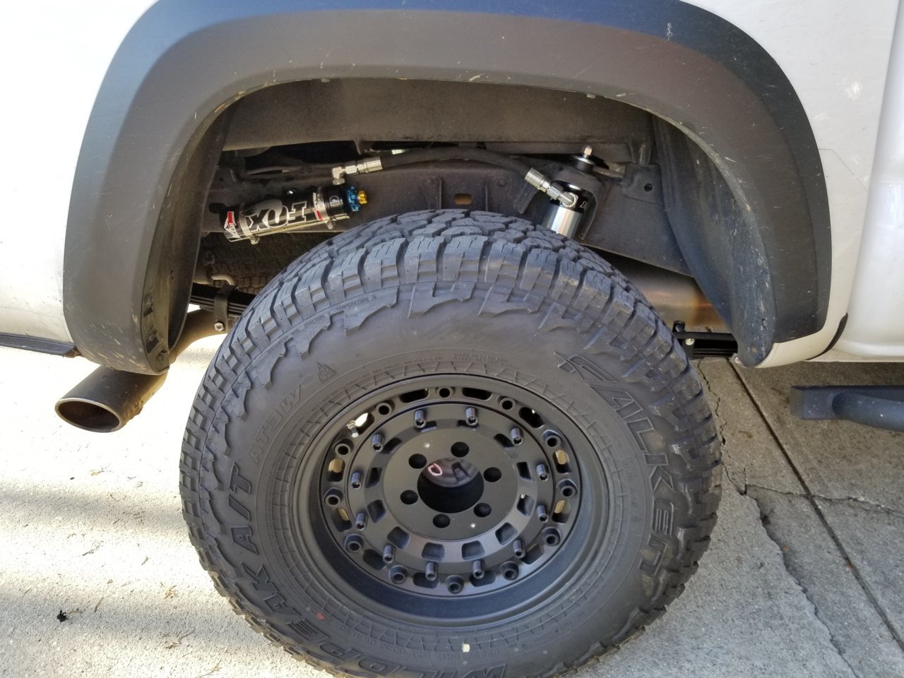

    Got my rears from Accutune installed today. Decals are upside down, but I don't think I could change that.
    Going to work on the front tomorrow, but what to set the preload to has me dizzy.
    I asked accutune to adjust it for 180 pounds of added weight to the front (steel bumper/winch/twin compressor/sliders, etc) and adjust for driver side lean, but shocks came in with 1" of threads on both. I'm a little disappointed by that since I paid $4k for the setup (including the leafs), instead of getting rebates elsewhere. Hopefully their tune really makes foregoing discounts from other places worth it.
    I'll try using a 5/16 punch and WD40 to adjust the collar.

    The 2.5 DSC with res fronts come from Fox with 16 threads exposed. It's very easy to adjust once they are on the truck. Just SLIGHTLY loosened the allen bolt and turn while the truck is up in the air. Also a word of advice....double check that the allen bolt is accessible once the shock is installed. If not loosen it in advance. Ask me how I know this.

    no more than three full turns of the allen... i believe it's a 3.5 mm allen key. the 5/16" punch is for turning the collar, you'll want no more than 27 threads driver side, 24 passenger... that's what fox says is max lift for these trucks - 1.925" of threads showing.

    I only turn the allen bolt about 1.5 or 2 turns. It doesn't take much. The 5/16 punch fits perfectly. Just make sure it is fully seated before you turn.

    I've had to turn that Allen about 4 rotations to get any movement. I also use the 5/16th punch and WD40

    he will tune them for the weight. adjusting the shock height is more something you have to do once you have it on the truck. As each truck is different. Also, they will break in and you will have to adjust them in a month or so.
    also, fox puts the decals on, not Accutune, so maybe email fox or buy a set of decals if you hate them :D I did that on a set of shocks recently too.

    Thanks, yeah I forgot to mention it on this thread, but Ryan cleared everything up.
    Truck is riding very nicely and the shocks aren't hard to adjust.
    It definitely feels smoother than the stock Pro shocks.
