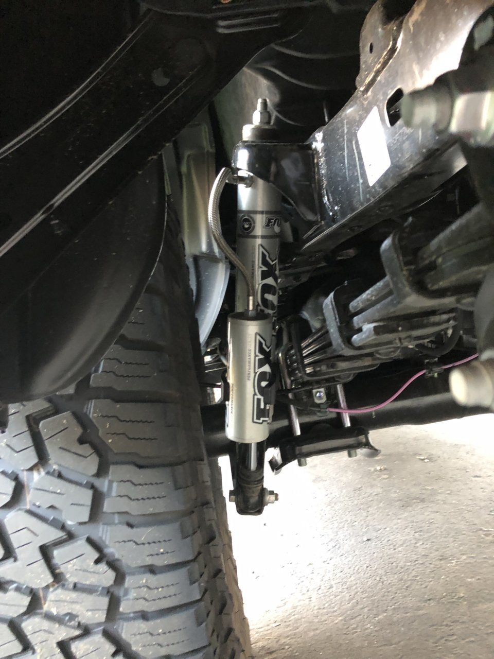

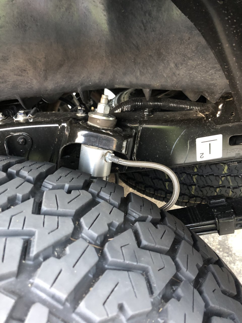

    Here is my driver side rear.. just don’t seem like I have the clearance needed

    From that picture I wouldn’t be worried at all, I have about the same clearance. The shock upper bushing is pretty stiff and should compress that much to make that an issue. If you’re worried though just turn the shock slightly towards the tire, you can leave the resi where it is but the hose will have a little more clearance.

    Alright.. just a little worried about the clearance. Also when wheeling I don’t want the line to get caught on the tire sidewall and break. Think I might be over thinking it

    The tire would have nothing to grab the line with, unless a stick was stuck in the sidewall. Then you have bigger issues.
