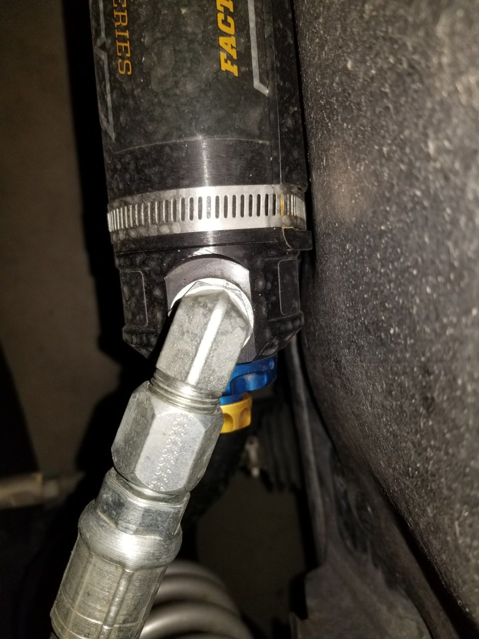

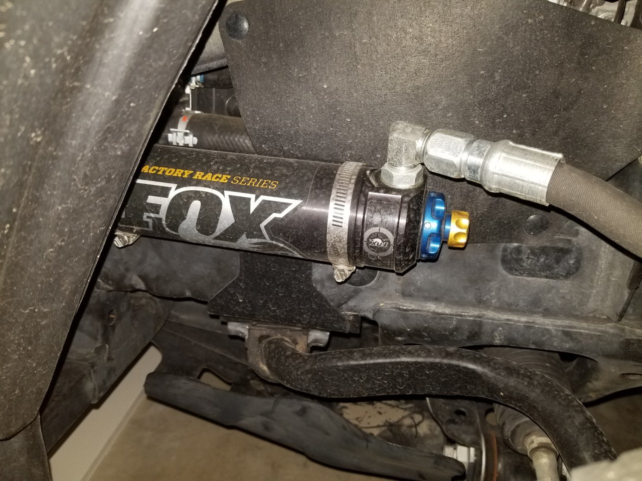

    How on earth is everyone muscling their remote resis into place? I swear to god I am twisting and pushing as hard as I can on these things and it's nowhere close to even being able to think about putting a hose clamp over it.
    I have the proper side installed, the resi is pointing in the right direction, this is a brand new kit from Accutune, 880-06-418 so absolutely no doubt the right parts in the kit. Bracket is installed in the right direction per fox instructions, everything is exactly as stated in instructions.
    So what the f**k is going on?? I had to trim a little bit of the splash guard too, because the resi is so long.

    It's tough but it helps a lot to slightly turn the fitting on the reservoir. Loosen it ever so slightly, turn about 10 or 15 degrees and then tighten it back down. It won't leak.

    I was reluctant to do that but I reckon I will have to... tomorrow. I got it mounted and mostly muscled into place but the hose clamp closest to the resi fitting won't sit down into its slot on the mount because the resi sits too far forwards. It's actually contacting the frame with the cover for the schrader valve.
    Then do it all over again on the driver's side!!!

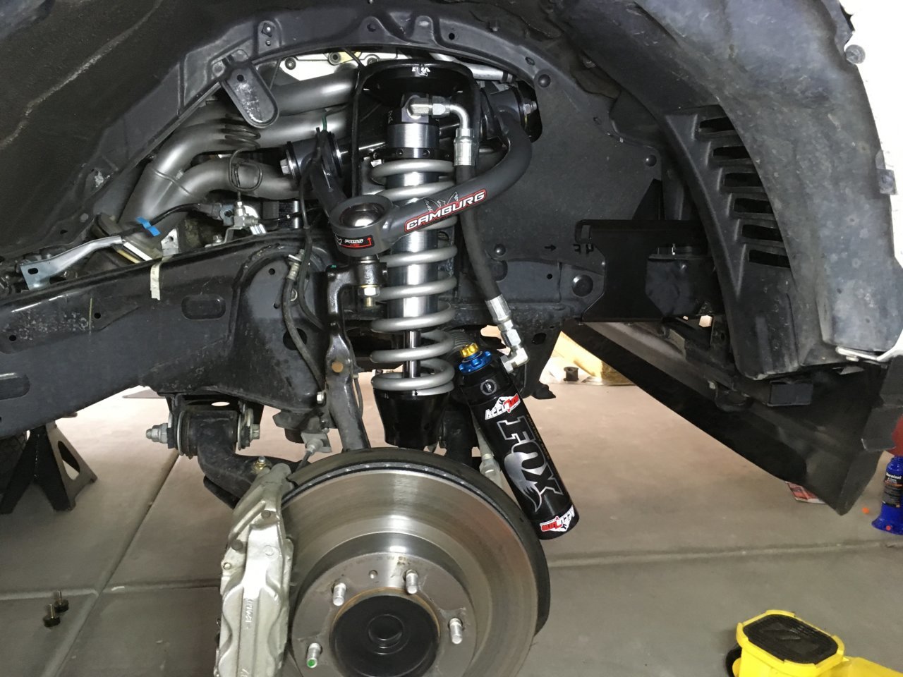

    I picked up some Fox 2.5 dsc w/ adjustable resi’s last month and finally was able to get the stock springs swapped out for 14” 650 Eibach’s. I have a group 31 battery, sliders, and before the lift installing a RCI steel front skid- Installing co’s next weekend. I had the passenger set to 1 1/2” preload and driver to 1 9/16” preload. How much lift should this give me on each side? I could never get a definitive answer from any off road shop or Fox. Thanks TW!

    Contacting the valve stem is not a good idea. I loosened the hose clamp enough to use a large screwdriver as a lever to push the resi back away from the frame.

    Yeah I got it sorted, I used a wrench as a lever but same deal. Loosen the fittings by like an 8th of a turn and it’s all gravy.

    Are you asking about preload or amount of threads showing? You’ll need at least 2” of preload (spring compressed to 12”) to get the collars on. I’m just as heavy as you and have 14” 600lb eibachs with @1.25” of threads above the collar on the passenger side and 1.5” on the driver. Gives me about 2.25” of lift over stock.

    I have 1 1/2” of threads showing on the passenger side and 1 9/16” on the driver side. With the 650lb springs will that give me more than 2.25” of lift over stock? Would make it a total 3.25” if lift??

    Your spring rate is 650, mine is 600. Not that much of a difference. Put them on and adjust if necessary. Once you have the on and have a reference height, a rough number is: 1/4” of threads = 1/2” of change in height.

    Thanks. I’m not sure if it makes a difference but the 650 springs are 14”. Stock springs are 13”

    I have 14” 600lb springs. The 2” preload number came straight from Accutune when they built them for me.
    I edited my post above since I forgot that critical piece of info.
