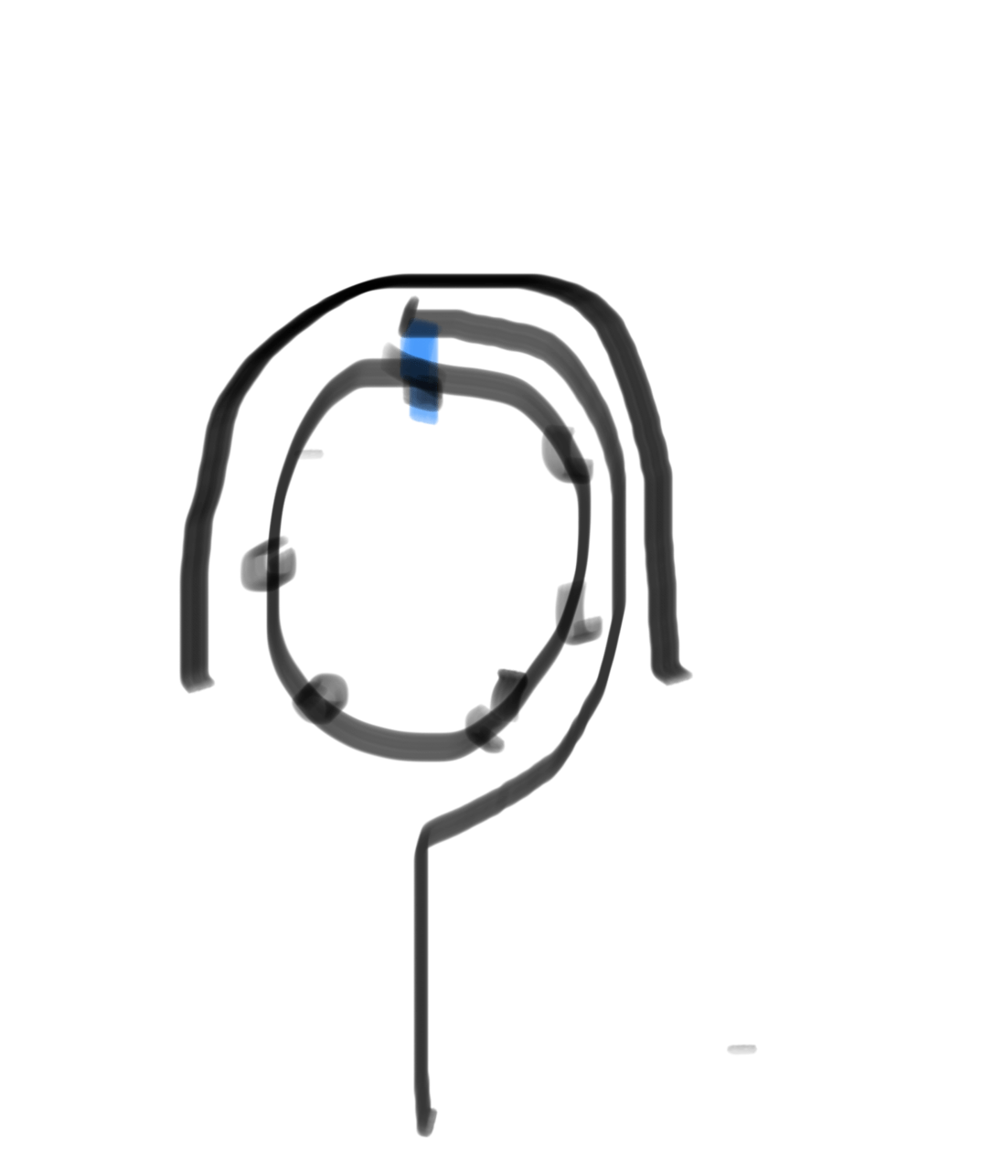

    I’m lifting my truck this weekend and was wondering if I should get a couple 5/16” or 8mm punches. Did anyone damage the holes on the ring with the punch? Which punch did you use and how effective was it? I’ve read the spanner wrench is worthless.

    So you have to understand that you’re not gonna be hammering on that punch, push it into the holes in the collar and use it to spin the collar... but yeah if you have external resis the wrench is dumb.

    Right on. I think I’m going to pick up two 5/16” punches and grind them down so they fit snug in the holes.

    Wrench works great - just shorten the stud by 1/8”.

    Could you elaborate? Sorry, I’m a few beers deep and don’t understand what you’re saying. Thank you

    Shortening the post allows the wrench to be more usable by allowing the user to engage the holes on the back side of the collar. At the standards length, you can only engage the holes that are visible.
    Sorry for the kindergarten drawing.
