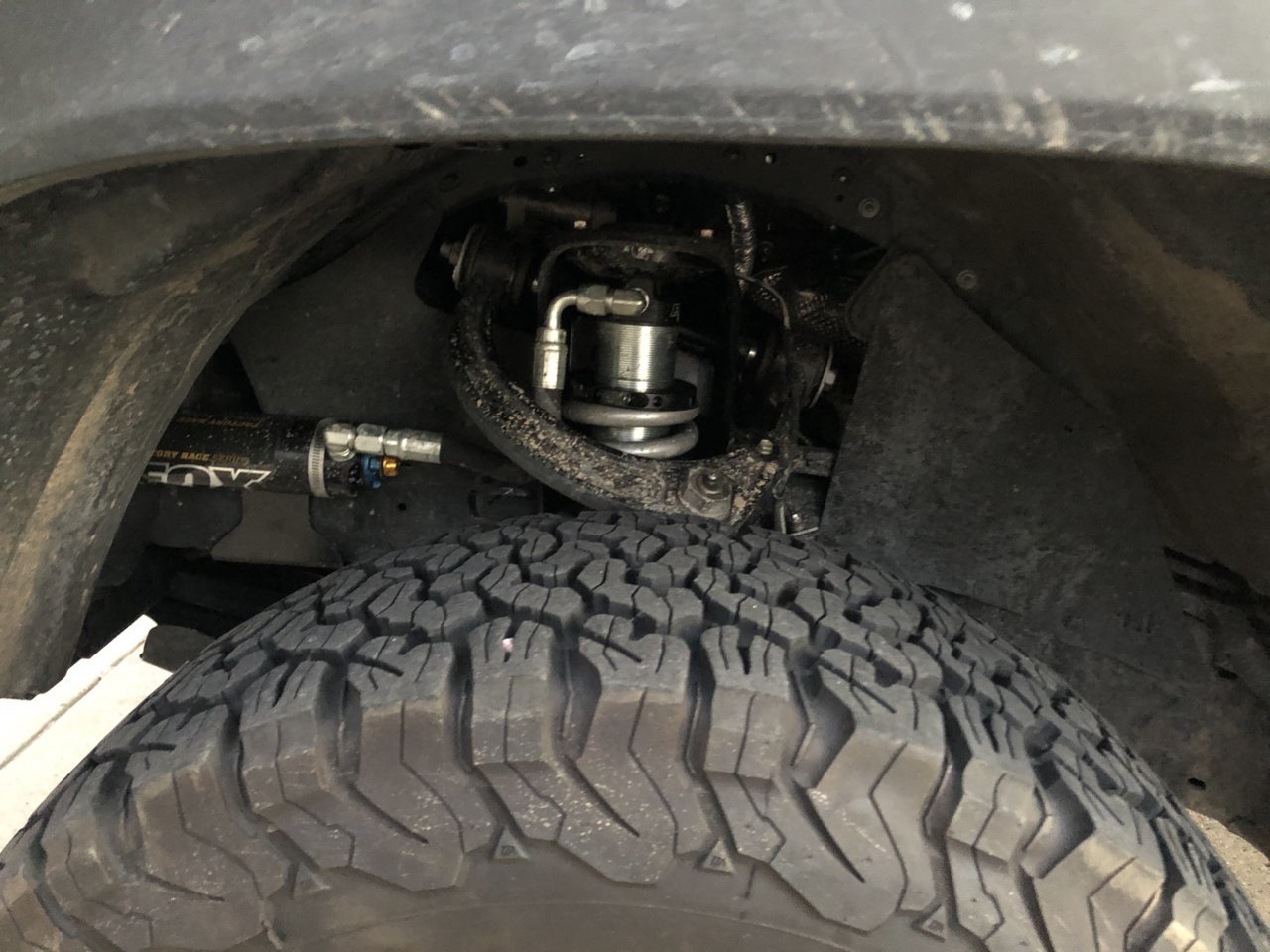

    I’d mount them on the outer sides of the frame rails, rotated 180° from the position you have them in now.
    That’s where I have mine.

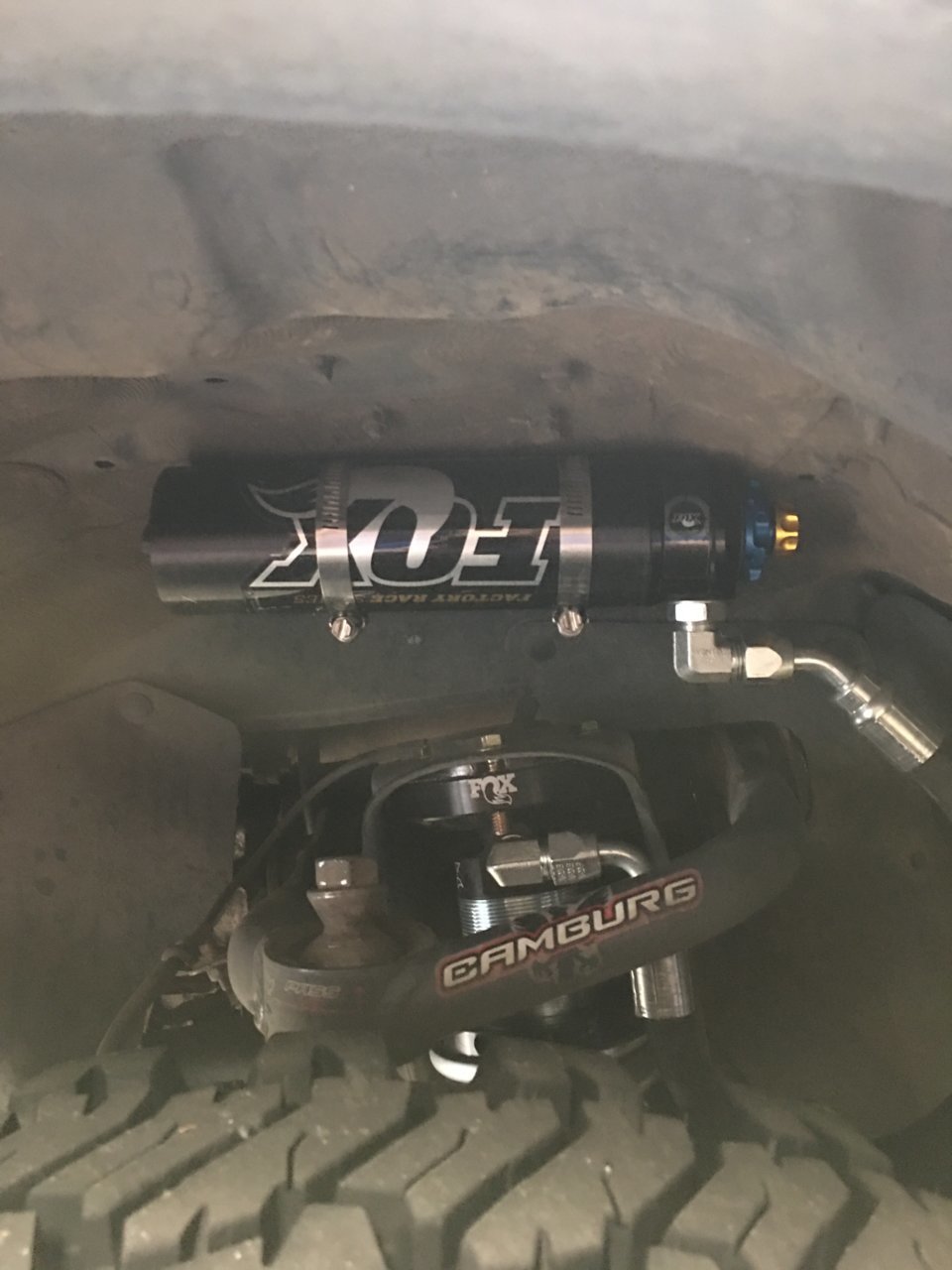

    got a photo?
    I called Fox today and sent them the photo above and stated that I wasn't able to mount the resi in the suggested location due to the resi hose would get clipped by the tires. I told them I would remount it in the suggested location, take a photo of the hose to tire ratio and then wait for a reply...

    I was finally able to install the Fox 2.5 front and rear I got last month. Front needs to come down about an 1” on each side. After myself and some friends trying we could not adjust the preload. We lubed the crap out of the coilovers and were only able to move the drivers side about a 1/4 of a turn. Anyone have luck with the spring compressors you can attach while the coilovers are on the truck? I’m not 100% sure but it looks like the collar might have jumped a thread or two on the drivers side. Not the best pictures since they were taken at night.

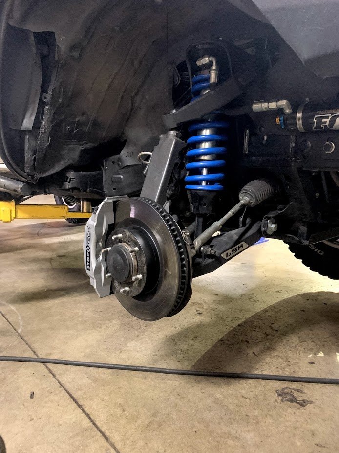

    Disc in the rear :drool:
    What was the cost of the setup?

    mounted mine on bumper/frame reinforcement brackets...thats odd that your tires would contact the hose

    Thanks @St.Germain! And yeah @PvilleJohn my rear disc conversion ran about 1200 iirc with lines, brackets, the caliper bracket, and the caliper with new pads from SOS performance. I also did theaster cylinder upgrade and to say I highly recommend it would be an understatement. You have to push REALLY hard with the stock MC to get decent braking after the conversion and the pedal will be at the floor all the time, where going with the larger Sequoia MC you have no such issues with the additional fluid movement it puts out. The MC is a no brainer at 100 for the install kit and between 75 and 160 bucks for a reman up to BNIB aisin mc, respectively.
