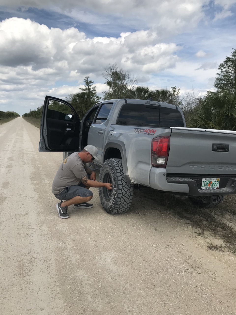

    124D2111-46A0-4F5E-B2DD-16C7F0BD9A86.jpg Yup.. gunna need a compressor.. i plan on going back here soon and I’m not driving back 40miles on the Hwy to the closest fill station at less than 20psi
