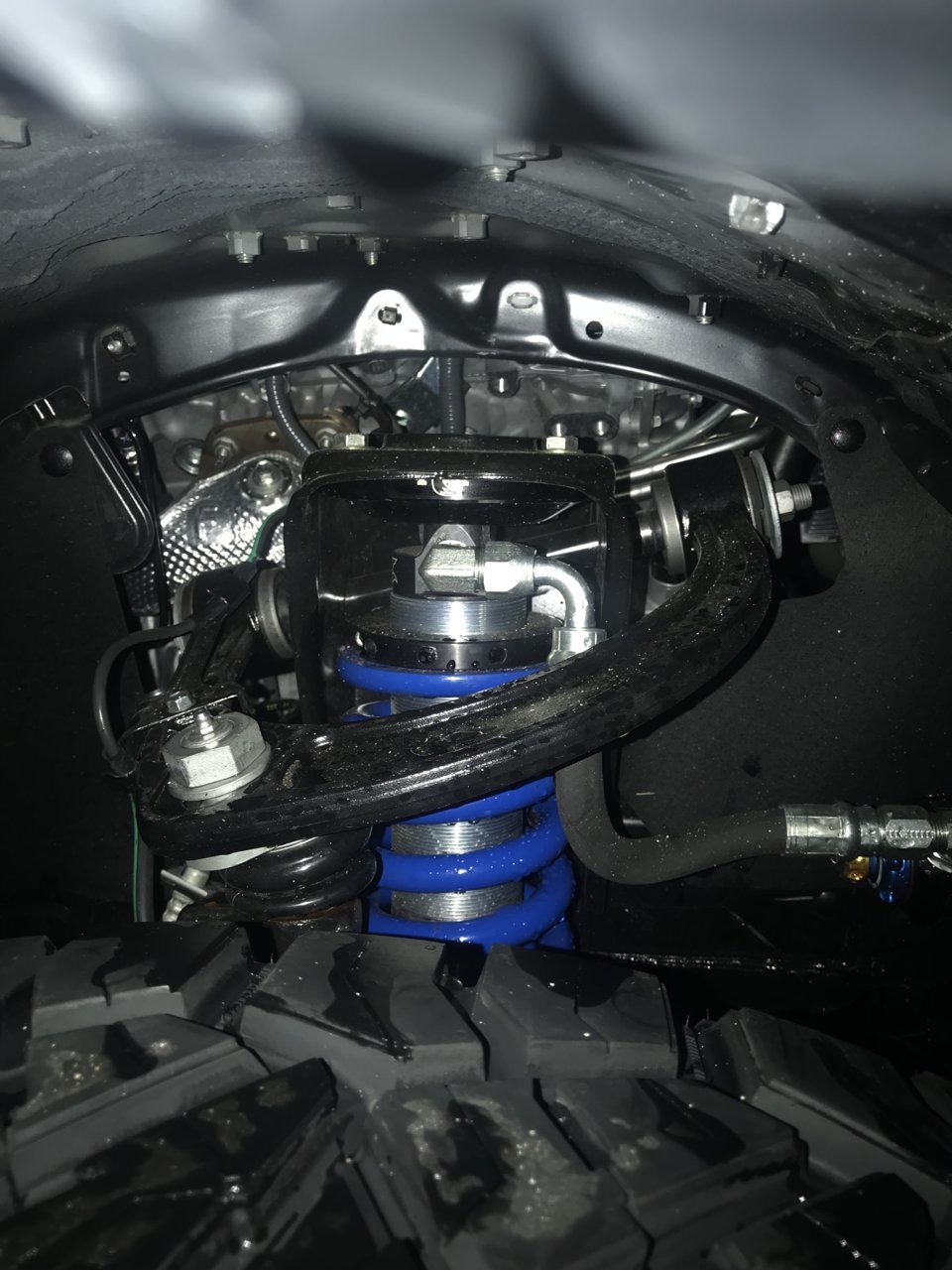

    E8A137EE-536D-4C00-8F1D-CEAED46C48F2.jpg14” 600 lb 23.5” hub to fender
    Edit: my measurements were just after install and it was a bit higher than 23.5” i haven’t taken any recently to see how much it settled

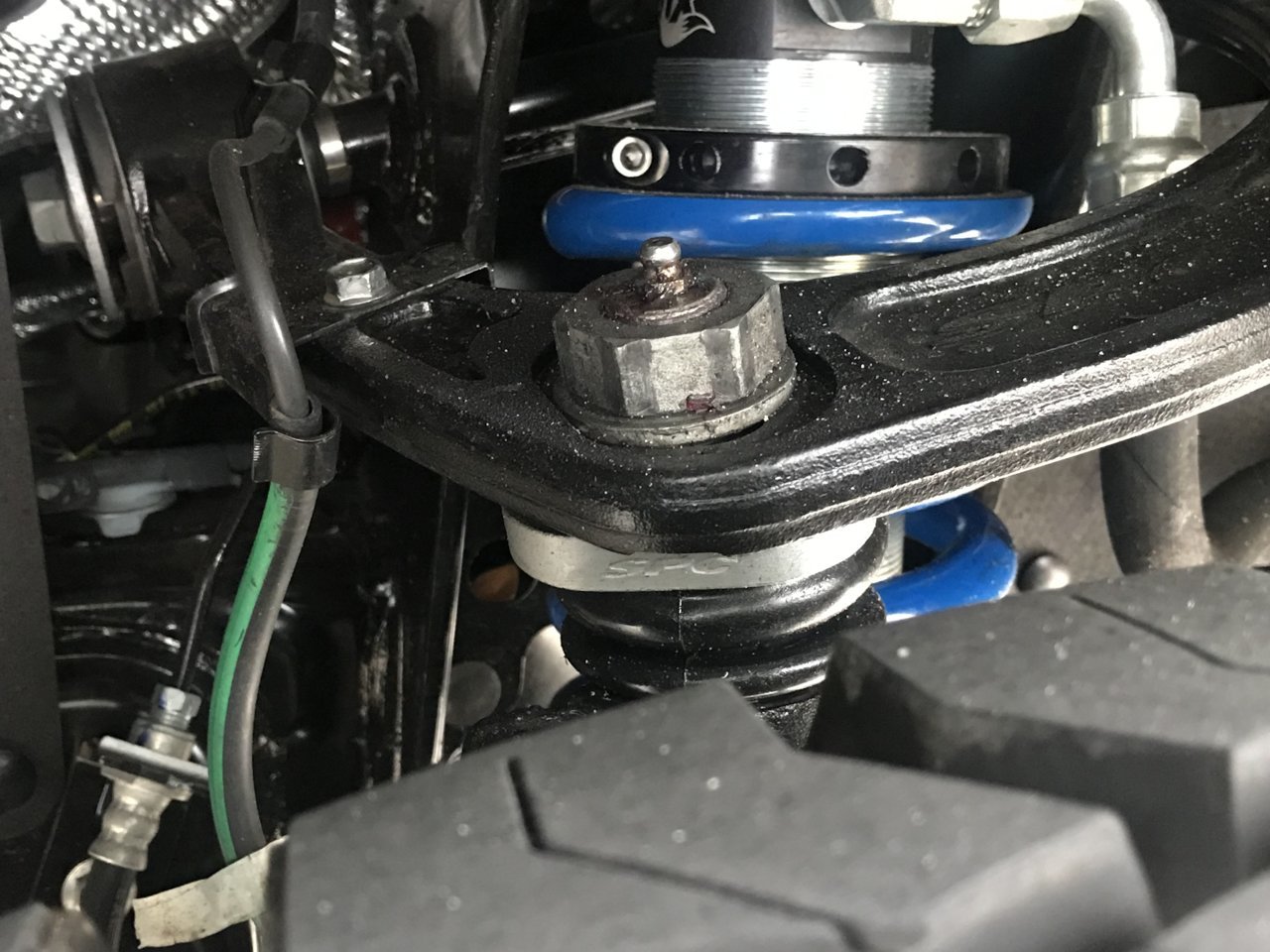

    Wow!! I’m surprised you have any down travel.. 556272CB-A979-47B0-9C8E-84430A8895C9.jpg14” 600lb 23.5” hub to fender 2.5” up 3rd gen

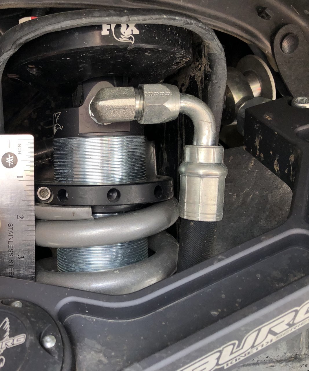

    FOX 2.5 Factory Coilovers w/resi DSC @fox ———————————————- Camburg Kinetik Series Upper Billet Control Arms @camburgracing ——————————————— FOX 2.5 Factory Shocks w/resi DSC @fox ——————————————— Icon Vehicle Dynamics AAL @ivdsuspension ——————————————— Baja Designs Squadron-R amber fog light kit @bajadesignsofficial ——————————————— RCI Bed Rack @rcioffroad ——————————————— Tepui KUKENAM 4 XL Ruggedized @tepui
    @*TRD*
    You’ve probably explained a few times, but can you elaborate? Reason I went with a 650 was to future proof for skids/bumper/winch. Did my installers just not set everything correctly?
    a whole 1/2" :frusty:

    That’s ok I’ll switch springs with ya!! I’m going to add a bumper and a winch soon!! 650lb will probably be needed. I have the stock 13” 600lb springs too. Lemme know

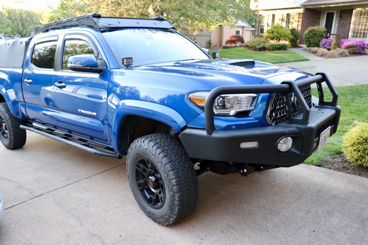

    Installed the ARB bumper and 14" 600 pound springs over the weekend of my 2.5 ext travel Foxes. I think they are settled with 2" on threads of showing (about 2 and 1/4 on the drivers side). The hub to fender is at 23" so about a 2.5 inch lift with stupid heavy ARB Summit series bar. The ride is like floating on a cloud @AccuTune Offroad was correct on the 600 pound spring setup. I'll take some photos later today.

    Here is your photo rides great hub to fender measures 23" so a 2.5" lift.

    21” is stock on 3rd gen so your about 2” up which is perfect.. did you add a winch to the bumper too?? And do you know by chance how much that ARB weighs?? It’s good to know you can use 600lb springs w a bumper

    My premeasurement was 20.5". the 600 pound spring works but its a 14", not a 13" that comes with the 2.5 extended travel setup. I think the bumper weights about 180 lbs., the shipping weight was 220lbs. :notsure:
