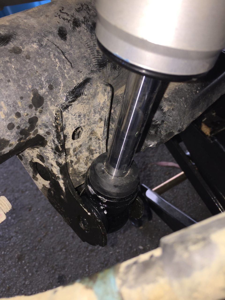

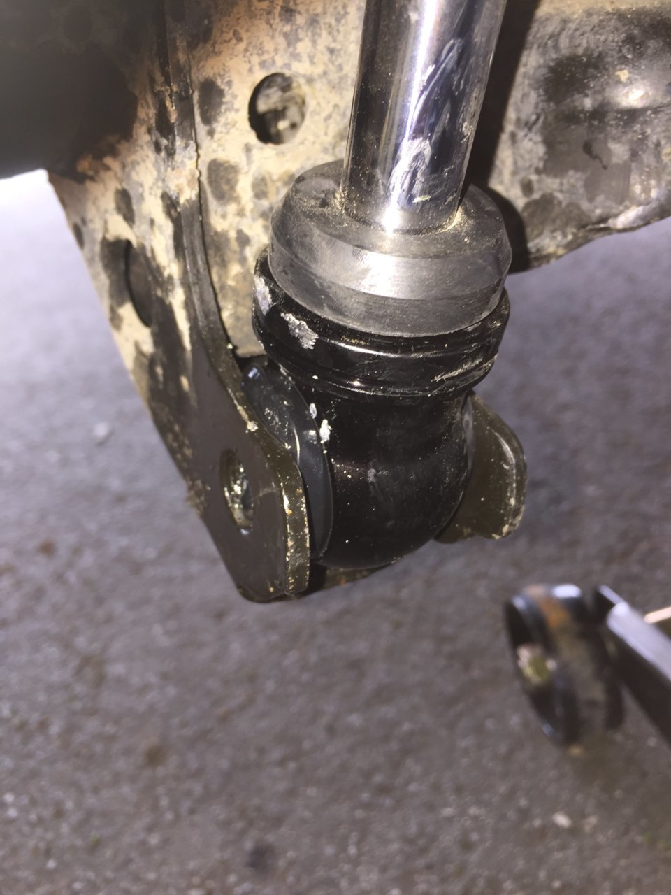

    I had the same issue. Should have been easy peazy. 2 bolts, nothing else to unbolt or move out of the way, and no jack needed (you don't have to remove the tire but can to make more room) but that bushing is not right. It's just too wide. Made it a real PITA to get the holes to line up.

    I cussed the lower rear shock mounts too when installing my 2.0 rears the other weekend.

    Yes. Normally it comes with a 1.32" bushing and a 1.4" sleeve. We swap in a 1.25" sleeve. You shouldn't have any issues.
